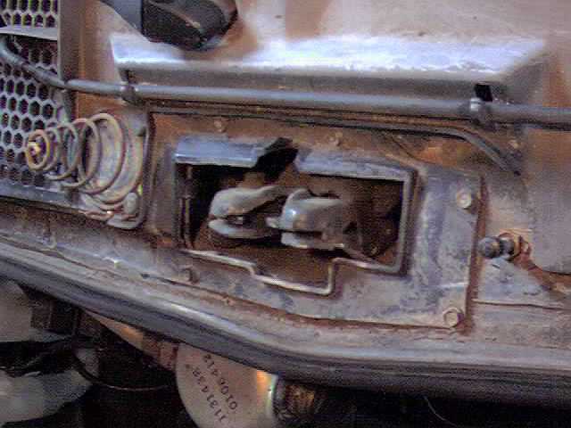

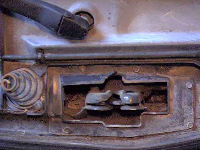

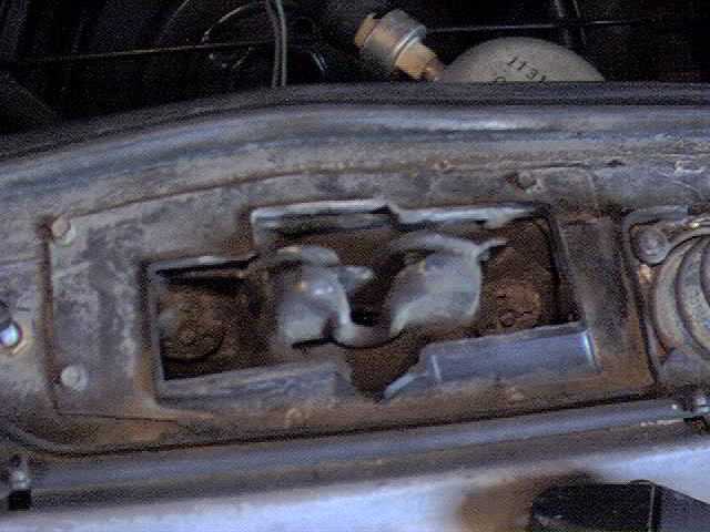

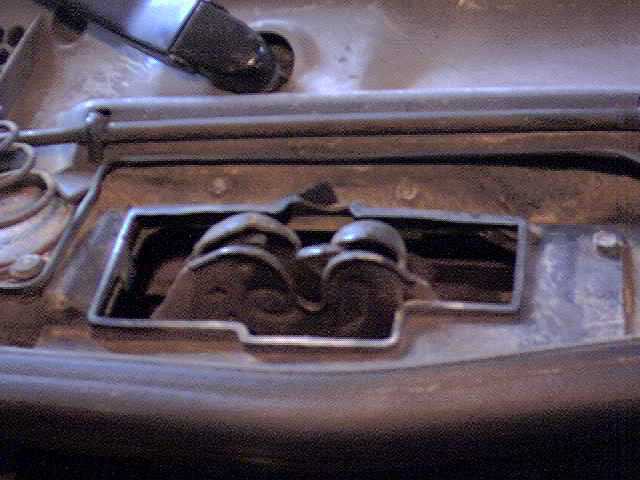

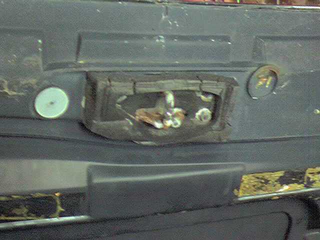

Report this Post03-01-2001 12:58 PM Click Here to See the Profile for SteveJSend a Private Message to SteveJDirect Link to This Post
There is rubber foam surrounding the latch. There are two 10mm nuts holding the latch on, one of which is obstructed by the foam in this picture. Its on the left and a bit diagonal. Shred away the foam and unscrew the two nuts? A 10mm wrench straight in to turn 'em off. I say removal of these two bolts makes the latch drop off but I have never done it. maybe someone else here on the forum has removed them and can say for sure.
This second picture which absolutly refuses to upload shows the two 10mm bolts inside the trunk area that hold the lock mechanism in place.
this must be the bolt theogre is talking about down in there and it is 10mm I measured it. The small bolts holding on the plastic surround look like 7mm and no reason to remove 'em.
Here is another view of the 10mm bolt down there and a good shot of the plastic facia near the windshield that theogre says may need to be cut out a bit.

OK I see that way too. That number two picture that didn't come out of the two bolts in the trunk that hold the latch on. Broom handle with universal on the end and a 10mm socket.
I'd still shred that foam and go at the latch nuts first though. Its a straight reach in with a wrench if you have small hands or a long wrench.
