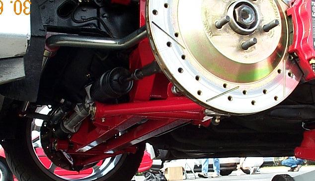

That Held suspension is the Bomb! I just had to post a pic of it.

Here are the pics I promised, sorry so small.

My Held suspension is black and doesn't show up in photographs very well. However I like the rotors? Wilwoods?

Hey man, Power steering still not needed over here (at least with 215/45/17 fronts, we'll see what the 225/40/18s do to my arms
I think the 88s are also a little easier to turn.
Anyway, the brakes in that pic are by Held too.
If you're still running the stock (eek) brakes on your car, I'd *highly* recomend these when you put the cammed N* in
They are a very well thought out kit, I'd be using them on my car actually, but I went to a 5x130mm bolt pattern and want to retain as many 'OE' components as I can (even if they're not all from the same 'OE'
PS: get Held's drop spindles too (which I think you have if you have the sallom front end?) they use the slightly biger (and still made) 88 REAR bearings on the FRONT of the car. Good stuff for bigger rubbers.

rockcrwl, I don't see the coolant tube there (or is it). Is there any interference when the tube and hose are in place? TIA

The pics I posted are not of my car, It is a Diablo replica being built by John Bell. I'm not sure, but I don't think the coolant tube would be a problem. I started setting up a Corvette rack on a spare crossmember. The Corvette rack has the same dimensional problems as the Chevette, but at least the shaft is the same spline as the Fiero. I have since bought a ZF rack from a Merkur. The Merkur rack will need some adapter brackets to mount and the shaft is way different, but the dimensions that really matter are correct. The complete Fiero tie rods will thread right on using M14x1.25 threadstock.
The Chevette or Corvette racks would work fine if the tie rods are extended where they thread into the rack. Extending the outer ends is not the correct way to lengthen it. I haven't looked at what would be required to do it correctly. The Chevette rack is easier to mount, but the Corvette rack can use the Fiero U-joint(shaft still needs to be shortened). Take your pick.
