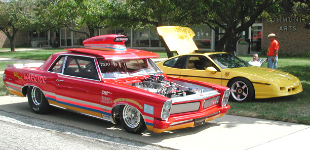

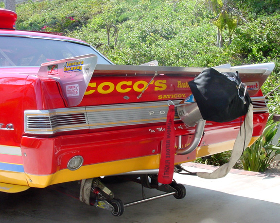

Maybe someone can come up with a real trick setup, but I don't think there's going to be much Fiero left in it. Just my opinion, it's going to take a whole lot of money, or it just isn't going to last very long.
You want to talk about friends fast cars....Here's my cousins GTO (not much GTO left in it), runs 8.8 @ 150mph on injected alcohol. Engine alone costs $20,000, prior to this new engine the car was running 9.97 with a $13,000 dollar engine. The under structure is all alum, steel body twice acid dipped with thin fiberglass fenders, and trunk lid. There's about $55,000 invested into that car and it's just good for one thing.

It's a "Classed" Bracket Racer that doesn't run full out, the car will run quicker, but not as consistantly. In it's current form and setting his last five runs were each 8.81 with the fifth run being an 8.80. It will do these runs repeatedly without breaking parts which keeps the operating expense minimized and more rewarding. The only thing that beats you with this car is yourself, by catching a bad light. Just added to chute (required at the 150mph mark), so he feels comfortable reducing the dial in time, engine puts out 900hp.
