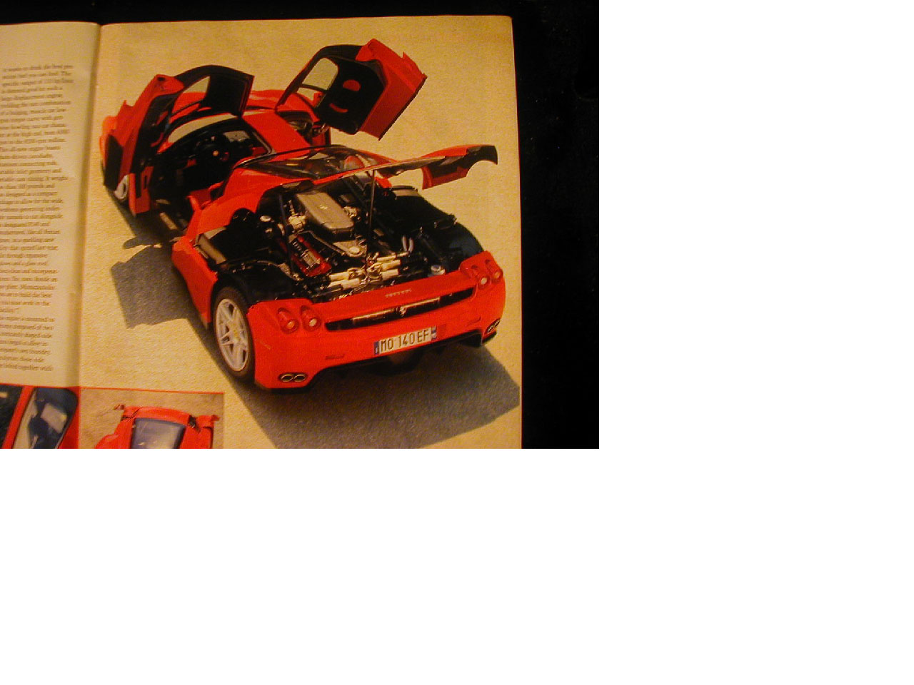

With all the posts on raw power, I thought I'd ask something a little more finesse oriented?
Well, the new Enzo Ferrari turns 1.3+G on *street tyres* from the factory...
How do we beat it?
Best! Ben

Originally posted by Will: Where did you find the 1.3G number?
The 8/12 Autoweek article says that the number is 1.36 on a 400 meter skidpad.
Quote by Leper Steal the suspension design and knock 1000lbs off the weight. Actually the weight of the Enzo is almost 500 pounds heasvier than the Fiero at 3006#.
The tire sizes are 245/35ZR-19 frt and 345/35ZR-19 rear. The The cars' front and rear air tunnels, full length body pan, active rear spoiler all aid in generating a aero load of 990 pounds downforce (twice that of an F50) at 135 mph.
The engine is great at 660hp @7800 rpm and 485 lb-ft @ 5800 rpm and weighs less than 500 pounds.
None of this is unachievable, Ben. Particularly when you consider that you can go buy an 88 Coupe for say a $1000 and still have $669,000 left over to play with.
Why does the ultimate sports car keep getting heavier? Ferrari will never build anything to beat the McLaren if they don't keep the weight down to 2500lbs or so.
