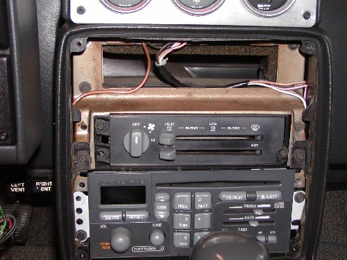

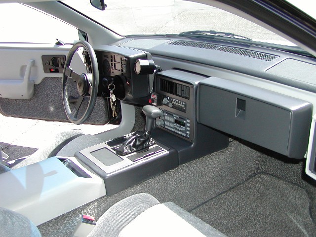

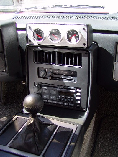

Here's some shots of a late model Grand Am CD player installed:
Here's an older CD player out of a Bonneville in my other car:
Best of luck,
Hartz

kslish
Posts: 1478
From: Womelsdorf, PA
Registered: Apr 2000
Report this Post10-22-2002 04:30 PM Click Here to See the Profile for kslishSend a Private Message to kslishDirect Link to This Post
Not to hijack this thread, but did you make that 3 guage aux. guage pod front plate yourself? Been thinking about doing that for a while and was wondering how you did it and what material you used.
Ken S.
Pyrthian
Posts: 29569
From: Detroit, MI
Total ratings: 342
Report this Post10-22-2002 04:34 PM Click Here to See the Profile for PyrthianSend a Private Message to PyrthianDirect Link to This Post
looks like the GT guage box with AutoMeter Guages installed.

seeing as everyone is highjacking...is that a dvance/retard knob i see in the last pic? We should get together sometime...or you can help me with teh 3.4 swap! hahaha

LOL. OK, lemme see if I can get these replies straight!
kslish: Pyrthian is correct. It's a GT aux gauge pod with a sheet metal front, and three Autometer gauges stuck in it.
Fieroman: Yes, that is the ignition retard from my MSD box. It adjusts ignition per pound of boost from the turbo. Kind of a poor substitute for a programmable ECU, but it works OK. If you ever want to get together for some beers and Fiero BS, give a shout - I'm up for it.

Here is my cd 'swap'. It's from a 1992 Grand Am..
I've got this "thing" for a stock look... So I grabbed a Pontiac CD player.. It lights up the same orange color as the rest of the dash..
It Fits right in.. Most people can't tell it isn't factory.
[This message has been edited by Poncho Jim (edited 10-25-2002).]
