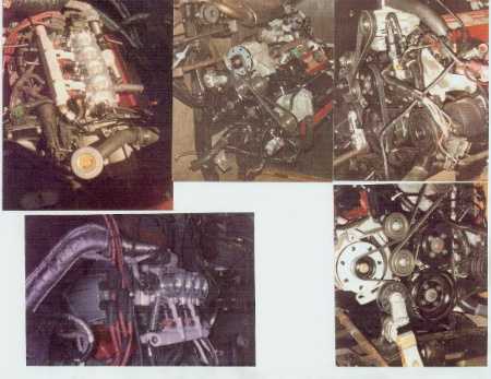

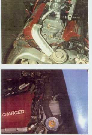

I got a E-mail back today from http://www.fageolsuperchargers.com/ They said they produced kits in the 80's for Pontiac based off their S-10 kit. They are were working on a few kits for resale again. They don't have the pricing yet. The nice thing is you won't lose your A/C. So they will keep me informed on when the kits will be ready for the 2.8,3.1,3.4 engines.
Here are some pics they sent me.
Kinda hard to see, but I think everyone gets the idea.
Earl R.
Am I seeing 2 different things (SC kits)?
In one pic, it looks like an intake mounted SC with fuel rails for injectors.
In another, I see what looks like a SC down where the AC would be on a Fiero.
FieroGT87
Posts: 3195
From: St. Louis, Mo, USA
Total ratings: 87
Report this Post11-29-2002 04:00 PM Click Here to See the Profile for FieroGT87Send a Private Message to FieroGT87Direct Link to This Post
FieroSound,
NO, The S/C for the 2.8, 3.1, 3.4 is a top mount like the S/C on the 3.8 engines.
A couple of pictures are sideways. If you look closer you'll those are Fiero Cradles those engines are sitting on.
Earl R.
