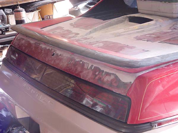

Here's how I did mine:
Removed all the studs. Made a paper pattern of the studs' locations and taped that on to the wing. Set the wing on the deck and moved it around so that it looked good, measured distance from the front part to the edge of the deck (3 inches, I think), and that the "seam" on the wing lined up with the edge of the deck. Taped the pattern in place. Put 10-24 machine screws about 2 inches long in the stud holes and cut off their heads, making sure the threads were still good (I ran a nut onto the screw before putting it in the hole). Drilled holes in the right places in the pattern. The 2 front studs don't go through any braces, but all the rest did, so I had to drill large enough holes in the bottom of the brace to insert the stock washer/nut combinations. That's about it!
I mounted mine farther to the rear than BatBoy, almost flush with the rearmost part of the deck... I liked the swoopy look with it in that position.
Hope that helped/Chris

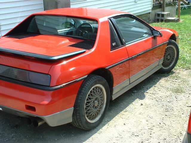

Report this Post04-16-2003 04:44 PM Click Here to See the Profile for 87FieroGTxClick Here to visit 87FieroGTx's HomePageSend a Private Message to 87FieroGTxDirect Link to This Post
I love mine but only have this bad pic of it
Wow, my car was fugly back then. Hehe

Report this Post04-16-2003 04:46 PM Click Here to See the Profile for 87FieroGTxClick Here to visit 87FieroGTx's HomePageSend a Private Message to 87FieroGTxDirect Link to This Post
87FieroGTx
2630 posts
Member since Jun 2001
You can't see it in the pic but the inside of the wing is red and the outside edge is black.

Report this Post04-16-2003 08:55 PM Click Here to See the Profile for exspookSend a Private Message to exspookDirect Link to This Post

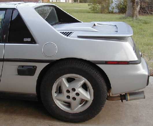

Okay, in the interest of helping out I'll post some pics, but you guys are making me "tip my hand" about the not-yet-famous-exspook notchback!
Hope this helps/Chris

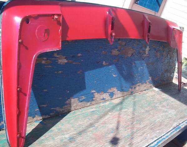

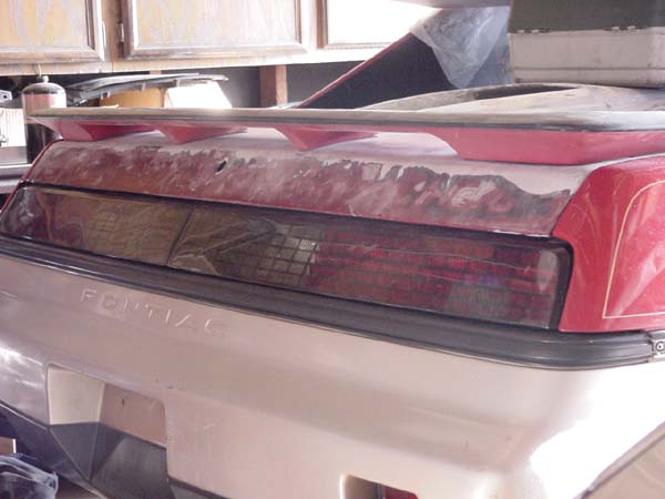

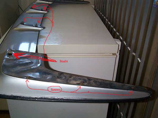

OK, I got the spoiler, it's a beauty, silver with the black strip soon to be red.
Now for the question, the rear corners have a stud each, the uprights have two studs each and the outer edges have three screws per side. Can I use all of these? BATBOY (or anyone) do you have any photos of the bottom of the decklid showing where the nuts and screws end up?
It will be a while before I get to mount it, still very cold up here (0 degrees celsius today, -10 last night) so I can't get at it for a while.

Report this Post04-18-2003 01:32 PM Click Here to See the Profile for Monza76Click Here to visit Monza76's HomePageSend a Private Message to Monza76Direct Link to This Post

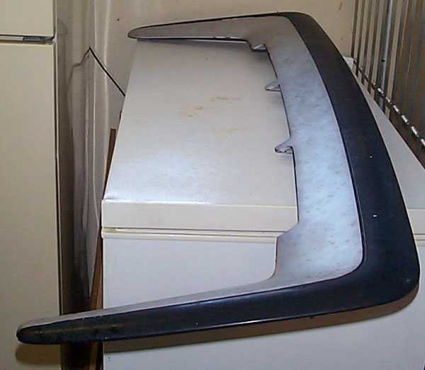

Here are a couple of pictures:
and this one of the top (the paint is awful but there are no chips or dents):
Thanks
Ira

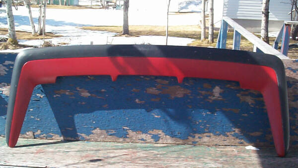

Report this Post04-24-2003 09:28 AM Click Here to See the Profile for Monza76Click Here to visit Monza76's HomePageSend a Private Message to Monza76Direct Link to This Post

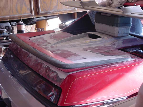

Here are some pictures now that I have the red paint done, the black will have to wait until I can put masking tape on the red.
Top view:
Bottom section (BTW I have the gaskets and will uses a little sealer around the screws and studs):
Next step is some very careful measuring and drilling.
Any special considerations when drilling in the fiberglass reinforced plastic of the rear deck?
Ira

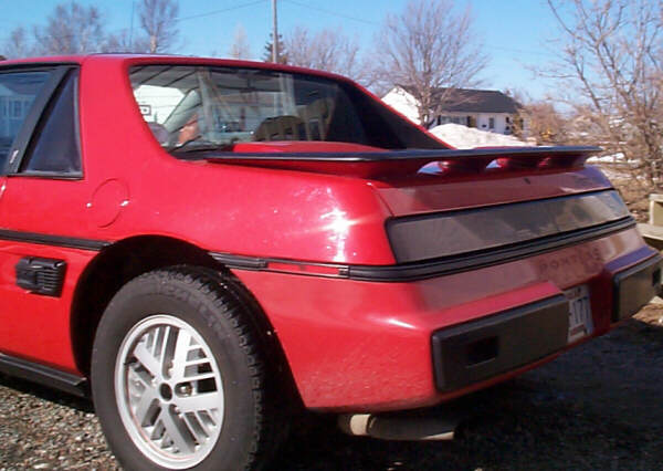

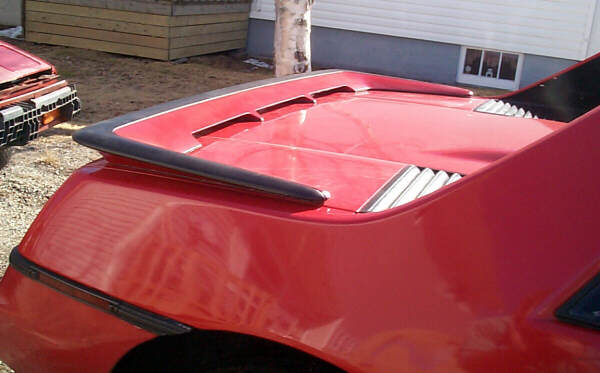

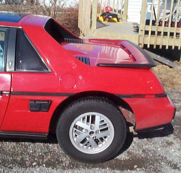

Done, Job done!
Here are some pictures of the final product:
here is the side view:
And finally a view looking rearward.
It looks great however, I don't know if I mounted it too far forward or too far back but it did not conform well with the curve of the rear deck. Any suggestions?

Hey Ira , Lookin Good ! As far as if the spoiler is to far forward or to the rear , only a wind tunnel will tell you that . It looks good ! What more do you want ?
I'm impressed with the look , I like your two tone spoiler much better than the mono paint spoilers that I've seen of the same make .
If you've got the part # on the spay can of paint you used I can cross reference here in the States . Thanks .
P.S. Did you ever install a rear sway bar ????

fierogsmith
The label reads:
47-3592-2
GM 82-91 72
BRIGHT RED
ESCARLATE
Last line is just the French I believe, everything here is bilingual. BTW you will need at least three cans, many coats needed to get a good finish, I will have to remove mine later this summer and paint it again since I only had two cans, it could use two or three more coats for a nice finish. A coat of clear may also help.
No I haven't installed a rear sway bar, I have my alignment set with nearly 2 degrees of negative camber in the rear and pretty much stock settings in the rear. In low speed turns I get no noticeble understeer and just a little throttle and it just digs in and goes. I am not a fan of putting too much roll stiffness at the rear because of the unforgiving nature of oversteer, I like the margin of error afforded by understeer.
My next project is a vented hood (hood with hole cut is resting on my patio right now). I am going for the "Warber" style that Archie used on the Stinger.
BTW there are lots of articles on handling at my web site (see the signature below for the link).
Good luck with your project.

Hello Ira
This post seems to be to late now, but it seems you found out that it does not match the excact shape of the deck lid. I found this out when I installed mine, the worst part on mine seemed to be the small pedestals in the center of the wing. If I remember right they have more of a curve then the deck lid. So before I mounted mine I reshaped the bottom of the spoiler. I did this by sanding until I had the the same contour has the deck lid. Most of this was done on those pedastals and the very far outside coners of the wing. But once I was done it has a very nice fit. You might be able to go back and do this if you want. Looks good though
