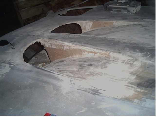

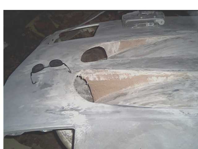

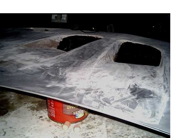

Smoooooth GT, I was designing a similar vent for my hood, but one opening instead of two, BTW Really like yours, very F-50'ish. Would you be so kind as to take and post a pic or two of the inside of your front compartment? I'm wondering how much of the front wall needs to be removed.

hey smooth, love the hood, just one question though, did you have to cut out the entire opening, then fabricate the "scoops", or did you just make the cuts,and the force the hood into the shape you wanted. thanks for any advice on how to make this.
dan
#2.. I forced that sucker to where I felt I wanted it!
As far as advice... A few ?'s first.. Have you ever done any fiberglass work before..?? hehe
