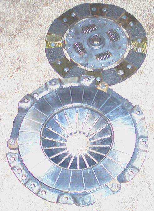

Has anyone tried the 6-button EZ Lock Pro? The Centerforce didn't hold. I am going to order this disk and use the cf pressure plate.(less than 1500mi on cf)

Dale, I am running the same disc in my turbo 3.4l DOHC. It is great. With my current boost level (14 psi), the clutch is holding almost 400 lb-ft of torque. I have roughly 10k miles on the clutch with no hints of trouble. You can slip the clutch a bit and I drive it almost every day. I am using a stock pressure plate with it. I do suggest you have your flywheel resurfaced and make sure your pressure plate isn't heat checked or glazed. I think you will be pleased with this clutch.

Thanks for the info. I modified my pressure plate and was just going to put the car back together with the cf dual friction disk---But--- if it starts slipping around 5800rpm again, it will just p..s me off again. I talked to Centerforce and they said they could make a custom disk with the kevlar? pucks on both sides for a 10% gain in grip. I also asked about a pressure plate with the centrifical weights, since I am running the Isuzu trans.(more room inside bell housing) They said this would add about 10% also...That is when I knew I was done with Centerforce. 20% gain in grip and I still want to bottle feed the engine in the neer future.

Installed it 2 days ago and have been taking it easy on it. Is there a recommended break-in period for this metalic disk like my Centerforce had?

So far, so good. No upper rpm slipping. However, when power shifting, it slips for about 1 sec.
