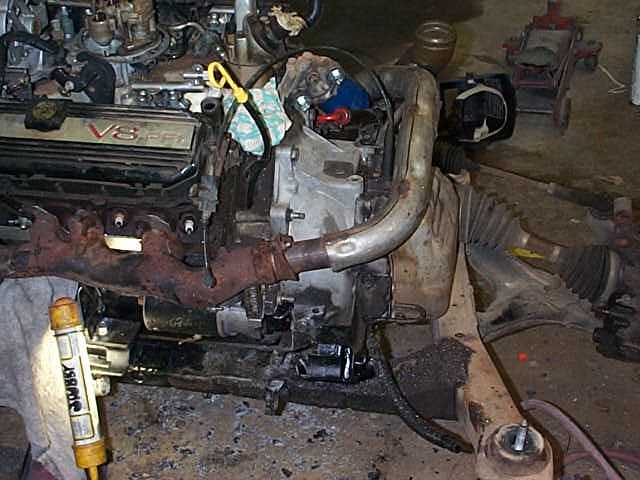

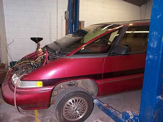

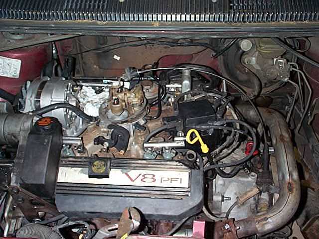

Okay, maybe this is not completly Fiero related, but it is because of the Fiero engine swaps that I did this project. I found a '91 Olds Silhouette van for $400 with a bad engine. Later, I found a Caddy 4.5 with about 90,000 miles for $200. Well, the pictures tell the story:
The Van-
Notching the bell housing-
The new home:
I used Dodge truck motor mounts on the front and rear of the engine, but it still needs a dog bone. The fit is very tight around the belt and A/C compresser. I had to have a power steering hose made up and the exhaust needs to be done. How about a set of duals run out the back? I still have some issues to work out- the valve train is very noisy and the transmission shifts late. But I did drive it around the lot and it is going to be a van that us guys can be proud of!
Thanks to Terry and Jon- I could not have done this without your wealth of knowledge.

All in all, everything went fairly well. I only had to 'bless' it 3 or 4 times. I started work pulling the old engine Tuesday morning and had the cradle out that afternoon. Wednesday was spent trying to make an A/C mount that would fit the Olds compressor to the Caddy engine. Thursday was all about motor mounts. Friday was finishing up the mounts and fitting the engine in the van and today was getting it to run. I could not go too far because the cooling fan will not fit any more and the alternator was not putting out anything. I am going to change oil again tomorrow and see if the lifters will quiet down some (I hope so!) and rig a fan so I can bring it home to finish the detail work.
Driving impression? Even with the crappy exhaust leaking and poor tune in the computer, it is very responsive. I could not test the acceleration too much because the engine wanted to join me in front seat whenever I pushed hard on the loud pedal. The bad thing is that this month's funding for the project is already spent, so it will not get too many new parts for a few more weeks.

Question: I thought only the 4.9L had PFI on the valve covers? I saw the TBI there.
The last year 4.5s ('90) were PFI.

Well, bad news
The valve train noise turned out to be a broken lifter on #5 exhaust and the rocker bolt on #5 intake is stripped. Looks like the intake will have to come off to make some repairs. There is a junk yard down the road with a couple of busted engines like this that I can rob the parts from, but my 'real' job starts tomorrow and time has run out on the summer projects.
