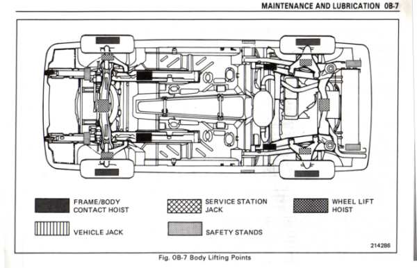

Originally posted by avengador1:
Try this https://www.fiero.nl/uploads/imgs2003/lift_points_1.jpg
taken from this link, I support the rear of the car marked in blue. About the wood between the jack stands and the frame, it sounds like a good idea to protect the frame from any slight damage but must not make the whole thing unstable if used (which it can possibly). I do not use the wood, some do.
avengador1
Posts: 35468
From: Orlando, Florida
Total ratings: 571
Report this Post12-21-2003 07:27 PM Click Here to See the Profile for avengador1Send a Private Message to avengador1Direct Link to This Post
That's exactly where I placed the jackstands when I did my engine, just ahead of where the craddle pivots. Make sure you chok the front wheels so that the car won't roll.
