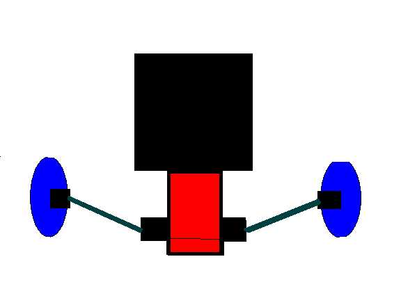

Eh all,,,ok i get that it is a major load bearing structure...
ok so removing the rear firewall is out of the question..so the next idea in line would to be moving the motor back..
just for a sec lets look at the rear wheel drive pic here..
the driveshaft is tilted down a few degree's and offset to the left side...
now on the transverse auto or manual trans the shafts r straight at the wheels but if i go to the long way trans(like ferrari and lambo) can i offset the halfshafts like in the cheap pic that i made and will it work?

I'm thinking your picture is a plan view (looking down from straight above) perhaps an archaic transmission from a Saab would work.
Look to the 99s or probably the ancient 95,96,&97s. Match up would be a BI~CH, shift linkage and clutch would be a challenge (to say the least) and your trunk just might hold a couple bowling balls and a laptop (if your lucky). Probably not the 99 or 900 transmissions.
if I remember right the tranny also served part duty as the oilpan, but I'm not sure.

If you want to go longitudal with an audi trans why not get the engine too?! Get the 2.7 biturbo and slap some bigger turbo's on With the quattro trans you could only use the front driveshafts and ditch the rear one. You might have to cut the lower part of the trunk because these transmission are quite long. Only the upper part of the trunk firewall has the reinforcements, the lower part is only sheet metal and is easy to cut.

Eh Norm no it is not the saab trans,,,,the trans i looking at is the audi..i guess dutch people cant drive because there r allways new cars just wrecked
I was thinking more of the DOHC 3.4 V6 hooked up to the audi trans and run it long in the rear,,but the engine bay is small,, the answers i am looking for is that can i run the halfshafts at angle like in the pic without running into problems?

I guess the angled axles could work as long as the angle doesn't exceed the stock vertical angles....

i really do think in some way it will work,,,but thats it yes it will work but i dont think it will handle of what i was goning to do,,Picture this..3.4 mated to a audi trans and have a ton of room to fad a gr8 3 into 1 exhaust system per bank to install twin turbo's maybe even throw in a custom made intake idea i made up...grabing the Haltech Ecm i was saving for the V12...yes i am sure this little dutch puppy will rock but as i take it out for its very first road test,,pull away easy through first then hammer it into second,, bang axles snap like wet noodles
thinking at the angles the halfshafts r sitting at the needle bearings either end will bust.i can see them taking the load straight on but not any side load..dam that suckz

From bellhousing face to crank pulley, my TDC short block is 22 inches.
Because of the timing drive and power steering pump location, it maintains that length to a height of ~16 inches above the crank centerline.
Because it's a conversion from pushrod, the timing drive is fairly bulky. It might be easier to use the Audi V6, since it was designed DOHC from the get-go and will probably be more compact in general.
As far as CV joint angle... Have you figured out how much angle you'll need? Figure that out first and then we'll look at how hard it will be on your CV joints.
Also, the are offroad products that can take extreme deflections... those may be worth looking into as well.
