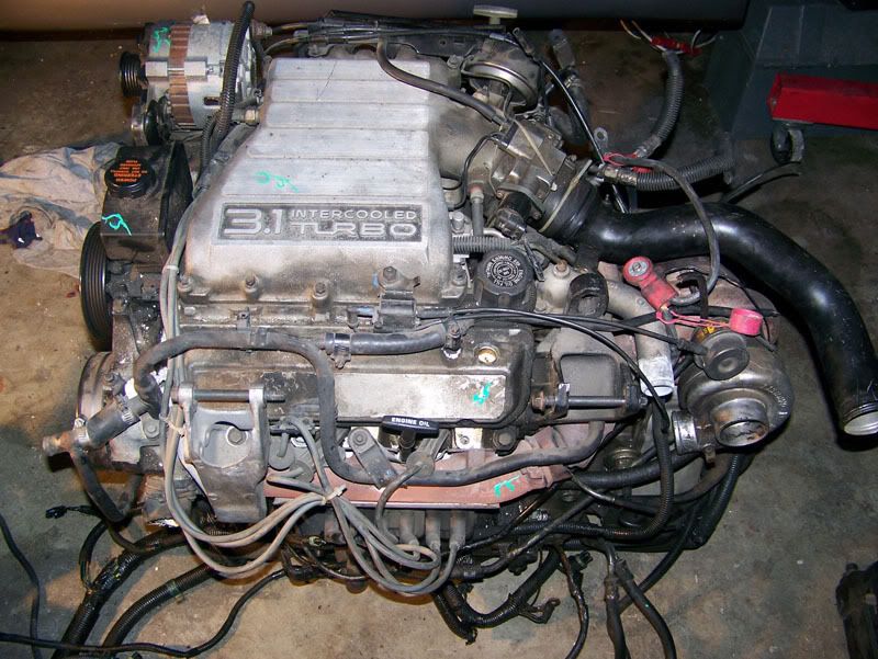

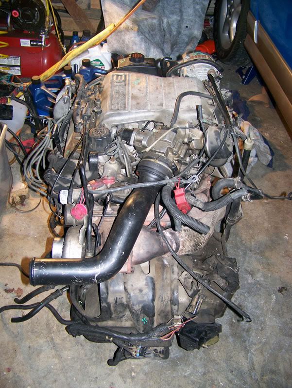

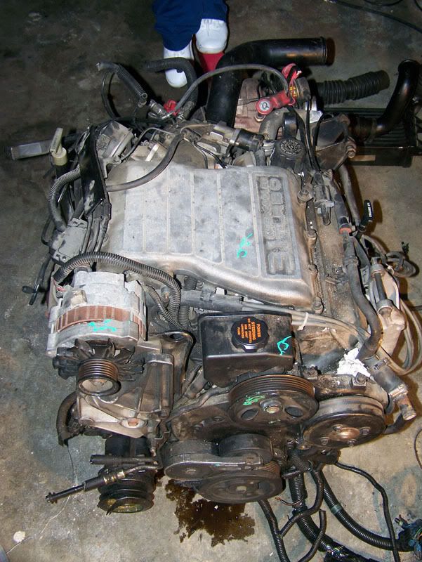

Thanks to Steven, I managed to get ahold of a 3.1L Turbo engine from a 1990 Turbo Grand Prix. If you haven't heard of it, that's cuz only a few thousand or less were made in the couple years they were built, they're quite a rare find - especially in a Pick-N-Pull half price sale weekend!! We pulled the whole engine, intercooler and piping, transmission, complete wiring harness, and ECM for 279 bucks. Score! The oil and fluids looked very fresh and I didn't see any metal bits, and the axles in the tranny turned without any strange noises or behavior, so we'll see.
This engine has several things that set it apart from the millions of ordinary 3.1s, such as a special block casting using a high nickel/tin alloy (probably 2% nickel for strength, and 1% tin to improve pouring characteristics during casting, like SBC HP blocks, not the 20% that has been stated). It also supposedly has a tough crank casting that's also nitrided as well. The plenum is obviously unique to the application, and the most obvious part is the turbo system that comes with it. It's not the most efficient turbo setup, nor the most powerful, but will form the basis of a California smog legal turbo V6 engine swap into my 86 2m4 automatic. Once through BAR inspection, I may later swap in a 3400 in it's place with a custom turbo setup with a much more efficient, larger turbo. The possibilities are endless.

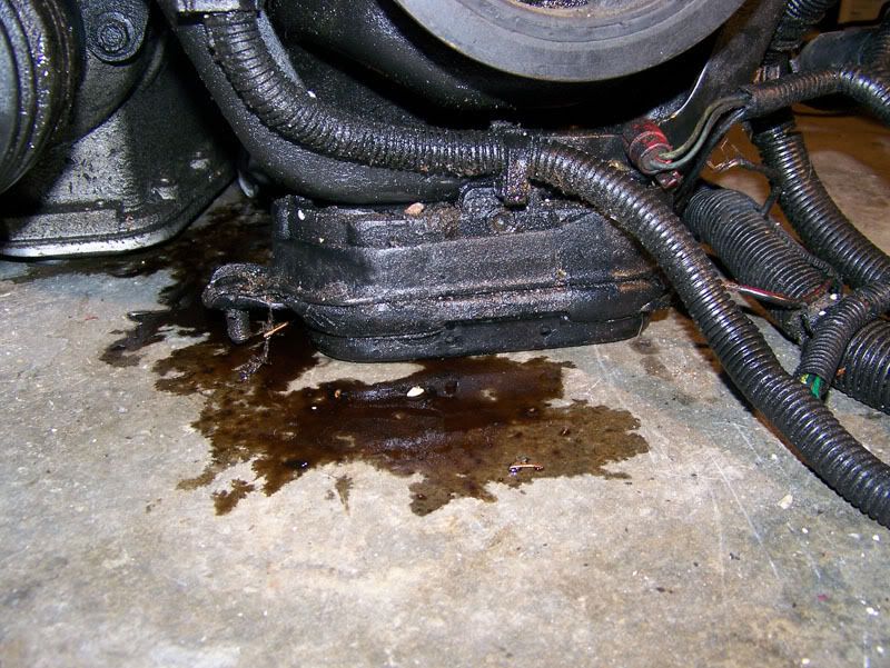

No, that isn't my hand. One of the things I realized, is that the style and location of the stock engine mounts looks very close to the mounts in my 86 4 cyl automatic, for which this drivetrain is destined. Could it be possible that with the right mounts, this thing could drop into my stock cradle? I'm not a big fan of the wimpy 2 point and a dogbone mounting system on my stock duke, so some extra reinforcements will be needed, but that'd be a nice start.

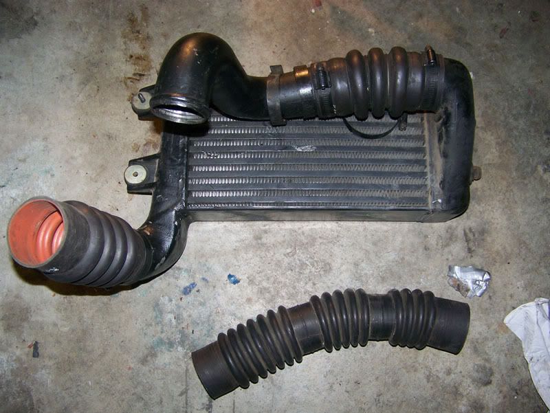

Intercooler and some of the piping.

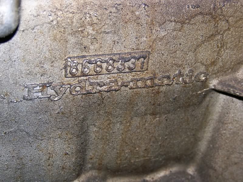

The transmission is supposedly a 440T4 aka 4T60 non E, heavy duty. It's unique to this engine in a couple ways, including the vacuum modulator being designed to operate properly with boost. It's non E, so dropping in a 4T65HD may be a challenge without a solution for transmission control since this ECM doesn't have that functionality. A manual tranny would be too easy, though.
