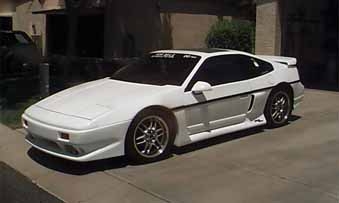

Quick chop to get a preview of what the finished product will look like..
So, what do you think? Am I crazy? Will it ever run?
Stay tuned...
