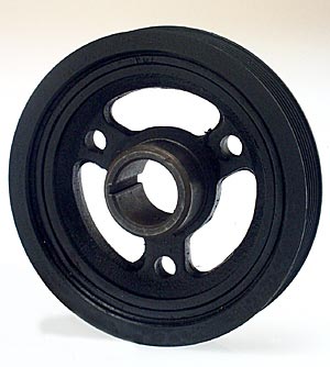

Type-o ----- ( Actually a 3.4L harmonic balancer will NOT work for the 2.8L because of the three star where the pulley mounts as to the 4 star of the 2.8L ) { i meant to say basically you need to use the 2.8L balancer with the 3.4L block to make everything work right} ..... and the timing cover from the 2.8L will not allow the 3.4L balancer to sit properly in the location (close to the block). On the 2.8, the shaft is longer or should I say in the clear as it protrudes out of the circle thing than the 3.4 which the shaft is tucked in a little..... 3/8" difference
2.8L - 5.5" dia x 3.25" wide and weighs 5.5 lbs.
3.4L - 6.11" dia x 2.03" wide and weighs 4.67 lbs.
If you call Autozone and ask to buy one, they will give you this one shown below so be careful
The good thing is that with an internally balanced engine and a neutrally balanced harmonic balancer, you should be able to swap without hurting the actual balance of the engine.... As far as I gather.

your right Raydar... for the 3.4L swap you need to use the 2.8L balancer on the 3.4 block...
I was saying that you can't use the 3.4 balancer with the 3.4 block with the fiero timing cover, pulleys, etc when doing this swap.
