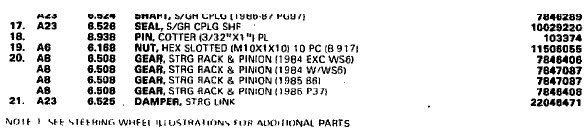

I have a book entitled "Fiero: Pontiac's Potent Mid-Engine Sports Car" by Gary Witzenburg, copyright 1990, published by Motorbooks International Publishers & Wholesalers. It states in a table the following for the steering gear ratios:
19.2:1 ratio (fast)
1984 Coupe/Sport Coupe/SE
1985 - 88 GT
1988 Coupe
22.0:1 ratio (slow)
1985 -87 Coupe/Sport Coupe/SE

I should know this since I've owned an 85 GT in the past, but can you tell me really what I should expect to feel in terms of difference?
If I'm behind the wheel, with the quicker ratio, I should be able to move the wheel a greater distance with LESS turning of the steering wheel, correct? This would basically make the car feel more "responsive"?

That's right. The numbers mean that theoretically it would take 19.2 turns of the steering wheel to turn the road wheels around 360* with the quick ratio rack (if that were possible), and 22.0 turns of the steering wheel with the slow ratio rack... so yes, the quicker rack (19.2) will feel a little more responsive.
