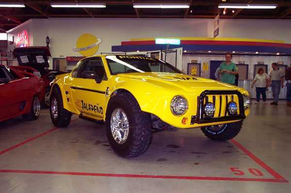

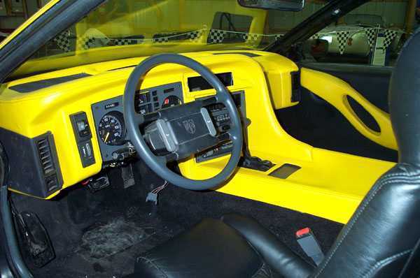

At Carlisle: Pisa interior wrap around dash
You either love it or hate it. It looks like a fun ride.

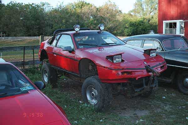

No, THIS is an offroad Fiero!

Homicidal,
That ain't no Fiero buddy. It's a fiero body fit on a Blazer chasis. Both of those monsters are pretty cool, IMHO.

I hate to admit this, but I think the Jalapeno is pretty cool. It kind of reminds me of a Baja Bug, more in spirit than in looks. And with that flat belly pan, short front and rear overhangs, and engine over the drive wheels, it ought to be surprisingly good offroad.
I think an 84 with the 4.10 gearbox would be the best starting point for a Jalapeno. That low first gear ought to be great for climbing just about anything.

Hell, yes, i'd drive that sucker!! The yellow one just needs a headache rack with some KC highlighters

Sorry, but anyone with even an iota of offroad experience should be able to see that this "Jalapeno" is functionally pointless.
PISA seems to be real good at making Fieros appear to be something that they are not. This certainly doesn't seem to be any exception.
The only use I could envision something like this thing offroad would be in a fairly open desert type environment, where the vehicles are driven at relatively high speeds for offroading. Even then, there are some glaring drawbacks...
1. The Fiero suspension itself is too fragile to withstand much offroad abuse. High speed bumps or small obstacles would trash it in short order.
2. That thing has virtually no wheel articulation. It either has to be extremely limited with bump stops or you can kiss the fenders goodbye.
3. How well do you think the coolant and A/C lines running underneath the car would fare against all sorts of debris getting kicked up against them, let alone them occassionally being scraped across an obstacle?
The lack of a driven front end makes it very impractical for most other forms of offroading. And despite what someone previously said about the 4.10 first gear, that is the lowest possible final gear ratio and is nowhere near low enough to be useful offroad.
In short, that thing looks kind of cool but that's all it does. All show and no go in my opinion. In short, if you really want to go offroad, leave the Feiro on the road and get something like this... it'll be less expensive, more durable, and probably more fun, too
