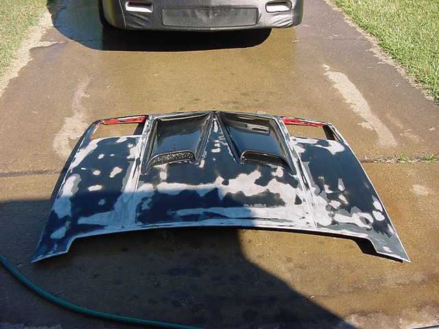

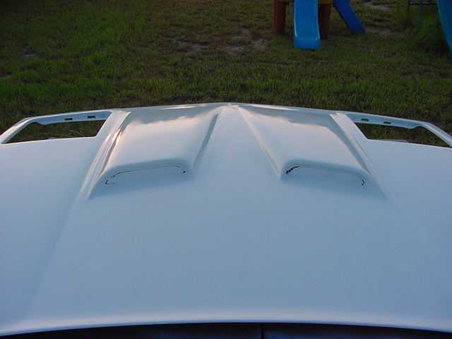

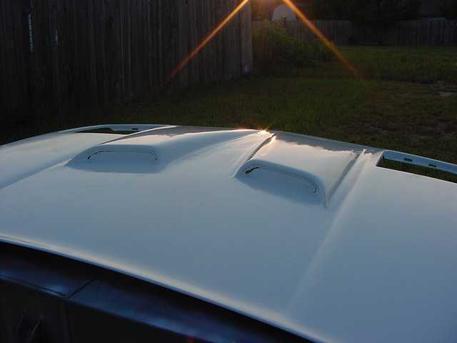

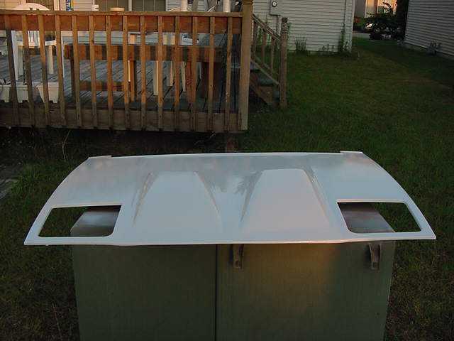

Okay,

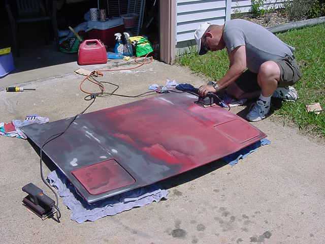

Ive spent 2 hours every night after work, making this thing come out the way I want before the Nationals....
First my girlfriend put the bug in for me to get started, then one of my buddys found the hood for me.

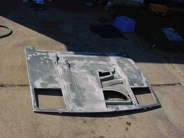

A couple of friends helped me do some of the work also, first we sanded down the nasty old red.
Then the scoops were marked out on top of the hood then we cut out the top sheet,
Add some resin to smooth them in,
the some glazing putty and primer and late last night a test coat of white to better veiw the final touches. [img]https://www.fiero.nl/uplo ads/six.jpg[/img]
So what do you all think, am I crazy?
I even got the RAM AIR hood sticker's from Pontiac to go on it and yes, its functional...
So whats the general opinion?

Looks GREAT! Glad they're functional, too, but if you're using them as an exhaust vent, how's the RAM AIR gonna apply?
Still, looks good.

Ive actually got more vent flow this way than I did before...

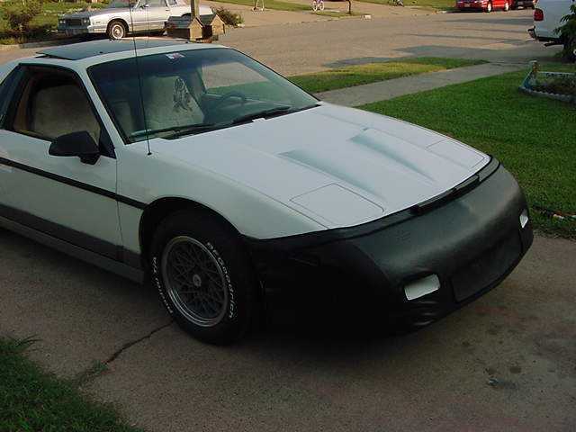

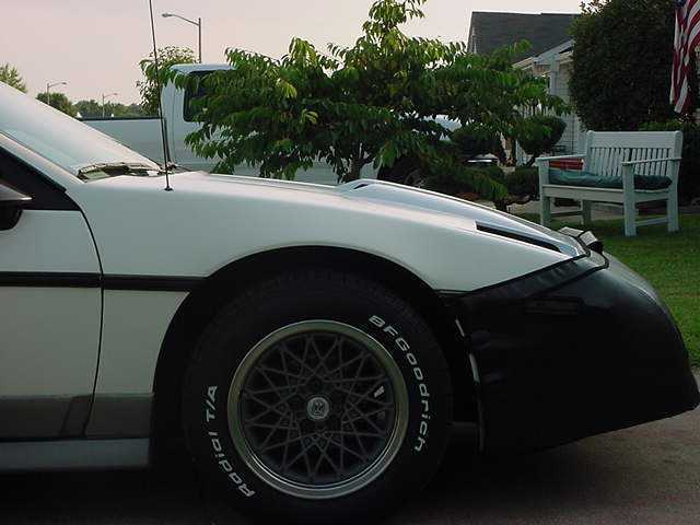

Here is the on car shots....

Thats a real nice application. That side shot is exceptional. The lines work real nice.

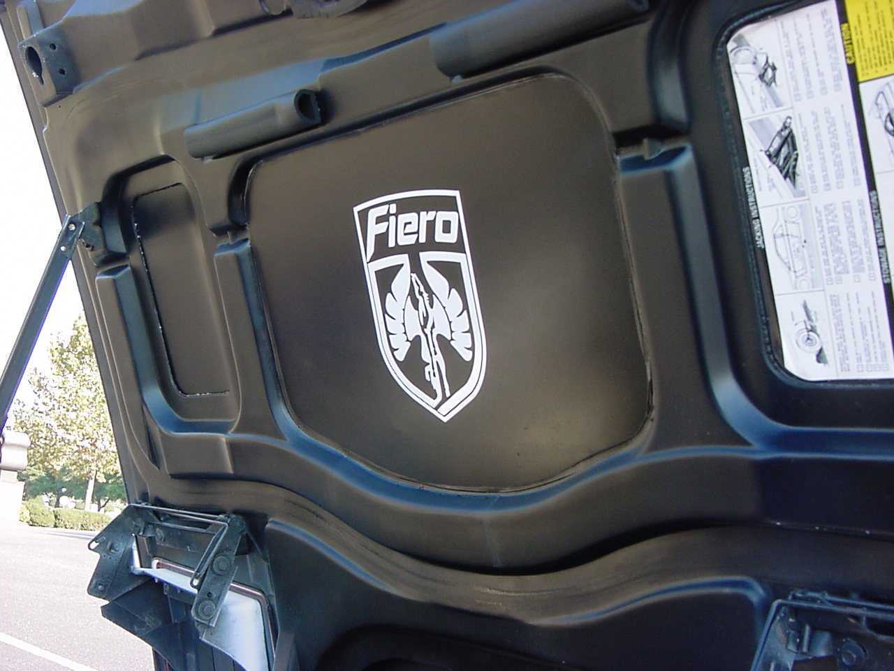

Did you seal off the inside of the spare tire area on the bottom side of the hood?

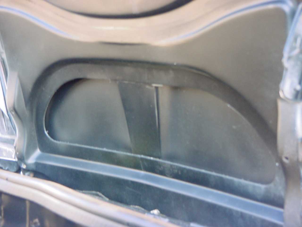

Do you have a picture of the under side of the scoops?

Jake heres the pics you asked for, sorry it took so long...

Please see all the pics and replys in this thread.
Its closed off with alum sheeting and resin attatched to the hood supports......
