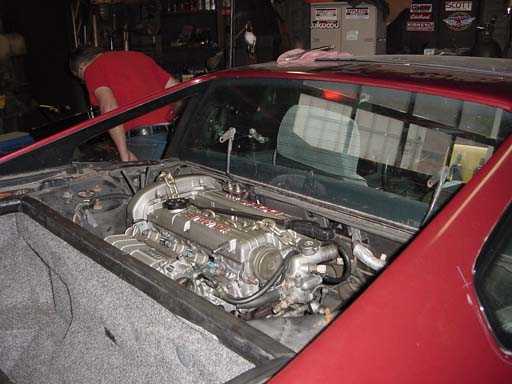

Now this is what im talkin bout... 4G63 Turbo DSM 2.0L bout 200+ horses stock and can pull even more... With the short exhaust thats on it ad like 40 more ponies... thats what David Buscher got when he added his downpipe and exhaust on a STOCK Eclipse... I think i found my next swap... Who cares if its cross breeding... The power that that engine can make is SICK not to mention its LIGHT! Anyways here is the pic i found....

I've seen that pic a few times (even posted it in a few related threads...). But does anyone have any real information pertaining to this project car?
It's obvious that they got the engine physically installed (anything can be physically installed- I've seen the yamaha/ford SHO motor in a Fiero-based kitcar before...) But is the car running? Drivable? Are there any more pics of this "frankenstien" creation? (BTW I think it's cool!)

I would also like to see more pics... Id assume that it should be pretty easy because both the Fiero and the 1g eclipses were OBD1 wich means that you can do anything to here emmisions system and she will still run... That just makes swap easier... In other words, the Eclipse doesnt have a crazy setup like some grand prix do to control fuel pressure using the pump... it uses a Fuel pressure regulator like the Fiero... The complicated part would just be wiring it in... In my case i would use the Eclipse gauges (less hassle and cooler look) and therefore that would eliminate the need for the Fiero computer that i know of!! I think the only REALY tough part is just getting the axles correct. I dont think the Fiero and eclipse splines are the same. That would mean that at the spindles you would need to set up somthing odd to get the hubs and axles to slide together correctly... Perhaps welding an Eclipse spline to a modified Fiero hub?? Whatever you did it would have to be STRONG setup to support the power numbers ive seen leave a DSM Turbo on the dyno!!

That makes sense... even the axels aren't dificult (This also depends on which tranny you're using- the DSM or the stock Fiero one). You can fairly cheaply have custom cut axels made (with one spline style on each side) I think they run at most $60 ea. (Had one made for my 440T4 Auto-since the 6000 axel didn't fit).

Really axles are that cheap? Well that would solve that problem... I garentee a Eclipse engine wouldnt bolt to a Fiero tranny... plus i know from experience the Eclipse 5speed is more durable than GM's trannies... lots of experience! I think im on tranny # 4 now in my Fiero... Burnouts BAD!! So all youd really need to do is get whatever half shaft is the closest in length to what you need (eclipse or Fiero) and have one spline modded for Fiero and other for the eclipse engine! Although id prolly use ther FIERO half shafts cause Sean Glazer keeps snappin the crappy eclipse ones on his 9 second talon! Archie however SWEARS on the Fiero axles!

I'll see if I can locate the name/number/exact cost for the axels I had produced. If I recall correctly, we sent them an axel that was longer than needed with the correct splines on one end. Then also sent them an axel with the other correct end to be matched. They then cut off the axel and re-grooved it to match! Just be sure to measure your length exactly- the first one we had made was about 1/2" too short! And my first day driving it, I accelerated around a corner and pulled the axel out (messy)!
I've also heard of people cutting & welding axels (they supposedly hold up)- but I wouldn't recommend that. Especially if you want to push the power up!

That pic is real??? I always thought it was photoshopped. there is something about it that just looks fake. Might be the lighting or the size...cant put my finger on it.....
I agree that the lighting makes it look fake although the reason for this is that the 4g63 is painted silver from the factory. When i took pics of it in my GS with the digital camera it looked fake too cause when we cleaned up the engine it reflected like mad! I am really starting to think about doin it as a swap! She would make one mean lil 4!
ADDED- i just wanted to add also that Sean Glazer is runnin like 9's flat with a HEAVIER car than the Fiero... so im damn sure that if you can get traction (im sure you cant = drag radials) You can put a Fiero into the 9's or even 8's with a conversion like that! ! there is even enough room to put an intercooler where the baterey goes if you put a scoop there it would be totaly functional! Relocate the battery to the front!

That would be an awesome swap. Man..that must be a friggin hard swap with the wireing and all you would have to figure out. Well..maybe about as bad as a Northstar. This has me thinking....Anyone have an 88 coupe they wanna sell me cheap???

The problem is, you will never be able to get a drivetrain that will hold up to the power for a 9 second Fiero... ok just re-read and realized you said you'd use the mitsu tranny. hmmm...
How about building a pure drag Fiero, front engine/rear drive. I know one of Buscher's fastest talons was converted from AWD to RWD with a north-south engine mounting and ford 9 inch rear end, I think. I'll have to dig out my magazine with it in. That mag also has the 10 fastest talons in it.. some very quick stuff that looks completly stock! And still very streetable.
oh yeah.. and aren't those engines somewhat cheap to get? I'd like to try one of the toyota 3s-gte(? - MR2 Turbo) engines, too.

From what i have heard you can pick up a J-spec engine that prolly has like 45 more ponies (with ease) stock over the us version for only 1,400 with engine, harness, tranny, axles and ECU... BUT i dunno! All i do know it that Buscher makes a stage 3 short block that is GARENTEED to handle 9,000 RPM all day long!!! That would be sick!
JAMES... Brother, your thinking 2 dimensionally! Remember you grab the FULL intereor and engine wire harnesses and computer, gauges, and few other controls you may need... Then slide that all into the Fiero.. gauges too.. cause then you can have reverse indeglo gauges that have the correct redline, wiring, speedo (YOU KNOW that that car can burry the 160mph speedo dont you I think a couple crazy bastards did that one night didnt they?). I would also grab the fuel pump and its harness so you can then use the Eclipses fuel gauge and get the correct fuel flow requirements too (way higher than what Fiero pump can run). You know bro... Im actually THINKING of doing this with that extra cradle thats at my grandmas! I have a welder... Bwaa haa haa! What do you think? I know where to get another eclipse motor non turbo to start (we both know they are easily turboed bolt on style) JUST to see if it works. Can pry get it for a few hundred!

one question... why? why put in an engine that produces only 200hp and put thawork into it whne you could easily put in a turbo quad 2 or a SC 3800 or a small block V-8. hell js put a turbo on the 2.8 and you got 200hp...hmm 40hp from an exhaust system, i can see that not hapening, maybe 5 or 10 but 40! now thats rice talk. an import engine in an american car... i think its a disgrace to america
Originally posted by GTFiero1: one question... why? why put in an engine that produces only 200hp and put thawork into it whne you could easily put in a turbo quad 2 or a SC 3800 or a small block V-8. hell js put a turbo on the 2.8 and you got 200hp...hmm 40hp from an exhaust system, i can see that not hapening, maybe 5 or 10 but 40! now thats rice talk. an import engine in an american car... i think its a disgrace to america
My thoughts exactly. people go on the net and get the idea that you can make tons of HP really cheap from these motors.
My friends Talon puts down 375hp and he has quite a bit of money in the car , more than a archie swap I promise you that. Runs 12.3's , swapped cam , turbo , extrude honed head , bigger injectors , cams , exhaust , ball bearing turbo..ec..ect..
My friendly GM dealer sells a Fast burn 385Hp small block for under 4 grand. The DSM motor is nice , but it has wet dreams about that kinda Torque.

Now I don't mean to be a pain about this one (and I'm not talking money cost or reconfiguring the car) but Archie's site shows a timeslip from Pat Ciarcia at 10.2 ( http://www.v8archie.com/pat.htm ) and I've never seen a Mid-Engine Fiero run faster.
I know, I too have seen Fieros run faster than 10 seconds... but a front engine/RWD isn't exactly the same. Like I said, you may not like it... but you gotta respect it!
