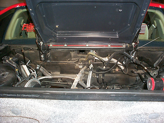

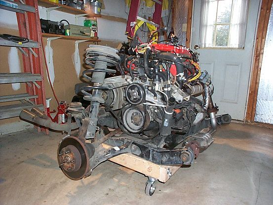

Took me about 5 hours working by myself (lots easier with a helper!), but it's out!
Second time I've had this one out (my GT), gets easier each time. Imagine that!
Doing new clutch, clutch lever, shifter cables, replacing exhaust manifolds (Fleabit? ), replacing injectors.
Yeah, I know Archie, I shoulda had a V8 . . .

Did you use a engine hoist to raise the back of your car? I was thinking of doing that.

No. If you'll look closely at the second picture above you'll see a 4X4 rig under there supported by jackstands. I Jack up the back end normally, with a floor jack under the subframe under the rear. Then I position that 4X4 rig lined up with the side jack points, and use a floor jack to raise the body about half that height.
Then I lower the engine using floor jacks and pieces of 4X4, lowering it about half-way to the floor. I lower it to rest on four jackstands so I have a jack free to raise the car.
Then it's back to the rig under the car, and I raise that as high as I think it needs to be to clear the engine.
Then it's back to the engine, where I lower it as far down as the floor jacks will go. Then I drag it out on the floor jacks. That's where a helper is nice, to help balance things.
