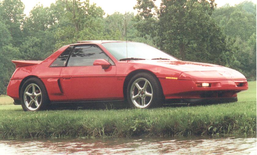

lildevil Member Posts: 1537 From: waldorf,md Registered: Aug 2001
Is this what you mean? Thanks for the kind words Skitime. I did these about 3 years ago. I get a good reaction when people actually notice them. =) ------------------ Earl Sessions 1985 Fiero w/ 1998 Supercharged 3.8 V-6 Best ET: 13.232 @ 101.24 mph

| quote | Originally posted by lildevil: Is this what you mean? Thanks for the kind words Skitime. I did these about 3 years ago. I get a good reaction when people actually notice them. =)
Thanks for the info guys.. Looks great lildevil.. Do you have any pics with the door shut & window up?? How did you attach them?? Tape or Bonded?

TRiAD Member Posts: 4464 From: Central IL Registered: May 2001
Those are AWESOME! ------------------ []image dropped temporarilly[] TRiAD Motorsports ~ Performance Tuning of European, Japanese and Domestic Automobiles Project MR1 / Let the modding begin! ~ triadtuning@hotmail.com * AIM ~ Michael Blue 72 Only the dead have seen the end of war. ~ Plato
No no no...don't do that HAZE. All you need is this. Go to the junkyard and get two old notchback quarter windows. Then go to home depot or Lowes and get some plexiglass sheets. Grind the area on the quarter window where the emblem goes down about 1/8 inche. Break the old plexiglass off too and grind the surface. Then size up the new plexiglass and cut it to fit over the ENTIRE quarter glass frame. Use window urethan or this stuff called FUSOR that body shops use (this is best) Its what the new Vettes are held togetherwith. And glue the new plexiglass down. Grind down the entire surface again and fill and smooth the area with body filler. Plastic prime the surface then urethan prime it. Sand it down some more and paint. TADA! thats all there is too it. I'll have to get a bettre pic of the car with thhe doors closed today. But my signature pic shows i too ------------------ Earl Sessions 1985 Fiero w/ 1998 Supercharged 3.8 V-6 Best ET: 13.232 @ 101.24 mph
hope this is bigger

Haze_Performance Member Posts: 7452 From: Illinois Registered: Mar 2000
| quote | Originally posted by lildevil: No no no...don't do that HAZE. All you need is this. Go to the junkyard and get two old notchback quarter windows. Then go to home depot or Lowes and get some plexiglass sheets. Grind the area on the quarter window where the emblem goes down about 1/8 inche. Break the old plexiglass off too and grind the surface. Then size up the new plexiglass and cut it to fit over the ENTIRE quarter glass frame. Use window urethan or this stuff called FUSOR that body shops use (this is best) Its what the new Vettes are held togetherwith. And glue the new plexiglass down. Grind down the entire surface again and fill and smooth the area with body filler. Plastic prime the surface then urethan prime it. Sand it down some more and paint. TADA! thats all there is too it. I'll have to get a bettre pic of the car with thhe doors closed today. But my signature pic shows i too
Thanks for the info & pics.. Off to Home Depot i go.. I'll post my progress.
