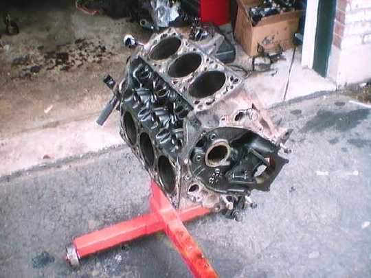

Finally getting around to posting a few pics, and made a little progess this weekend.
Here is the engine as it arrived.
All stripped down and ready for the maching shop.

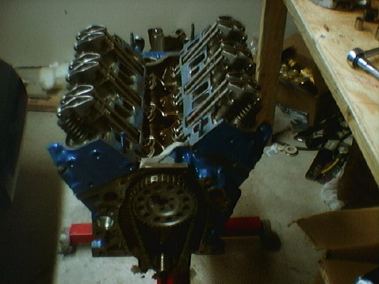

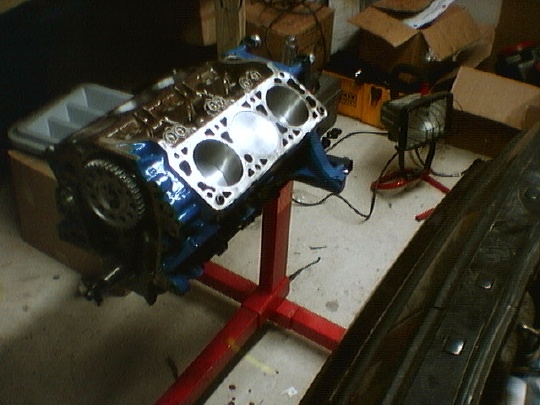

Short-block assembled and ready for the top end.

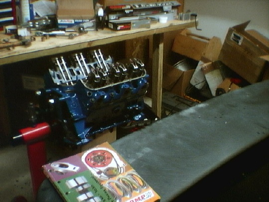

Side-shot of the valve-train.
Another shot.
I installed the heads, gaskets, lifters, pushrods, rockers, and adjusted the rocker play today. Now to begin external bolt-on assembly.

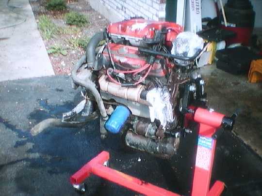

I will post pictures tonight. I spent about 2 hours this evening stripping the engine in the Formula to swap over to the new engine. I was able to get the original engine down to the block and heads. Exhaust is off, intake is off, rocker covers are off, etc. I did break one of the ss bolts in the middle intake, but luckily I have a spare intake, so it doesn't matter at the momemt.
I downloaded the pictures from my camera, but they are no good. I need a better camera, one with a flash.
Upon inspection, the inside of my old engine is NASTY. Everything is covered in black slime, and all the allen bolt heads in the oil galley are full of dirt and crap. The cam is obviously very worn, not a dark spot on any of the lobes. Lifters are very shiny too. According to CompCams, stock valve-train is made to last 100K miles. I'm closing in on double. Tomorrow I hope to finish stripping down the original engine(and finally see what a timing chain with 186K miles looks like). Then its cleaning and painting the parts I'm swapping over, bolting them on, and installing the new engine. I'm hoping for the end of April.
