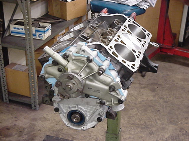

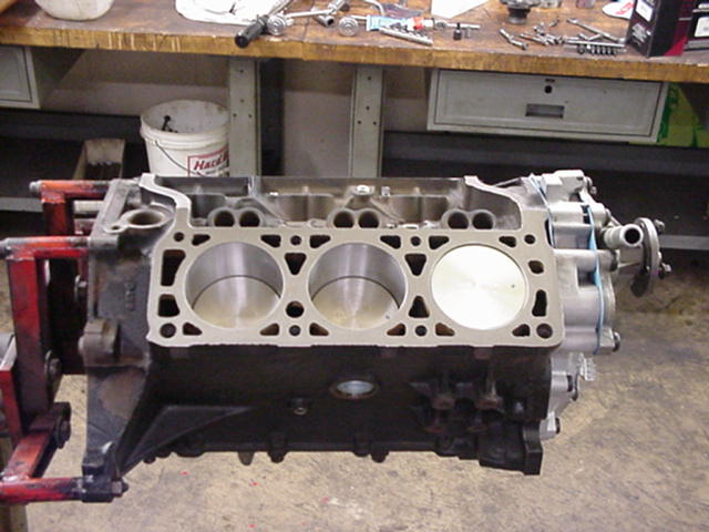

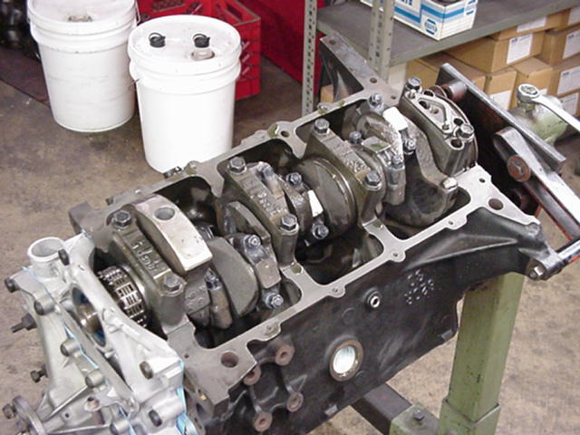

Engine has been decked bored crank fully ballanced better then the 88's rods matched
bored .030 over.
another view of the engine. Water pump tube will be capped off scince 87-88 V-6 Fiero do not use it
engine fliped

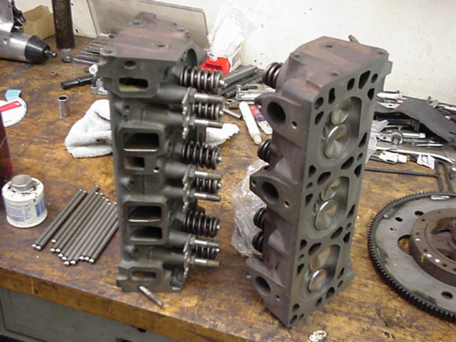

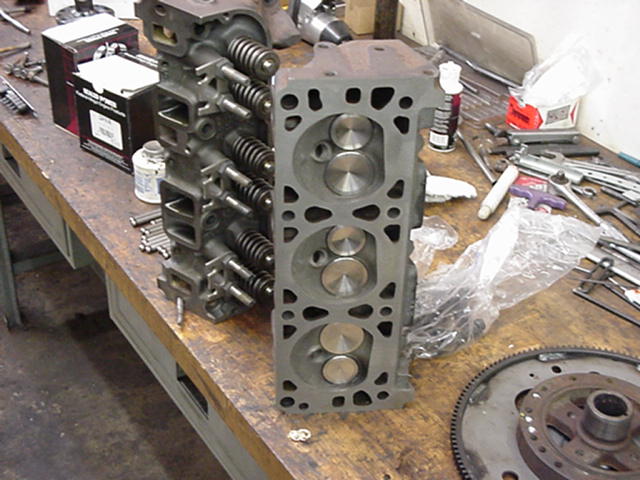

Heads have fully been ported and polished, 3 angle comp valve grind, SI stainless steel valves have been back cut.
Both heads fully assembled
My Cam by the way is the Compucam 2030. Im also running a high volume oil pump. Harmonic ballancer was also ballanced as well as the 88 style fly wheel. The engine has been fully ballanced and blue printed.

very nice!
Spyhunter
Posts: 1254
From: San Francisco, CA
Total ratings: 86
Report this Post06-05-2002 07:28 PM Click Here to See the Profile for SpyhunterSend a Private Message to SpyhunterDirect Link to This Post
nice pix. is that a stock 2.8 Fiero engine or something else? Looks to me like the 2.8, ut then again, ive never taken mine apart
Fierokid87
Posts: 4954
Report this Post06-05-2002 07:34 PM Click Here to See the Profile for Fierokid87Send a Private Message to Fierokid87Direct Link to This Post
Its a modified 2.8. Its actually more like a 2.9 or 3.0. not sure which though. It was bored .030 over

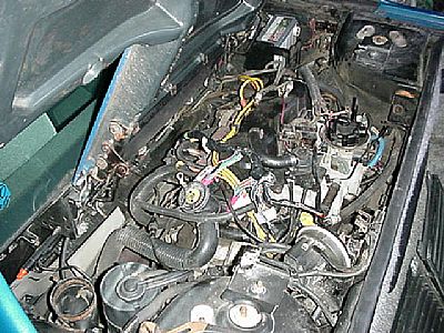

Fierokid87
Posts: 4954
Report this Post06-05-2002 08:10 PM Click Here to See the Profile for Fierokid87Send a Private Message to Fierokid87Direct Link to This Post
Fierokid87
4954 posts
Member since Jan 2001

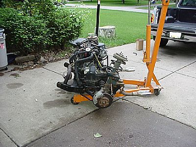

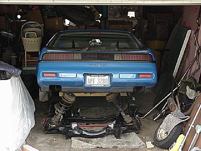

The next three pictures ar of my work that I went through to start this swap. these are old pictures. About a year to be exact.
The ol'Duke out of the car. Like how I am moving the cradle and engine assembly around?
My, my, my, what a mess. Can hardly see the ol'duke under it.
This si currently what my Fiero looks like. I hope it has not settled. As in the frame maybe bending or something. Cuzz its been up like that for about a year. I have already switched the fuel pump to a V-6 and reinstalled the tank.

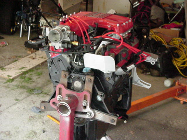

Fierokid87
Posts: 4954
Report this Post06-07-2002 10:11 PM Click Here to See the Profile for Fierokid87Send a Private Message to Fierokid87Direct Link to This Post
Fierokid87
4954 posts

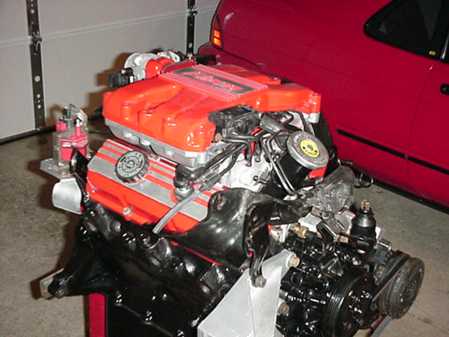

Ok everyone here they are. Eng ine is not totally done yet. But its getting there. This is what Ive done all afternoon scince 3:30 pm.
there they are. Ill post totally completed when im done hopefully sometime this weekend

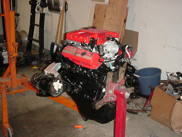

Fierokid87
Posts: 4954
Report this Post06-09-2002 08:09 PM Click Here to See the Profile for Fierokid87Send a Private Message to Fierokid87Direct Link to This Post

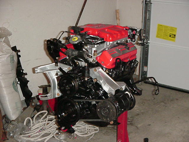

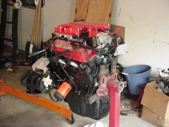

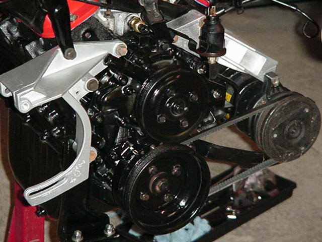

and the completed engine!
Oil cap sticker look familiar? Its from Rodney Dickman. Thanks Rodney.
All i have to do now is install the starter, Alt., and attach the tranny and then I can start putting things back into the car This all will probably happen this month.
