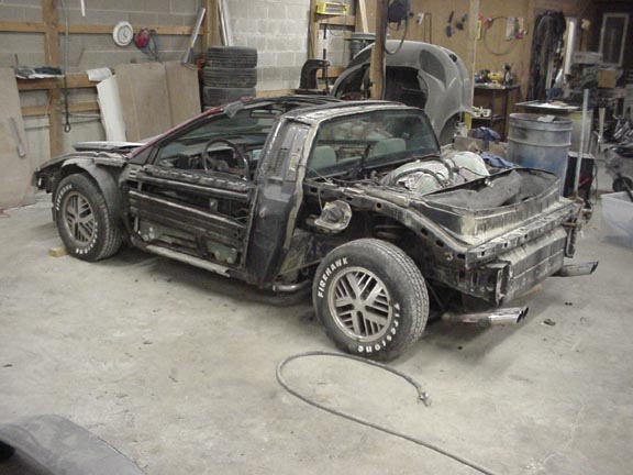

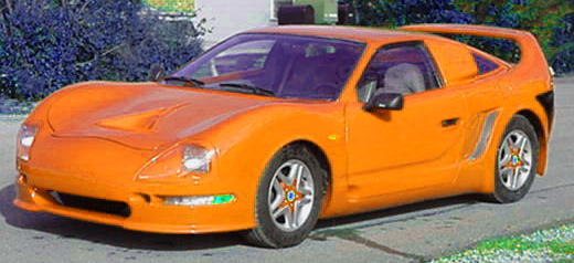

The victim, you most resently saw this car for sale in the Mall. It is the car I took to the Dell's last year after the little mishap with my Finale & Fino (let's not get into that here).

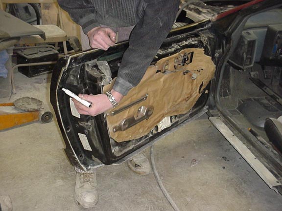

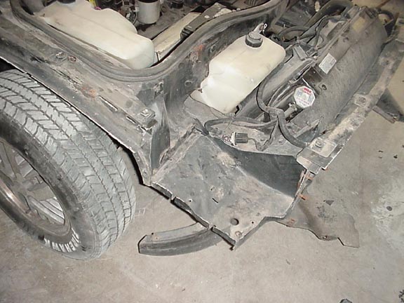

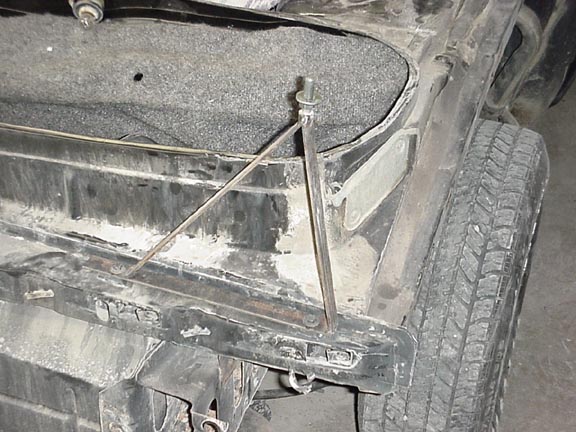

Right after lunch today at 12:05 it looked like this:

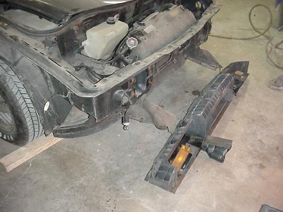

At 2:46 pm we had the body off of it and it looked like this:
And at 5:24 pm we had already test fitted the rear clip.
Now I have told people that we can mount one of these bodies, hinged, latched and lighted in 4 normal days. Well with telephone calls, visiters, customers & their cars, I'm going to keep track of the number of hours we spend on this project. As I look at it now, 5 weeks would be plenty of time to get it ready for Daytona. However late next week we have a customer V-8 & chop top car to start on & another V-8 & Chop top car coming in 2 weeks after that along with a commitment to finish up an F-40 for a customer that we've been working on. So you can bet 5 weeks will go by very fast indeed. However, we have enough time before the next V-8 swap to follow through on mounting this body up to where it is ready to prep & paint. We are also doing a Video Instruction tape on the Fino/Finale body installation on this car and Mr. Blake from Kit Car has asked for still photos for a magazine article. So just about everything that can delay this project will be in play as we work on this thing. I've already shot some 30 minutes of the Video Instruction tape and as you would guess, my guys can't work on the car while the video is being shot.
Today, in 5 hours 24 minutes we completely reduced a nice drivable V-8 "T" top Fiero into a bare chassis. WE trial fitted the Fino rear clip and we shot 30 minutes of video and I took 23 still pictures of it all.
A good day.

What about that burnt orange metalic thats on the new Pontiac Vibe and Sunfire at the auto shows. The Saleen S7 was running somethin like that too. Its neat.

These are the colors i was talking about

Well Randy, you managed to pick two of my favorite colors. The Green (obviously) and Metallic Blue (actually Dodge has a nice form of this- highly metallic). That'll be my next project color (if I ever finish this one ).
Personally I think you should avoid the Medium Metallic Green (that was the base color used in my car)... we don't want too many of these Green-machines running around (and we are in pretty close proximity ). Actually I'm going to need a repaint (probably next year) after a handful of body mods- and I'm going to go to a slightly greener-green (Toyota has a nice one on the new Tacomas). My car is too often mistaken for black in low/dark lighting.
I have a couple of real thoughts on color... the orange that is shown above- would be awsome! It is a very exotic-looking color and will stand out above all others. Mitsubishi did a cool orange on their 2000 eclipse prototype showcar. The car was originally painted siver, then coated with 18(?) coats of orange-tinted Clearcoat. It made for an extremely "deep" color.
Second on my list: Peter Ashdown (who I almost visited back in '97 while on "holiday" in Britian) had originally named his business "candy apple cars" (I happen to have his original Finale brochure with attached 4x6 35mm printed photo). So why not a really slick "Candy Apple Red"?
Lastly- since the design is originally British (and Lotus-influenced) why not go with the traditional BRG (British Racing Green). It would still keep it in the greens, but not necessary the same as mine ( )
Basically I think it boils down to how you want to present the car. As an exotic- go orange. As a British influenced design- go BRG. Or as an American built Hot Rod- go Candy Apple Red.
then again these are just my opinions... and if the Forum votes for Medium Metallic Green- or anything else I'd be just as happy (actually I'd be a bit flattered that people like my Green Car).
Oh yeah- one last thing. Gold wheels make the Green/Tan combo perfect... keep that in mind when looking through aftermarket wheels!

Let me try to bring up to date on the progress of our Fino project car.
In the last 2 days, I figure we have put in about 11 or 12 hours and along with the 1st day of this project we are now at a total time invested of like 17 hours & the car is basically roughed in and has all been trial fitted.
The following text and pictures are meant as an outline of the work performed, the Video instruction tape will give the exact details of the installation.
At the beginning of the day Friday this is what we started with.
We dismounted the from "Z" beam, removed the headlight assemblies & the inner wheel wells.
Because the Fino and Finale bodies are more rounded on the corners than the stock Fiero is, we have to "round-off the corners of the Fiero chassis. To do this we have to cut out the sheetmetal that forms the Fiero headlight bucket. To build this car, there is very little cutting you have to do to the stock Chassis and NO Welding.
On the rear of the car, we have removed the "Z" beam rear bumper. In this case we are leaving both "Z" beams off of the car but you can actually put them back on after you've trimmed off the ends of them. If you just trims off the end of the rear "Z" beam, that's all you have to do to "round off" the Fiero Chassis for the rear clip. The rear of the body we are about to install has to have a mounting point. To mount the rear we use these 2 Triangle supports (included with the kit) They just bolt down and stick up like this, we will show you more on this as we mount the body.
Now we start mounting the body. It might surprise you to know that the best way to mount the body in the correct position is to mount the Door panels 1st. In this picture you see us marking the door panel for the door panel fasteners (included with the kit). These fasteners will be mounted loosely so that we can move the door panel around a little bit as we try to line it up with the rear clip.
More to come tonight.
