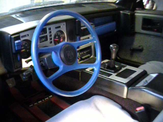

I have finally gotten off my a$$ and taken some pics of my Interior that is 80% done. Here are a few pics. Keep in ind that Im not done with the doors, seats, covering the steering wheel with a black leather cover, and I still have my old red floormats. Also I repaired all the vinyl coming apart from the seams.
This is the new painted aluminum look! Nice and cheap

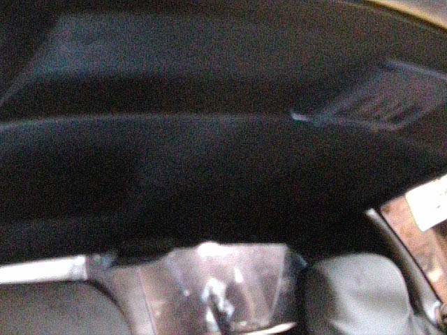

This is a shot of the Vinyl Headliner. Hard to see in a dark garage.

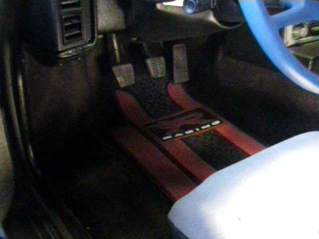

A pic of the new black carpet I just put in. Pay no mind to the clashing red mats.

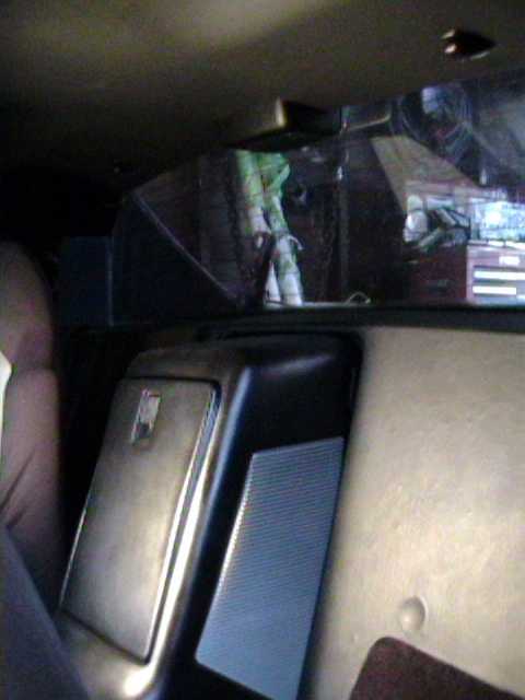

This is a pic of the center console and Vinyl firewall and headliner.

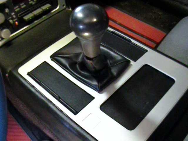

looks good...did you paint your ashtray covers? If so,may I ask what kind of paint (brand)and type (flat/semi-gloss)you used on them?
thanks
Tim
connecticutFIERO
Posts: 7696
Total ratings: 224
Report this Post08-13-2002 07:40 PM Click Here to See the Profile for connecticutFIEROSend a Private Message to connecticutFIERODirect Link to This Post
I painted them with Duplicolor vinyl and plastic paint from Walmart/AutoZone. Real Cheap pretty durable. Rub the ash tray doors with acetone before painting to induce bonding. Works like a charm... Looks good too.
