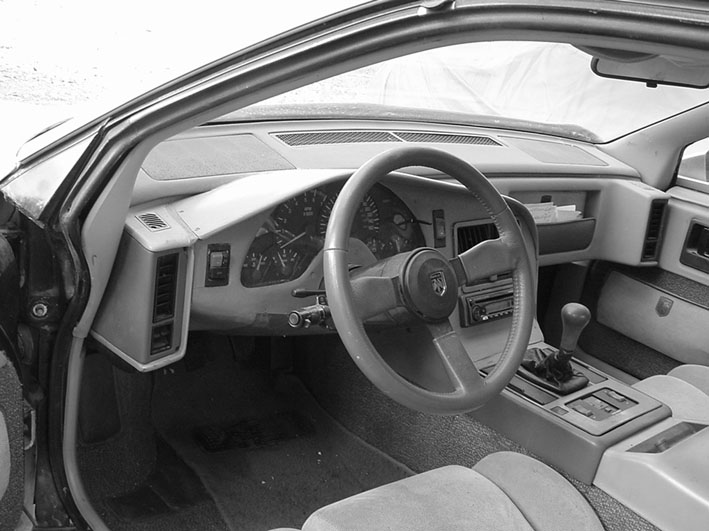

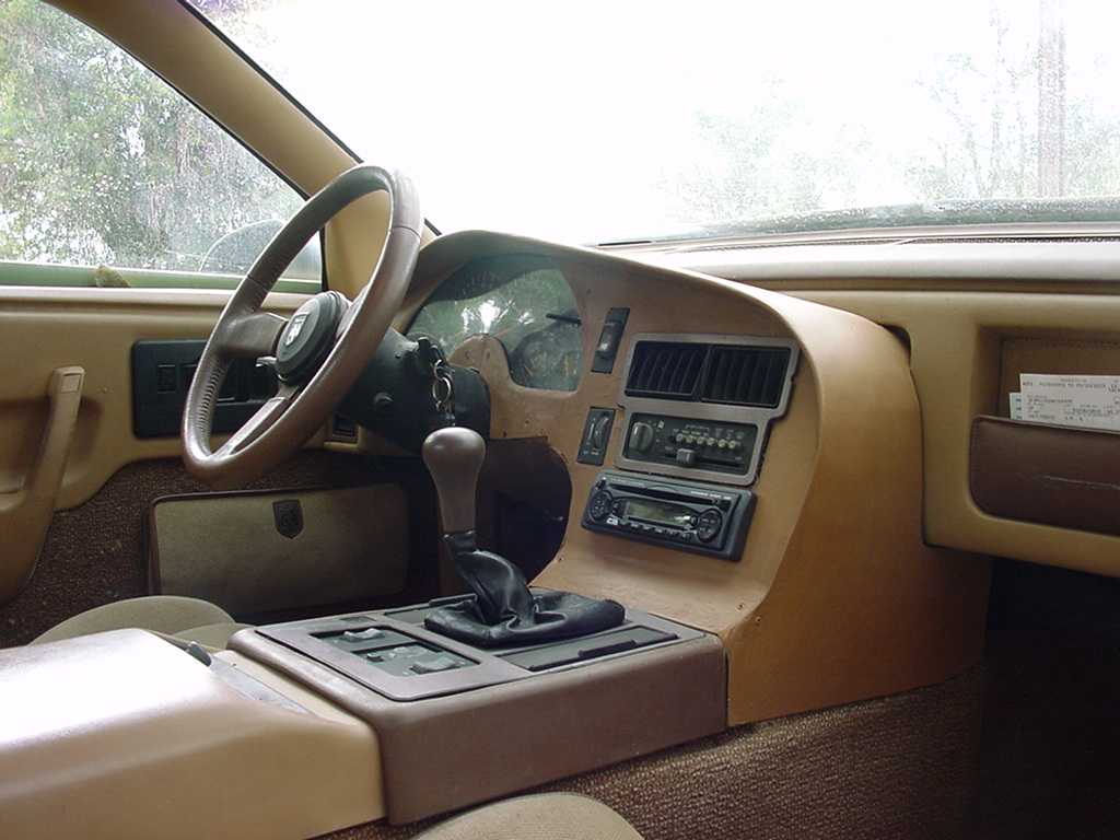

Do you have any more pictures of the dash? That looks awesome.

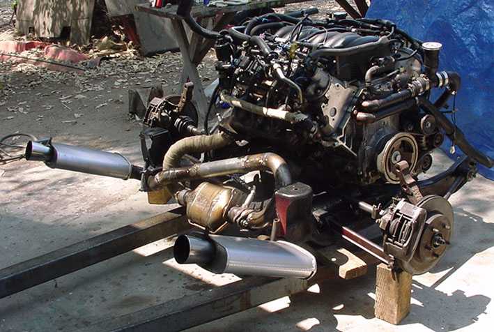

I would like to see pics of where the exhaust comes out. Looks sweet. Love that dash too.

That dash is sweet!! It looks a lot like what the 1990 would have looked like. Oh and I like the engine too.

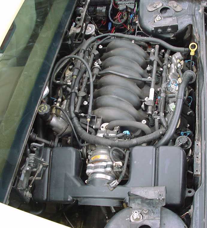

Congrats. Nice job. If I may ask one question, though, why did you keep the air baffles? (Not a critique, just a question!) All the f-body guys ditch those first thing for a decent air box. I would think you could fab up a cold air kit that would fit better and make more power (not that this may be a large concern at this point!)
Keep us posted!

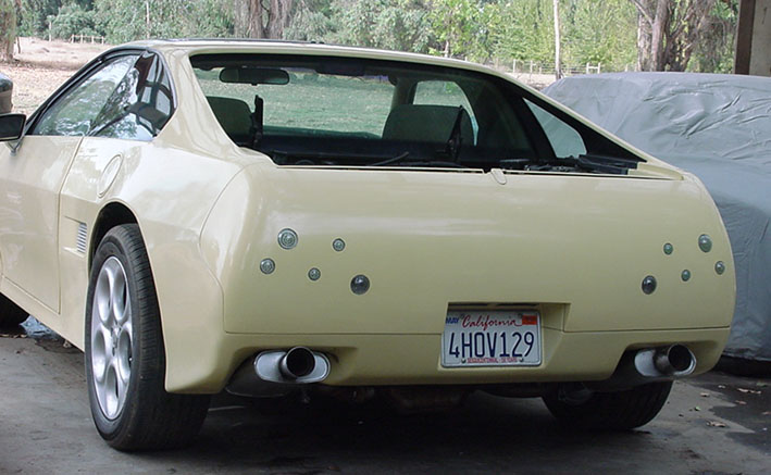

Here's another pic of the dash. it's home made,
not a kit. Glad you guys like it.
KissMySSFiero, this is what the mufflers look
like installed.

That's actually a pretty darn cool tail!
Kind of TVR Tuscan like.
Congrats on the whole car, very impressive.

Make that dash fiberglass and offer it similar to this... http://cyco.home.cyberverse.com/fieroparts/rpa/rpaint.htm
It will sell.

Hartz, I wonder what rational the gm engineers
have for that airbox/resonator/donkey-dong thing, other than to take up space in the engine compartment? I'm using it because 1) it was there and 2) because, for now, it provides a more stock look for when I have to have it
checked by the carb ref's. Right now I still
have several months to go before my next
mandated smog check.

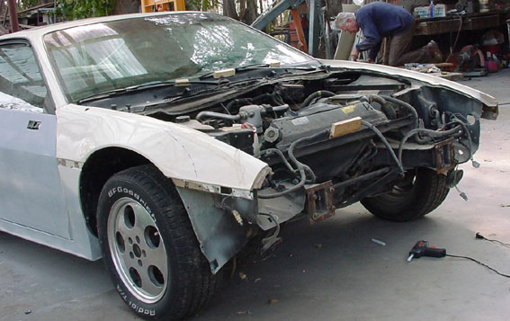

I need more details on how you did the body work. Do you have any build pictures? Looks great!

starting to build the plug. It shows how far
back the frame was cut and also the radiator
position. My camera is loaned out, when I get it
back I'll take a shot of the car as it is now
with the hood up.
Orville
