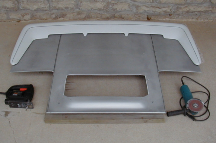

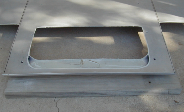

Hey kids, I got the prep work done on the scoop. it turned out pretty good. I'm happy again. I bought a sanding disk for my 4" Makita high speed angle grinder. Wow, does that work nice on fiberglass. Hehehe, I felt like "Tim the toolman Taylor" today playing with all my power toys... hmmmm, I mean tools... (drill, saber saw, and grinder}.
Ok, here is my rear deck lid after I cut a hole in it. How do I finish removing the rest of the hump in the front?
Underneath that remaining hump part is a substantial brace. I sort of hate cutting into that brace, because I'd like to retain the strength, plus it's not going to be easy. Guess I'll try to remove as much of the upper part as possible and leave as much of the brace as possible. The hump has to go or else the scoop won't mount flush. If anyone has any suggestions, I'd appreciate it.

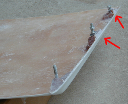

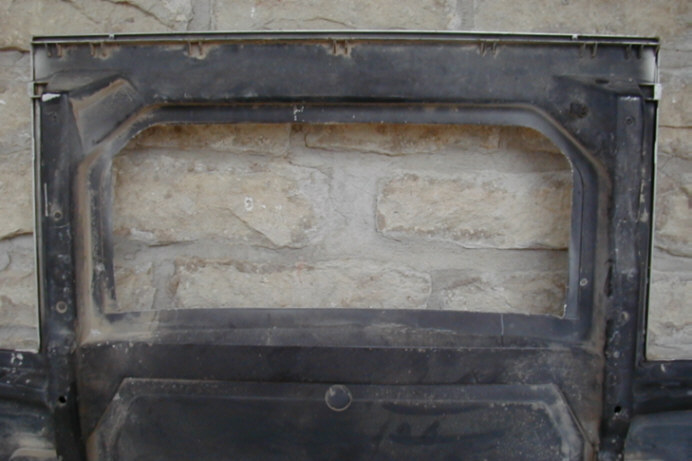

I have the holes drilled and the scoop mocked up into place. The front part of the scoop sticks up a little because I haven't figured out what to do about removing the last part of that blasted hump.
I can't help but grin. This Mustang scoop and Dodge Shadow spoiler combination is looking great. Can't wait to see how it looks on the car. I think it's going to be beautiful once I get my new paint job.

Looks good!!!!! You did a good job.
I removed all of the hump, From the top, but left as much of the brace up under in the rear. If no the scoop would not sit flat.
In your first pic it looks like you left part of the hump in the rear?? Thans the part the needed to be cut out also but leave the brace under it!!!! you will have a flush mount!

From the underside your hole looks just like mine. Just cut the hump from the top!!!! and leave the brace there.
You got it right!!!

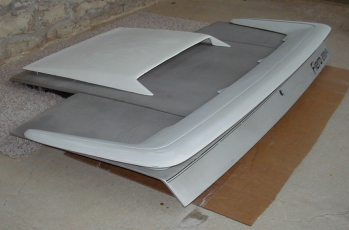

Got the rest of the hump removed and left as much of the inner brace as possible. I now have the hood scoop completely fitted and ready to bolt on. Just need to run into town for some rubber tubing to attach to the lip of the hole. After that's all done, I have to swap over the deck lid release solenoid, run the wire down the channel, and swap over the lock cylinder. I'll post another pic later when it's all done and on the car.

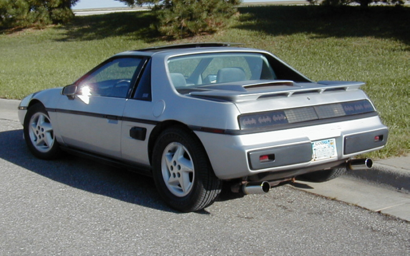

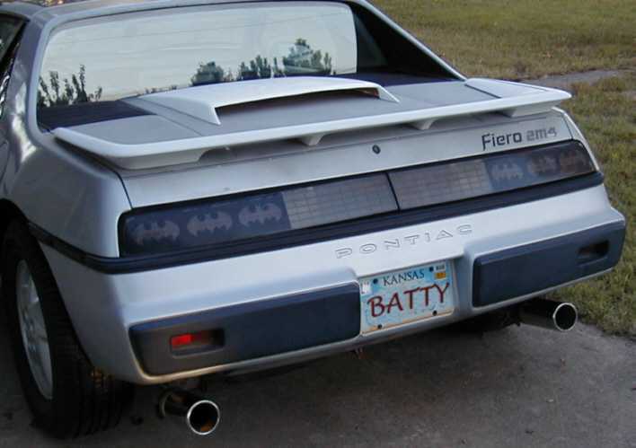

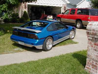

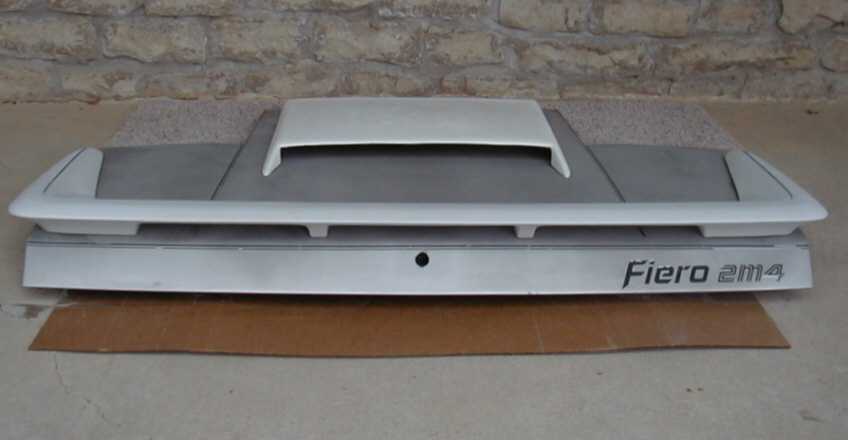

The Rear deck lid scoop project is officially finished. Sure took a lot longer than I expected, but it came out pretty darn good, if I must say so myself. Sure looks different than that funky luggage rack that used to be back there. Now if Twin Lakes Bob gets those side scoops and ground effects made for me later this month like he promised, I'll be getting close to sending this beast to the body shop.

Love the wing I have the same one on my 85 GT

Look's Great with the wing!! Are you going to 'smooth' it in??

Yep. I'm going to have the body shop run a bead of filler down the outer seams to "smooth" out it out a little.

Hey Batboy, how did you get rid of the holes from your luggage rack? Looks like someone tried to do it before I got it but they have just popped up.

Well, I cheated and bought an "unholey" rear deck lid (sounds evil, huh?). I lucked out and found a decent one at a local salvage yard for a mere $35 that just happened to be the same color silver. The only thing wrong with it was that it had some minor damage that will be easily repaired around the lock cylinder.
I now have an extra, perfectly good rear deck lid, complete with luggage rack. I would be willing to give this gem away for free if someone could actually use it. Decided that I didn't want to attempt filling the holes on my old one.

Looking great Bat. Are you planning on filling in the slotted area, the area under the spoiler? Also, it appears as if the spoiler could be split in half and widend maybe a half inch? Thanks for any feedback, I'm also considering this spoiler for my choptop.

Hey Choptop, I do not plan on filling the spoiler slots. I like the way it is. As for making it longer, that's way beyond my humble skills. Besides, it fits perfectly right now in my opinion.
The forward edge of the spoiler mounting surface is only about 1/4 inch from the edge of the deck lid side. Really not much room to stretch it. But hey, feel free to customize one to suit your fancy.

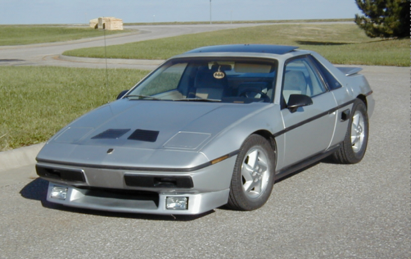

Since y'all made the big mistake of complimenting my car, I'll post another pic. It's actually in sad need of a new paint job, but I'm now going to wait to do that next spring after the new hipo engine's installed.

Looking good Batboy!
Hope my decklid scoop turns out that nice.
Jeff
