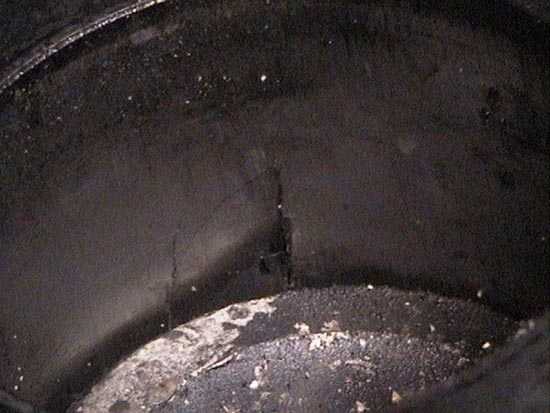

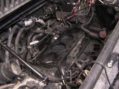

Well, my car decided to quit turning over the other day, so I tore the engine apart in my garage. I got the head off and I wasn't too pleased to see what I saw...
Upon further inspection :

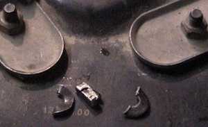

And I found this sitting on top of the #4 piston...
So, if a little washer or something f&cked up my engine, I'm gonna be pissed...
The #1 piston was all the way down. #'s 2 & 3 were all the way up, and #4 was up as well, although it was quite crooked. I was able to push it down though, so it must've separated.
When I drained the oil there was a gallon of pretty green antifreeze that came out looong before I saw any oil... The head gasket is in beautiful shape though so I'm stumped.
There was no loss of oil so I don't think there's a big hole going through the block or anything like that, but I have a feeling I'll be needing a new block now... Do you have one?
I'll have the whole engine torn apart tomorrow night to see what else is busted...

There is no hope for that Duke. You have a hole in the cylinder wall and a tossed rod. The whole thing is junk.
Sorry, man. The time for an engine swap has arrived.

what he said. hole in cylinder into water jacket most likely.
