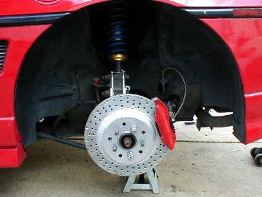

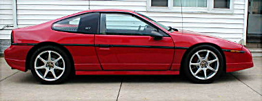

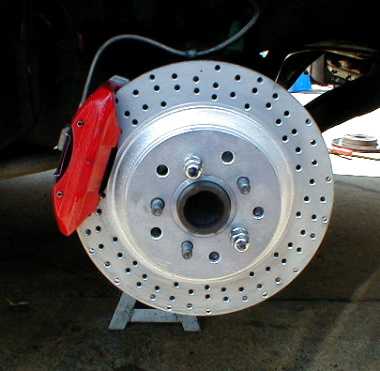

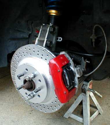

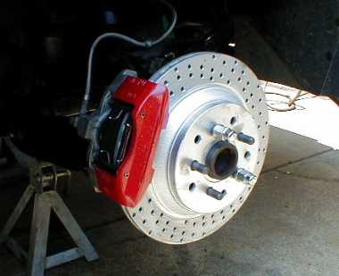

Here are pics of the results of my install with my WCF 12" brake upgrade. Along with this I also installed Porterfield R4-S pads and Motul DOT 5.1 Brake Fluid. It is a carry-on of this thread https://www.fiero.nl/forum/Forum1/HTML/029883.html
Heres the pics:
Front:
Rear:

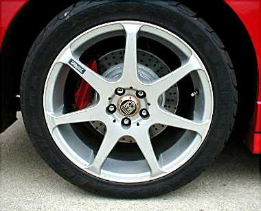

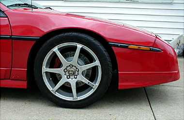

Report this Post06-09-2003 07:58 PM Click Here to See the Profile for AkursedXSend a Private Message to AkursedXDirect Link to This Post
More pics

Well I have only driven the car around the block so I have not been able to gain much of an opinion yet, but there are a few things that I can say about the install.
First, they look great, this is definietly a goog looking mod for those of us with large rims.
I feel like I have more pedal travel then what I had. I think it might be more to do with the fluid than anything else. But it definietly does stop well, better than what it did before.
As for the install, it is very easy, everything fit the way it was supposed to. The only things that were unexpected were that I had to remove the dust shields in order for the rotors to fit without rubbing. I probably could have bent them back, but they still would have been too close for my liking. It will probably breathe better without them.
Also, I had to adjust my parking brake cable because of the shift in the rotor.
Those are about the only two things that were not expected, but were easy things to take care of.
Overall, I am pleased with the install and the results.

I like. Were those rotors plated or painted? Seems to me that some of the holes from cross-drilling are awfully close to the edge of the rotor.

The holes in the rotors... do look really close to the edge... i wonder if they would be ok... and not WARP!

Your gonna LOVE that upgrade............If you want a little stiffer pedal, try swapping the master cylinder with one from a 95 full size chevy truck.
I painted the rotors with 1200-degree silver paint so it'll prevent rusting somewhat.
I know a few people have mentioned the drill-holes cloes to the edge of the rotor. They don't look as close in person as they look in the picture, but as for warping, I will just have to wait and see. It wouldn't suprise me if I have rotor trouble down the road, but until my 87GT is up and running, I have been forced to take it really easy on this car because I can't afford to break down. But after that car is up and running, I am definietly going to have to auto-x this car to really see how good these brakes are.
I took the car out for a spirited drive this evening though and these brakes definietly stop better and fade is pretty much non-exsistent.

Looks good but won't the paint on the rotors melt off at high braking temps and contaminate the brake pads? I personally would never paint the braking surface of a rotor, that's a part you want to keep clean.
After painting, I cleaned off the braking surface of the rotor to prevent that problem. Everything else is painted over though.

Any way you could get a close-up of the fasteners? Mine did not come with them but if the ones I have look like yours I shall resign myself to contentment.
Kameo Kid
Posts: 2343
From: Cortland,Ohio
Total ratings: 132
Report this Post06-12-2003 12:31 AM Click Here to See the Profile for Kameo KidSend a Private Message to Kameo KidDirect Link to This Post
another take on fasteners, I used a metal one the was rubber coated on the part that goes around the stainless line, but I cut a piece of vacuum hose to put around the line first to keep is snug inside the clamp.. worked out fine.. I didn't like the nylon due to some slipage and didn't think it would last.. I may be wrong about the nylon but the metal ones gave me a better install
fierogt88
Posts: 1243
Registered: Oct 2000
Total ratings: 100
Report this Post06-12-2003 01:28 AM Click Here to See the Profile for fierogt88Send a Private Message to fierogt88Direct Link to This Post
Where did you get the metal? The autoparts stores here don't have them on the shelves and the high school dropouts behind the counter only offer blank stares when asked.
Kameo Kid
Posts: 2343
From: Cortland,Ohio
Total ratings: 132
Report this Post06-12-2003 08:38 PM Click Here to See the Profile for Kameo KidSend a Private Message to Kameo KidDirect Link to This Post
I got them from a small hardware store in the next town, but you may be able to get them at a Handyman Hardware or some place like that.. If you can't find them there send me a PM and I'll see if i can get you more info on them..
[This message has been edited by Kameo Kid (edited 06-12-2003).]

First off, DAMN THOSE BRAKES ARE BIG!
Next, what is the minimum wheel size that is required with those brakes?
17" wheels minimum, there may be some 16" wheels out there that may work but that would really be pushing it
