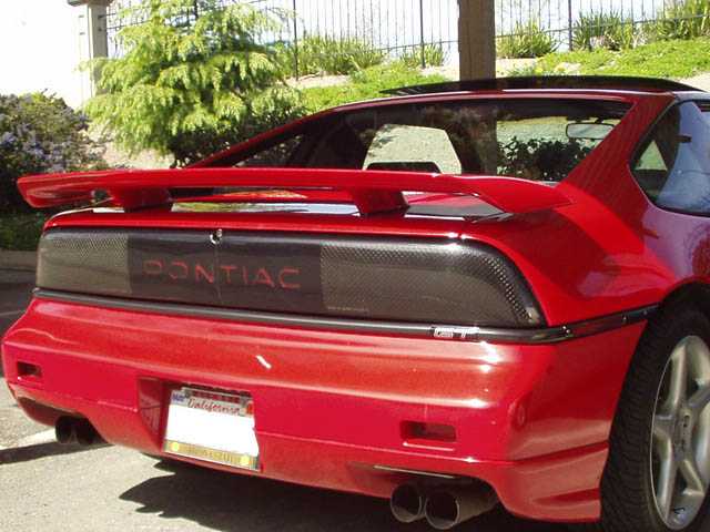

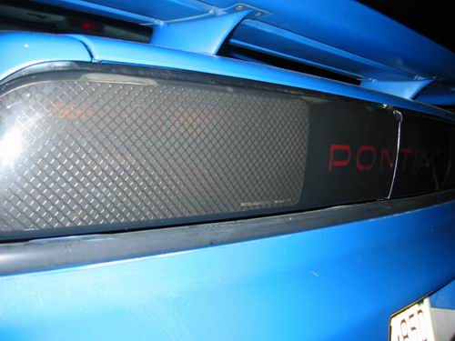

You like?
If so I'll be posting how I did it in the tech section later today. Total cost: less than $10

very very nice. How do the lights look through them?

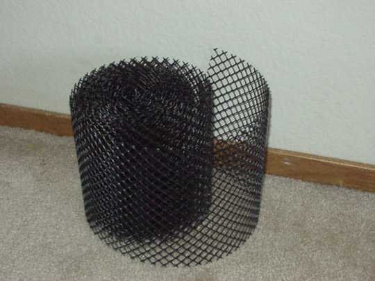

It is gutterguard!
Sold at any hardware store, $2 a roll. Black shiny flexible plastic screening which is the perfect width for the inside of the clear plastic GT tailight lens. Cuts with a scissors and easily conforms to the curve of the lens.
I had the inside of my lenses tinted for a long time, but after a while the tint started to turn purple like all cheap tint film so it had to go.
Just guttergard alone looked ok, but it didn't give the blackout look I was goin for. I also got some sheer black polyesther fabric from a fabric store. Like $5 for a yard.
I cut the guttergard to the size and shape of the inside of the clear lens, a little big on all sides so you can't see the edges from the outside.
Then I streched the black fabric over the lens pod and snapped the pod back in the lens. It keeps the fabric tight streched over the colored lenses and gives a nice background to the mesh.
Fabric is sheer enought to let the taillights shine out, but in the light of day until you hit the brakes they look like blackouts.
The guttergard is very shiney so when the sun hits it over the black fabric, from any more than a few feet away they look totally like carbon fibre.

Thats pretty cool. I think it sorta has a carbon fiber look.

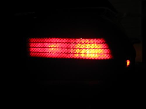

Colored lenses are still in there. At night they look pretty much like the always did, except for the diamond shaped mesh overlay.
I got the idea from late model T/A's with the large honeycomb mesh over the tailights. That would look bitchin on the GT lenses. This was as close as I could get for now. I haven't really had a chance to inspect the T/A tailights up close, but it looks like that pattern might be painted on the inside of the lenses

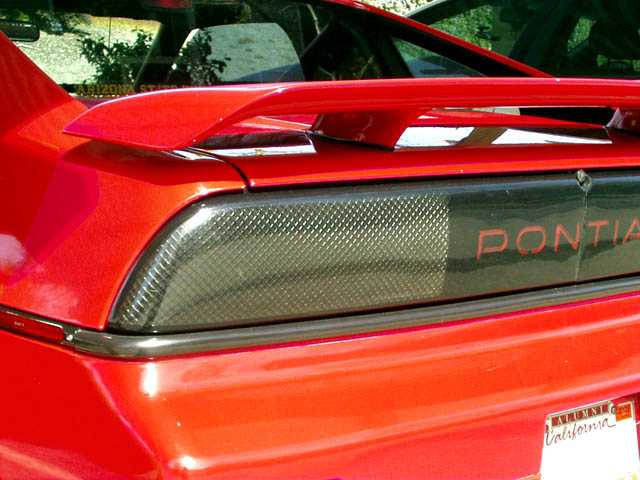

There isn't anymore to it than that. Light pods come out by 3 long screws. Inner pod and outer lens held together by plastic clips around the edge and some waterseal black goo. Unhook the clips and pull apart.
The guttergard is the exact width of the inside of the clear lens, you only have to cut it straight up on one end and along the outer down curve of the lens at the other. Cut it, stick it in between light pod and lens and push em back together. If you want to add the black cloth, wrap it over the face of the lens pod before you push it back together. The lens pod will hold the mesh to the inside of the lens with no kinks or wrinkle. Idiot proof.
Took an hour to do both

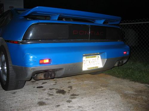

I just did this today, used 2 layers of black pantyhose for the blackout

Guttergaurd goes directly under the clear outer lens. The nylons or whatever material you choose goes over the lightpod and under the gutterguard or you won't see the mesh.
