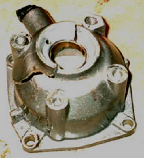

Well, I went to go pick up the fiero from sears since the alignment was done. I got home and the WRX was in the driveway so I pulled the fiero on the side of the road and moved the WRX. I drove my fiero to and from sears mind you. So I went to the end of my street and made a u-turn as I was about 80% done with the U turn I got on it a bit. Just as the tires broke loose I heard BAMMMM! I heard a loud clunk and saw smoke. I shut the car off and put it in park. Well its 9:30pm so its too dark to see what happend but the ATF all over the ground wasnt good. So I went up the street and got my floor jack. Lifted the car up and the pass wheel was locked solid. Me and a few people pushed the car up the street to my house and into the garage. I took the wheel off and this is what I found:
Part missing was still in the trans
Seen here

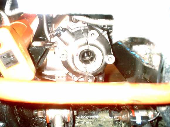

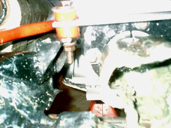

Twisted my front engine mount but lucky for me, the engine block wasnt damaged
But, it did damage the end of the trans. Good thing is that it is replaceable w/o pulling the trans
removed

So here is the big question. Why did it break? Nothing was loose as far as motor/trans mounts. I didnt notice or hear any binding while building it or driving it.
The axle is a stock fiero manual trans piece. I am pretty sure it is out of my GT from b4 the swap but not sure. Think it was just ready to die or what? I really need to figure this one out.

This sure doesn't look like a very robust part design for the halfshaft output on the trans case. What trans did this come off of???

It's hard to tell from the pictures as to what failed on the CV Joint itself that could have caused that failure. I've failed that joint on my car, but it's been the tripod roller to the shaft that failured at the shaft interface to the roller setup (didn't like too many 5 grand hole shots on dry pavement). That isn't the case on your assembly.
Really makes me wonder which failed first the trans part, or the Tri-pod assembly????

It looks like yout axle might be too short. It almost seems like it has to be for it to pull apart like that. Especially if all your engine/trans mounts are still in good shape.
It looks like the tranny might have been broken after the shaft pulled out and got wedged against the motor mount.

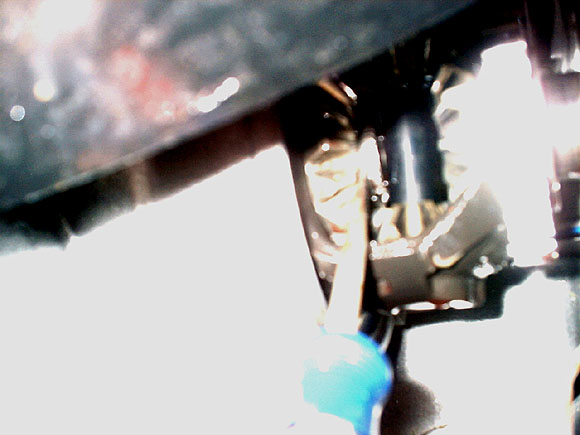

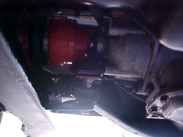

In the pictures, I do not see the metal support bracket the factory uses from the block to the end housing on the trans.
When I worked in the trans shop, I saw 2 of these broken on cars that had the bracket removed (to remove the exhaust manifold?).

You can see the black bracket in the 2nd and 3rd pic. The engine is mounted in 5 places.

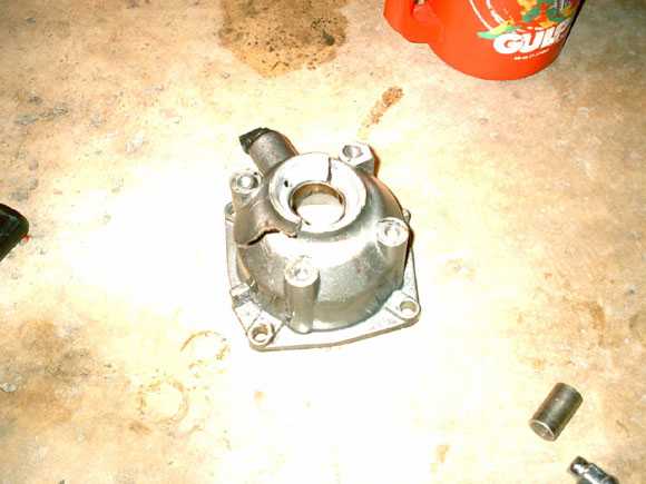

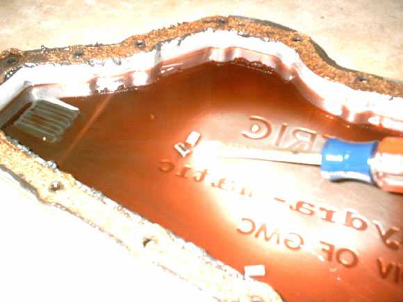

Well here is the latest pics:
These pieces in the tranny, tell me I need a new one.

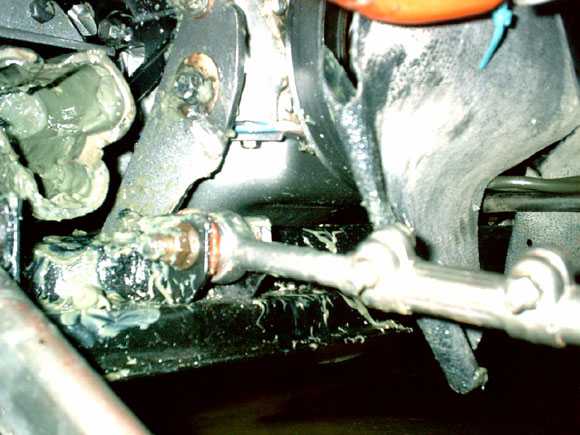

I know this pic is really hard to tell but this is whats behind the VSS end cover in my first post. The screw driver is pointed at a C clip that is half gone. Also notice that the splined shaft is touching the pin that the spider gears attach to. Not good

Well, it looks like it was the tranny, not the axle that cause the problem. Will know for sure wensday.

Did you blow the final drive? It's not uncommon but I've never seen it take out the side cover like that.
I tried to tell you it wasn't an axle problem. Get an LSD or quit doing donuts.
BV, When I did my fabrication for the '96 DOHC and the 4T60E, I retained the bracket that mounts to the end of the trans (4 bolts). At the time I determined that they added support between the trans and the motor and reinforced the strength of the case with that heavy bracket. I modified the orginal '87 from mount to connect with that bracket and used bolts to be able to remove the engine w/o removing the whole bracket assembly. I know your car is a 4.9 but did it originally use that bracket, and if so can you modify it to put it back in? G/L

Just got back from the tranny shop. Here is the deal. The tranny is "FUBAR". Even the case is broken. I am having a hardend "cage" and some other stuff done to it. They are also putting in some "booster valve" to improve the tranny's upshift and downshift response and firmness. I looked at the Phantom Grip LSD but I just dont have the budget for it this close to moving.
They are building me a new one, with 3.33 (up front 2.73) final drive so if you are reading this Rockcrawl, will I have to send my MEMCAL back to you?
