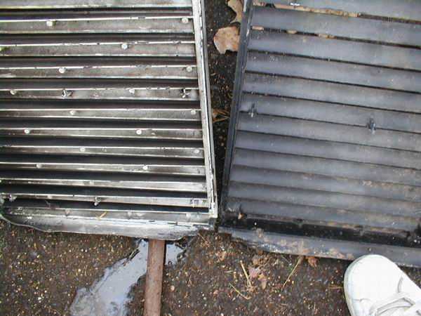

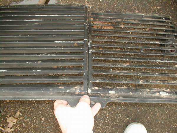

Orchidwild has her own '86 SE.. really enjoys the car she does (well, she will when I get her bent cluch pedal fixed)... But there are some things that just bothered her about it. One of those things were the badly discolored, chipped and cracked deck vents on the back. Tonight, she decides it's time to do something about it.
She had me do the rough removal of the old paint and primer..
The devil is in the detail...
She wet sanded the metal to give the primer a good base..
Rattle can primer.. gotta love it!
Finished product. Basically, Krylon semi-flat deep black. The pictures just don't do these justice. No runs, smooth as a baby's bottom. She really did an excellent job in painting these IMHO.

Notice I let him have a change of drinks in picture two

that looks great, but i think you put too much time/effort into it
a can of aircrafr remover would have done the trick, just spray it on, scrape it off, spray it on again rince it off with the hose and your redy to paint

GREAT JOB. I did this on my notchie and, let me tell everyone. This is no easy job.
The paint remover, as mentioned above, does not work that easy.
Perhaps.. but there were imperfections in the metal, dings, chips, etc that the mechanical removal helped to smooth out that chemical removal wouldn't have been able to do.
Besides.. I got to use power tools!

I refinished my 85 vents by bead blasting them. Took less than 30 minutes of easy work. Most machine shops have bead blasters and will do it for you for just a few bucks.
After beading, I hosed them off to remove the glass bead residue, let them dry, sprayed them down with white vinegar to remove impurities from the surface, dried them again, then primed and painted them with rattle cans. Been about 7 years now and they've weathered well.
