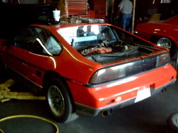

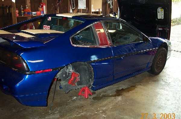

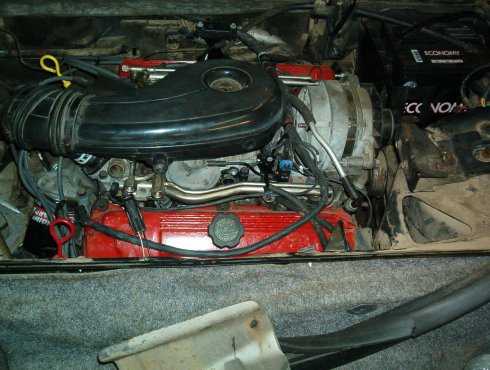

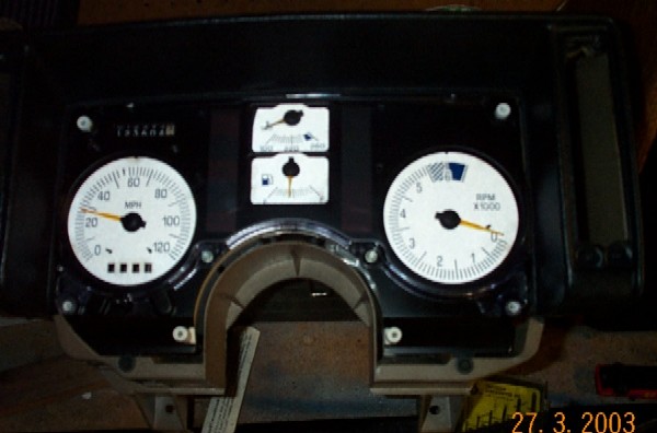

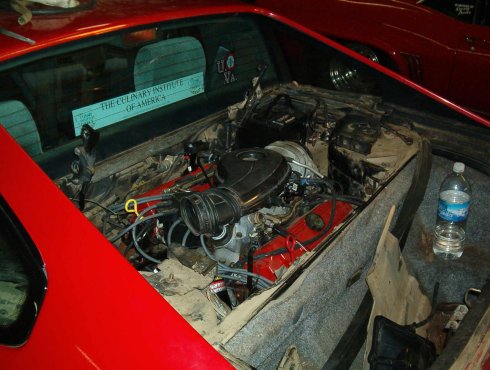

Well, things have been pretty hectic around here for the last few weeks with my best friend, Kenny, moving here from Germany and Bill moving down from Boston. The shop seems to be doing fairly well and I just picked up a contract to be an installer for a local high performance shop. Well I decided I have been looking at my personal ride for too long thats been collecting dust inside my garage. So I installed the white face guages I have had for about a yr now...... SOOOOO EASY! You dont have to take the needles off to my surprise. I removed the dash and most of the interior and swapped in the auto trans shifter, brake pedal (what a PITA), shifter cable and 4cyl throttle cable. I also got around to cleaning and repainting my 88 rear cradle. Maybe this weekend I will install the poly suspension bushings and start my Zettner front brake conversion.

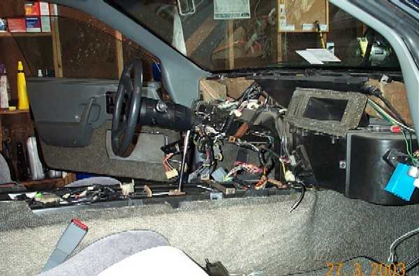

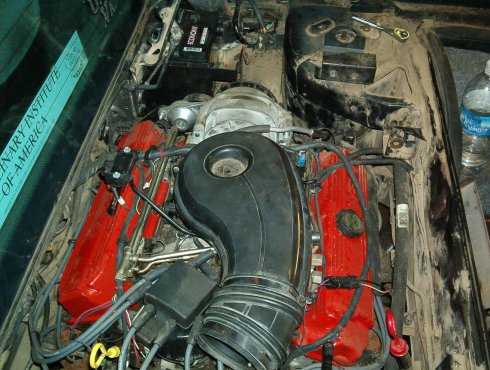

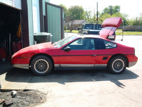

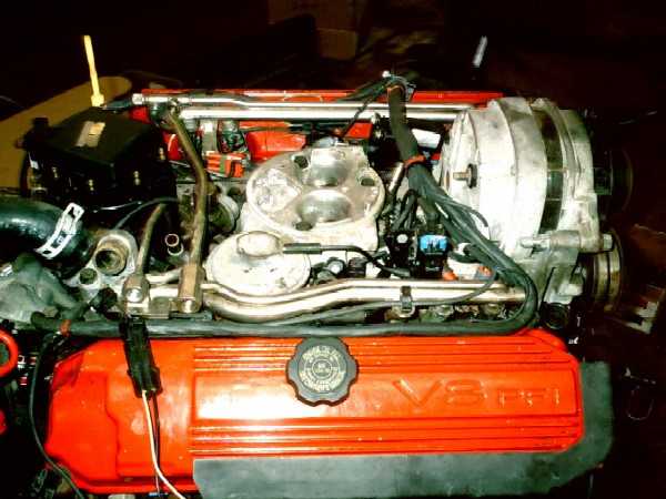

Jessie's 87 GT 4.9 conversion is coming along quite well. I have the engine mocked up on the cradle and installed the poly bushings in it as well. Ed Parks sent out the wiring harness and other odds and ends yesterday so that should be here anytime. So get ready Jessie, and buy some new rear tires now!
My 87GT
Interior (whats left)
guages
Jessie's car
4.9 on cradle
More later.

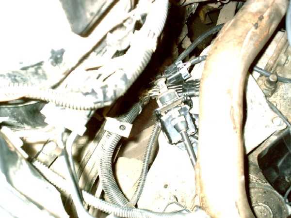

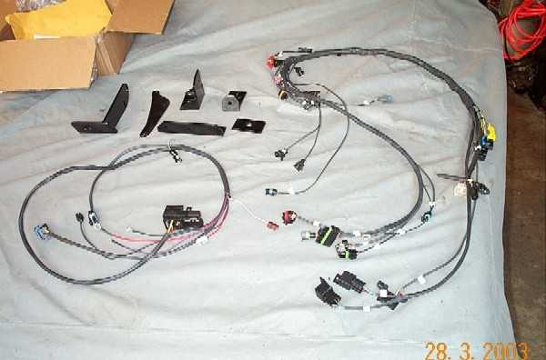

Just recieved the 4.9 harness and mounts from Ed Parks. Unfortunetly he sent the $275 mount kit instead of the $500+ one so now thats on its way now.

Looks exciting, the harness looks really nice too. Do the harness come with an SES light circuit, I heard a rumor that they do not? Just curious. Nice to see the pictures.

Man that looks awesome. Cant wait to take it for a drive. Ed took care of the problem with the parts order. He said the rest of the parts will be in the mail Mon.
Pete
If I remember correctly the original harness made by the Fiero Factory didnt have an SES circut. I have Ed's newest harness and I dont remember him saying that it didnt have the SES. Think I will have to call and verify. If it doesnt I need to figure out a way for it to have the light. I do remember Ed saying to diagnose the ECM the ALDL is functional with a Snap On scan tool.

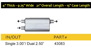

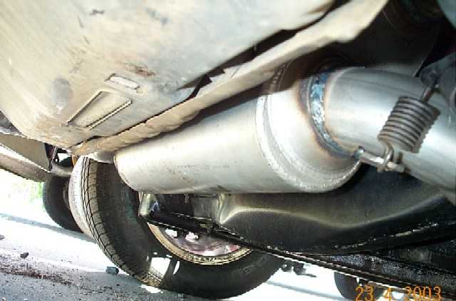

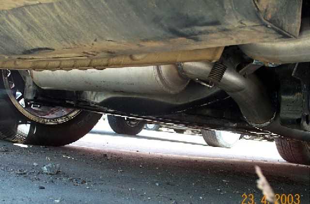

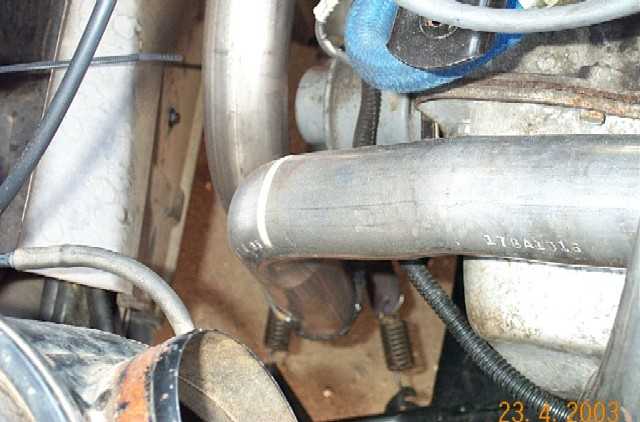

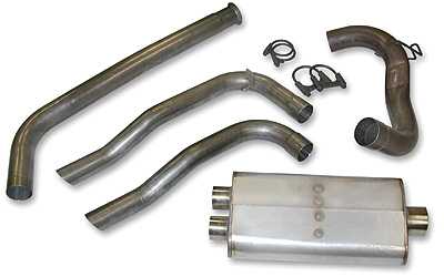

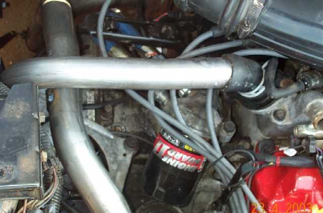

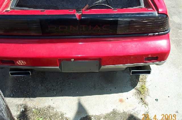

Check this out and let me know if you think that it may work. I dont know the measure of the stock muffler.
I like the 48083
LMK,
Jesse
BV MotorSports
Posts: 4821
From: Oak Hill, WV
Total ratings: 189
Report this Post03-30-2003 05:52 PM Click Here to See the Profile for BV MotorSportsSend a Private Message to BV MotorSportsDirect Link to This Post
Looks good. I like the one on top as well. Should be interesting to see what we can come up with for a nice free flowing exhaust. I feel the same way as you do, I am not cutting my car to make an engine fit. Losing the lower half of my trunk is NOT an option. Here is what I have to build my exhaust:
SLP Stainless Steel Exhaust Systems:
Are street legal in ALL 50 States.
Offer easy, bolt-on installation.
Offer fuel economy improvement.
Have mandrel bent 409 stainless steel, 3" diameter intermediate pipes and 304 stainless steel high luster tailpipes with round angle-cut ends.
Limited Lifetime Warranty.
Up to 25 additional horsepower and improved 0-60 MPH and 1/4 mile performance
Its made by SLP for the 3rd gen F-body. Obviously we will have to modify it to fit but I dont see a problem with that!

Report this Post03-30-2003 09:09 PM Click Here to See the Profile for rockcrawlClick Here to visit rockcrawl's HomePageSend a Private Message to rockcrawlDirect Link to This Post
I have the flowmaster 42583/43083 on two of my 4.9 cars without cutting the trunk. They are a very tight fit but they sound great on a V8.

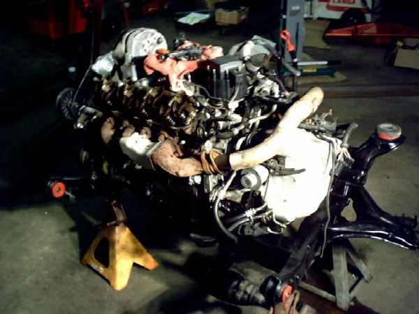

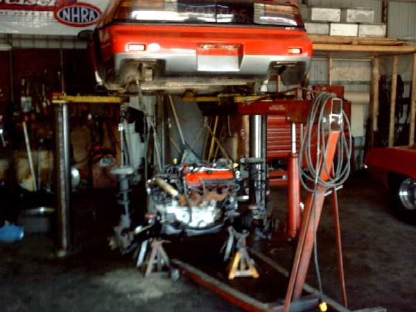

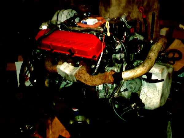

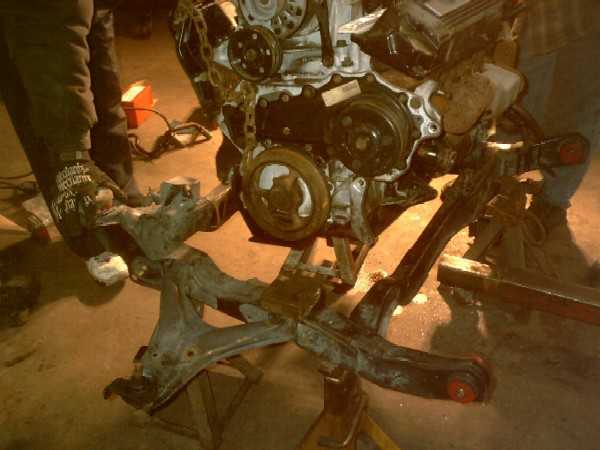

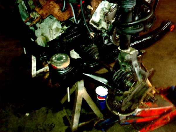

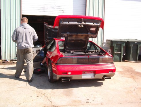

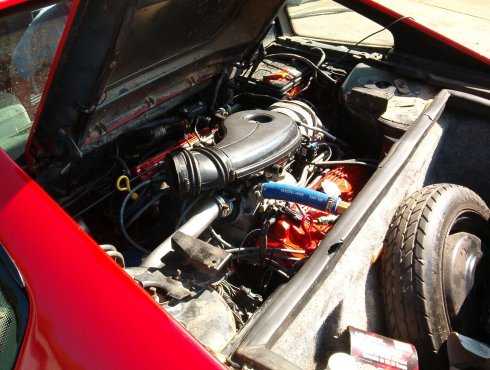

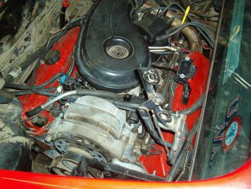

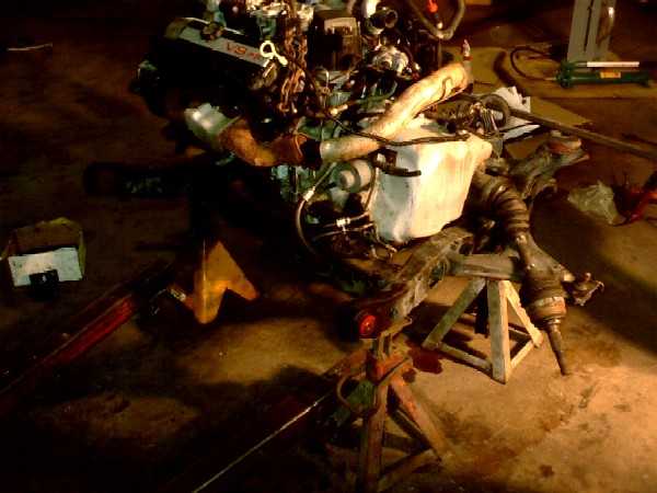

Today we started mocking up the 4.9/4T60e up on the cradle. Everything seems to be spot on with the Fiero Factory's install kit. Garth says if Ed Parks was around he would give him a kiss for building such a nice wiring harness for the swap! Guess he approves of Ed's work!!
Garth admiring the Fiero Factory's 4.9 install kit:
More tomorrow

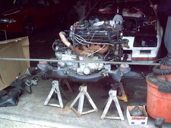

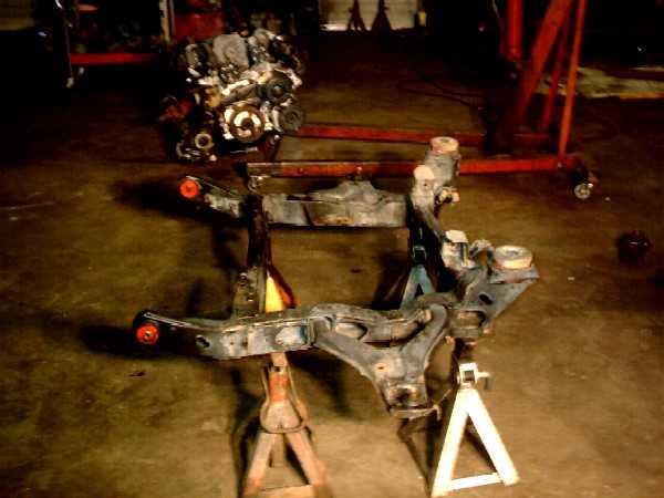

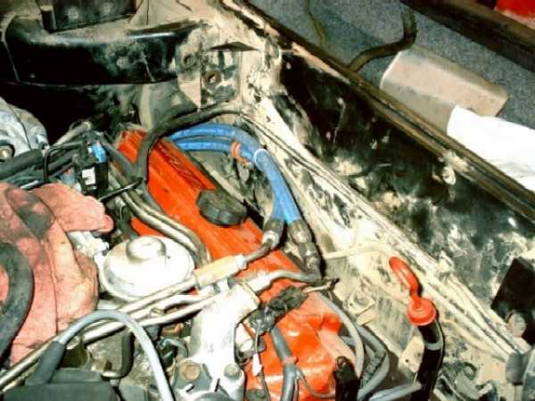

Newest pics:
Now to take it all apart to clean and paint. More later.

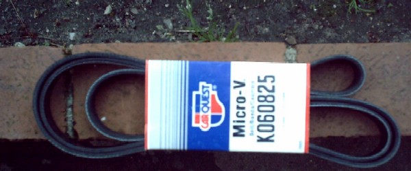

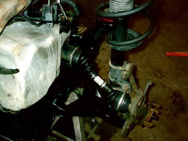

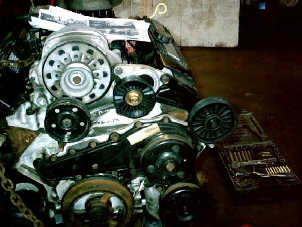

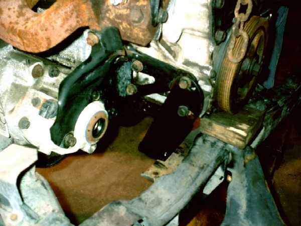

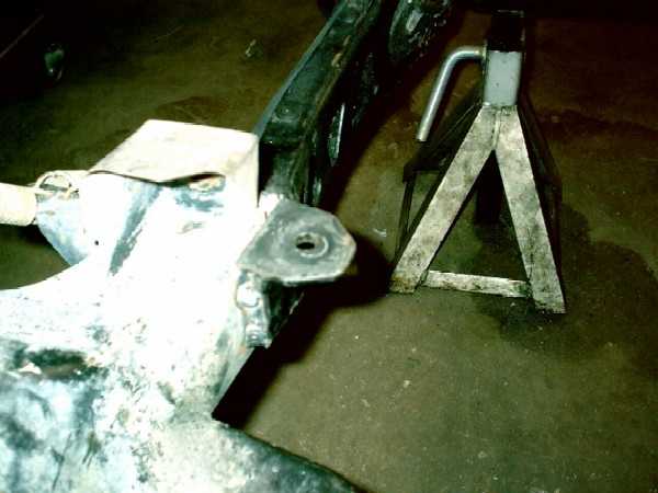

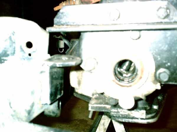

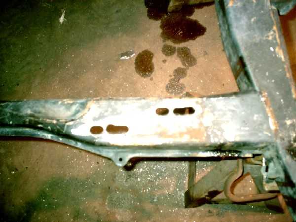

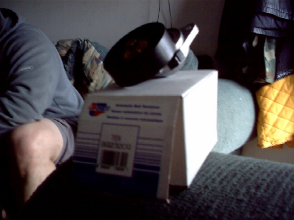

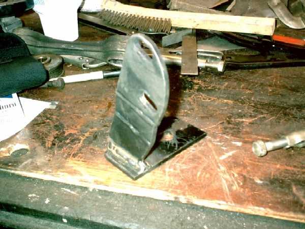

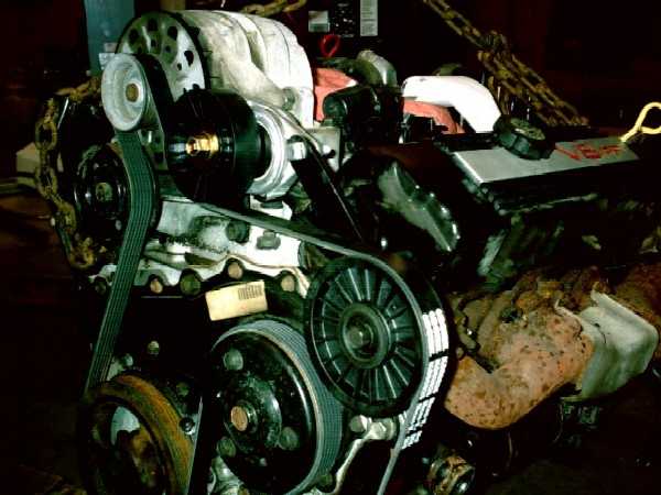

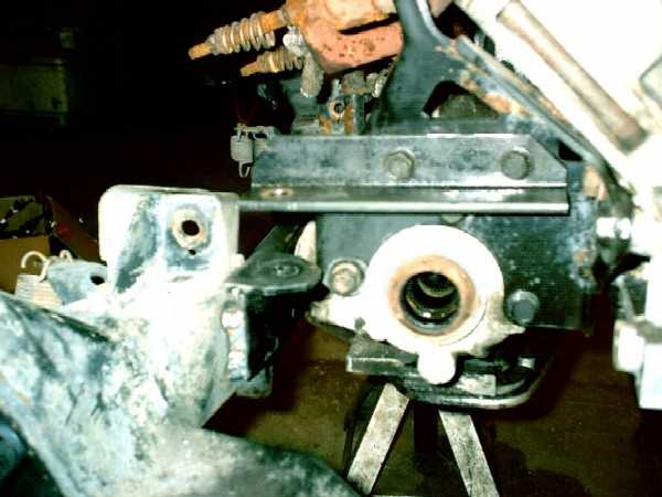

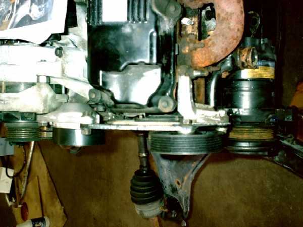

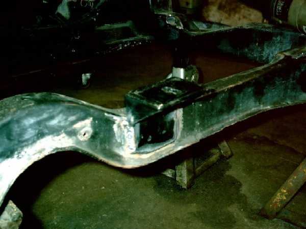

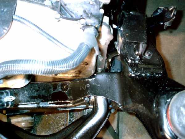

Report this Post04-07-2003 05:54 PM Click Here to See the Profile for BV MotorSportsSend a Private Message to BV MotorSportsDirect Link to This Post

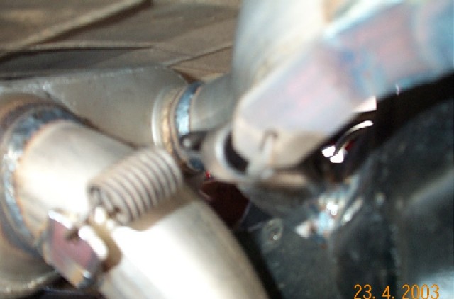

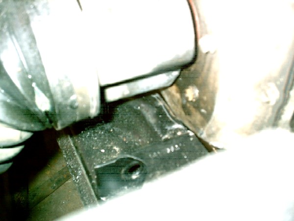

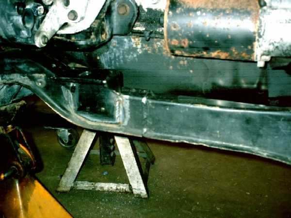

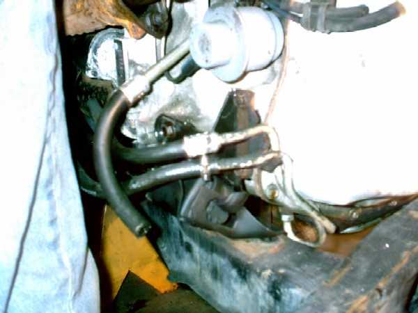

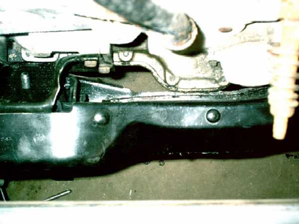

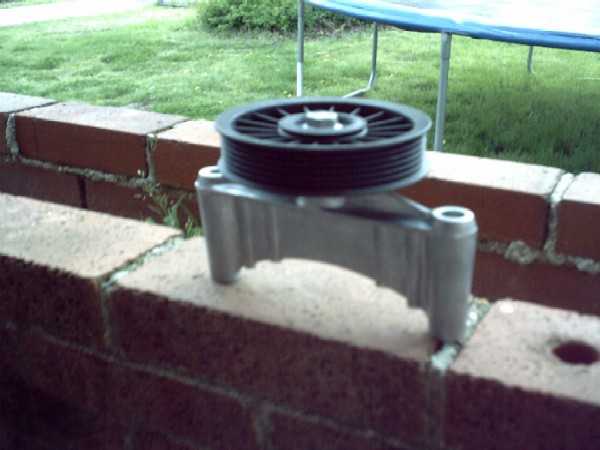

Well here are the newest pics Jesse:
Pass side lower engine mount
pass side rear mount
pass side front mount
trans support mount
serp belt/idler
We needed to modify the front lower engine mount the Fiero Factory supplied. I am thinking that they may have sent a 88 bracket instead of one for the 84-87.
We installed the serp and idler brackets and modified it till all the pulleys lined up near perfect. The cradle seems to be done so I have it here in my garage and I am cleaning and painting it right now. Should look really good. Tomorrow I paln on doing so cleaning detail work to the top half of your motor and swapping the PFI valve cover on.
More later.
Steven

Got some work done on my 4.9 swap as well. Since my 88 cradle was at the shop I borrowed Jesse's engine to mock up my mounts.
In the pics below you can see the two areas that need to be trimmed to clear the 4.9/4T60E. I also installed poly bushings into all the 88 rear suspension but silly me didnt think to take any pics. So I will get some after I clean and paint them.
First pic you can see the end of the trans pan is about 1/8 from clearing the pass side of the cradle.
Next the lip of the cradle needs to be trimmed flush then rewelded.
Steven

twodogjohnny
Posts: 163
From: reston, va, usa
Report this Post04-09-2003 10:55 AM Click Here to See the Profile for twodogjohnnyClick Here to visit twodogjohnny's HomePageSend a Private Message to twodogjohnnyDirect Link to This Post
The belt tensionning system is sweat!
Can you provide some details on the alternator bracket, and the pullys/brackets used?
Is part of that an Ed Parks creation, or is it all off the shelf?
-john
Racer_JT
Posts: 1419
From: Lynchburg, Virginia, USA
Report this Post04-10-2003 10:50 PM Click Here to See the Profile for Racer_JTSend a Private Message to Racer_JTDirect Link to This Post
Hey I bought some tips. They will be shipped tomorrow 2-3 days
E-mail from Brain
Hey,
How soon do you need the hubs? I will call/look around tomorrow and see if I can find a pair of used rotors, then it would only take me a couple of hours to machine them. Shipping would take 2 days, I use Priority mail. We can work out the payment details when/if I can find a pair of rotors.
Brian
Howd it go today?
BV MotorSports
Posts: 4821
From: Oak Hill, WV
Total ratings: 189
Report this Post04-10-2003 11:22 PM Click Here to See the Profile for BV MotorSportsSend a Private Message to BV MotorSportsDirect Link to This Post
-john
Its from Ed Parks but modified for a better fit.

Ok got some new pics for you Jesse
swapping out the valve covers
4T60e is close to the cradle
wired and valve covers on
Pretty much done just have to detail and install into the car!
Steven

Report this Post04-14-2003 05:25 PM Click Here to See the Profile for BV MotorSportsSend a Private Message to BV MotorSportsDirect Link to This Post

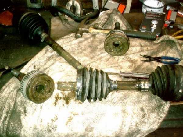

Newest pics for you Jesse. I should have the 4.9/4T60e installed in your car tomorrow.
1st pic, making axles:
Just about ready to drop the cradle
Steven

Report this Post04-16-2003 07:14 PM Click Here to See the Profile for BV MotorSportsSend a Private Message to BV MotorSportsDirect Link to This Post
Here are the newest pics Jesse. I vote your Fiero as the dirtiest fiero on the planet!
Jesse, the proud Pappa
Jesse taking a break (only after an hr of work!)
New trans bracket
new fuel lines
Steven

Report this Post04-24-2003 10:11 PM Click Here to See the Profile for BV MotorSportsSend a Private Message to BV MotorSportsDirect Link to This Post
Well, the car is pretty close to being completed. Turns out the ECM may be bad. Find out for sure tomorrow.
Custom Y-pipe
custom coolant pipe to t-stat housing pipe
80 series 3rd gen F-body flowmaster muffler (this thing is LOUD)
Exhaust is routed in the stock v6 fiero location but its tight!
Chrome 4th gen F-body exhaust tips
Steven

PBJ
Posts: 4167
From: London, On., Canada
Total ratings: 147
Report this Post04-24-2003 10:43 PM Click Here to See the Profile for PBJSend a Private Message to PBJDirect Link to This Post
Making some good progress, The exhaust looks well done.
BV MotorSports
Posts: 4821
From: Oak Hill, WV
Total ratings: 189
Report this Post04-25-2003 11:13 AM Click Here to See the Profile for BV MotorSportsSend a Private Message to BV MotorSportsDirect Link to This Post
Thanks, I am really happy with the exhaust. Now I just hope the SLP muffler will fit my car................

How much would you charge to make someone the custom "Y" exhaust pipe to hook up to the stock GT exhaust from the stock 4.9 Deville manifolds.
