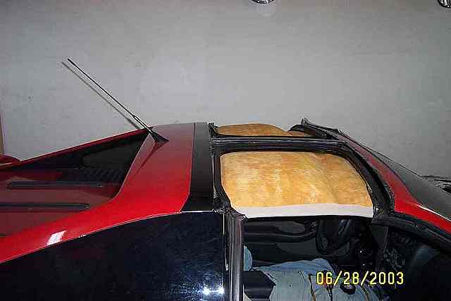

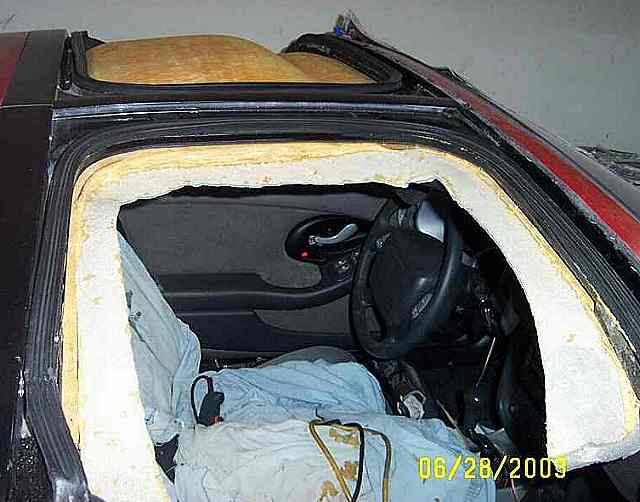

8/19/08 - This evening I began working on my T-Top headliner, I have a Full/non-sunroof headliner I bought from Wiccantoy years ago, and some really good front/rear parts from a sunroof one. I began by mounting the headliner backing board and drawing with a sharpe marker, the opening in the "T" Part just like jscott1(Major Props to him and his T-Top Thread) - https://www.fiero.nl/forum/A...0710-1-029407-2.html did:
(These Pics are borrowed from his thread)
I removed the headliner backing board from the car, cut the marked portion out, and then began to remove the old headliner material. Some of the backing was unusable so using the parts I had from the sunroof part I cut and matched parts together. I began Fiberglassing the board together using a fiberglass woven fabric this evening, and will continue it tomorrow morning, posting some pics of the progress.
