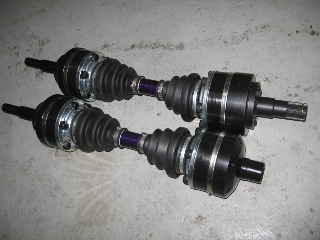

Just to let you guys know, I am currently working diligently on getting a 3800 swap "kit" on the market soon. I have had the mounts for years, but now I finally have a solution in the works for axles and as some of you have seen in another thread of mine am working out the details on a completely new swap harness. First off here are my axles.
I had these custom made by a customer of mine that I do a lot of powdercoating for. He has the ability to cut all of the splines etc and everything for the Fiero outer stub splines and the Grand Prix transmission splines are programmed into his CNC.
What I plan on doing is take brand new GTP axles, take them apart have the shafts cut off on the outer side to make them the correct length. Then take the Grand Prix outer stub and have it machined to the correct splines for the Fiero wheel hub. Next re-spline the shaft to the star of the outer stub, then reassemble the axle. What you will have is a swap axle thats a lot thicker than any Fiero axle you will fit in there, made of brand new parts at a reasonable price.
This is going to happen, I have a set of GTP axles sitting here that we are going to prototype off of and I will test them (in my car) to see how well they hold up. We may end up sending the shaft and outer stub to heat treat if we find the machining process takes away any of the temper of the parts.
Now we dont have a price nailed down on these but I will do my best to put them on the market reasonably priced as possible. I am just wondering from you guys that are doing swaps right now, if this is a feasible option for you rather than raping salvage yards and making huge messes in your garages trying to piece axles together out of stuff with 100k+ on it and may fail (I have failed enough axles to fill the bed of a truck, haha).
Let me know what you guys think, and if you are interested I can get you a set like mine also. They are made of 300M and are rated to 1000hp.

Looks like CV joints on both inner and outer??
No tri-pots?

Correct. There are no tri-pots, each side can move in and out though unlike the outer joint of a cv shaft.

I'm interested.. out of curiosity what would it cost for a set of the 300m axles like you're running?

I can get them to you for $1750

This thread isnt to try and sell my 300M axles. This thread is to show the capability of products I can have made, and the offer to modify GTP axles for swap use. 90% of the guys on here arent going to want to rummage through salvage yards and tear apart 4 or 6 axles to make 2 for their car. I am going to have brand new axles available to the market. Get your own thread.

You want the 300m ones like mine or the swap axles I'm having machined?
The machined swap axles, I like the idea of not having to piece together a bunch of parts from the junk yard I like the idea of new clean parts that will fit. The $5xx price range sounds decent to me for a such a limited/custom market.
as "bad" as junkyard parts sound, it is the easiest way to get OEM parts, period. Not to mention they are significantly cheaper.
I have built 5 or so sets of swap axles, each pair took me less than 5 hours, which involved me waking up, going to the junkyard and buying everything, then coming home and assembling in 30-40 minutes.
Also, the Porche axles can be easily modified, and you can get stock ones in the $150 each range.. So... Toss a set of adapters together and I have a feeling we could get somewhere for under 1000

Im not worried about darkhorizons input. This isnt a for sale thread, its just a feeler to see what I need to produce as far as a marketable product. I know there are a lot of guys on here that will go to salvage yards and find the parts they need and build axles that will work. But there are also a lot of guys that dont have the time to spend messing with it and would rather have a brand new product that will just drop in. Thats what I am here for and thats what I do at my shop. I have been working on a solution because I have received a lot of PM's and emails over the last two years that I have been selling my mounts asking for an axle solution. It has just been in the past few months that I have had the resources to get the axles built.
Everyone knows DH is the guy to talk to about getting advice on a solution on the cheap. He does have the methods of making a car go fast cheap. But in our business we have a saying that goes "Cheap Fast Reliable, pick 2". Thats the way it always works.
BTW, I may of discovered a little more cost effective solution that I will find out more on tomorrow. I will keep everyone updated.
