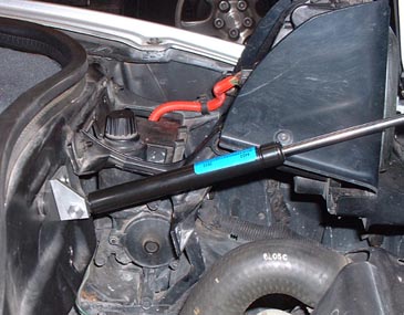

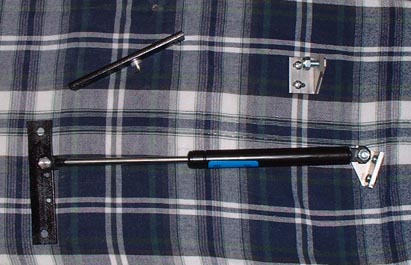

What you see is what you will get, minus the strut itself. Both single and dual strut kit’s are avaliable. When ordering the single strut kit please specify which side of the car you want to mount the strut (passenger side or driver side) All required mounts, bushings and fasteners are included as well as installation instructions
You will need to provide the approiate gas strut, both the single and dual strut systems use the same strut. I used the Strong Arm brand #4422. The strut is for the 1982-92 Camaro, Firebird, or Trans Am w/steel hood. Cost per strut is around $17

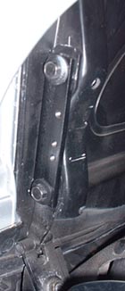

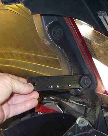

The strut mounting plate that attaches to the hood hinge has multiple holes drilled and tapped in them, this allows the strut to be mounted in different spots. The same strut can lift both a stock hood if bolted lower on the mount and lift a heavily modified hood if bolted higher up.

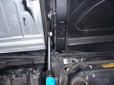

Installation does require drilling two 3/16” holes through the panel next to the headlight mounting bolt, It’s not the easiest place to get a drill but after the holes are drilled the rest bolts on. Also the radiator reservoir MAY need to be moved toward the center on the car to clear the strut on the passenger side. This can be done by slotting the mounting holes on the tank and bolting it back on.

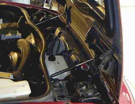

I received my set in today's mail - great quality... I may stop at the parts store shortly and pick up the gas struts (and if the weather is sparing, I may consider installing them this weekend as well).
Installed over the weekend. Took pictures, and will post as soon as I have a chance to upload. Well thought out design. Sluppy you did an excellent job and I give the kit a thumbs up, but I've got two recommendations.
1. To sluppy: The kit needs longer screws for the plate that attaches to the car frame. Lock washers should also be added. The ones provided were too short to accomodate a lock washer and the nut provided. I went to 3/4 inch stainless and used bolts with the nylon locking inserts.
2. To buyers: Print out the pictures Sluppy provided in the first post of this thread. The directions provided are fine, but color pictures are easier to read than the black & white ones included.
One other thing. As Sluppy said, space in the headlight area is tight and rubbing can be a problem. Rather than slot the coolant bottle hole to move it over, I used a grinder to reduce the height of one of the bolts holding the headlight doors.

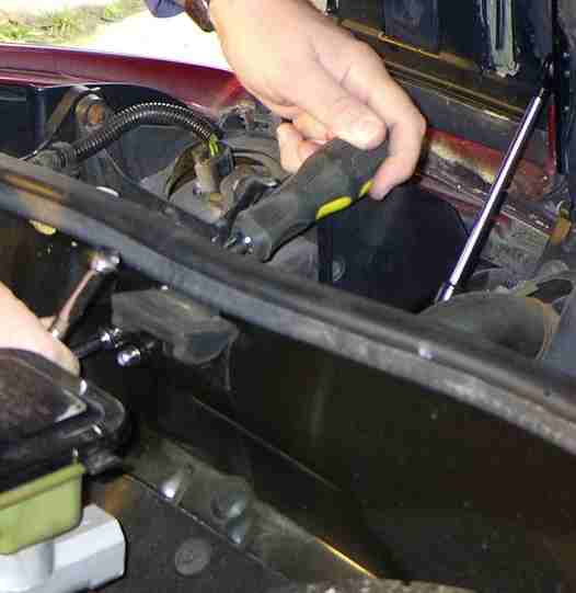

Got my kit today and already installed it! There were a few minor problems I ran into, but fixed them without much trouble. It takes a little effort to close the hood, but it's not too bad. Also, take sluppy's advice and hang on to that hood! If you let go of the hood while opening it, it will fly open! It took me about 1.5 hours to install this. Pretty simple, and you don't need any special tools. A few sockets, a wrench, and a drill were all I can think of that I used. Also needed a file to round out the holes a bit on the gas struts I bought. Much better than stock!
