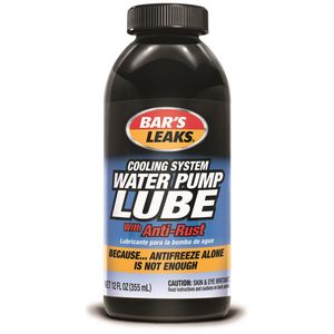

Most say anti rust and water pump lubricant. Do they lube anything useful, do they do any harm? I assume they dont touch the water pump bearing which is what usually fails on a pump.

They lubricate the bearings AFTER the seals fail (if they lubricate at all...).

If you run a proper 50/50 coolant mix, they do nothing.
If you run straight water, then you don't have the anti-rust additives in the antifreeze and the proection for the water pump seals. It's like adding octane boost to your gas. If you have enough octane already, it doesn't make any difference, but if you don't, it does.

Really the water pump's "lubricant" - if you want to even call it that - come from a standard 50/50 water/coolant mix. There's no need to do anything beyond that, and for many products out there the potential to diminish service life from standard usage is increased if you put these products in.

All the new anti-freeze ( inclluding the green) available today has less block protection in it that it use to. Dexcool is the worse. GM wanted the anti-freeze to last five years. In order for it to last five years, certain protectants were removed from the formula. Other car manufactures followed GM's lead. I have been a believer is water pump lube/rust protection for many many years ande it is necessary with todays anti-freeze.

Water pump lube are not really of any real value. Keep the antifreeze at the proper mix and change it when needed the pump will last as long as it normally will.
What kills pumps are generally the seals go out and often from belts that are too tight.
I had customer in the past use the AC WP lube and all I ever saw it do is make the hoses soft from oil in the system. Rubber hates this kind of oil.

Any lube protects the seal, not bearings.
BEARINGS does not see coolant. Bearing is a sealed set that needs no service.
Any coolant that meets GM and others current standards has lube etc to protect the seal in the formula. Adding more just wast your money.
The E or P Glycol does not wear out go bad etc. The additives and lube does "wear out" over time. Adding more to old/"damage" coolant is a band-aid fix. Damage coolant has little/no "rust" protection, even when new. Example Bad/weak grounds can cause damage to coolant, hoses, and allot more. (google: coolant electrolysis )
Running 50-70% coolant is allowed by most manufacturers. Only reason to run more that 50/50 mix is to get more freeze protection.
