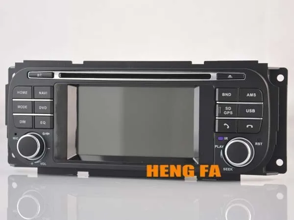

Looks close to fitting.

This one looks like it will cover up the hole without cutting a thing. Screen is hight adjustable up and down. Holes on back.
Also thinking it could sit behind factory bezel buttons would be accessable and might look better than any install if the case.

[URL=https://www.aliexpress.com/item/32730460295.html?spm=a2g0o.productlist.0.0.64a07a101f7Gfh&algo_pvid=ad65ac01-331a-4b09-8adb-023dc37c3d03&algo_expid=ad65ac01-331a-4b09-8adb-023dc37c3d03-29&btsid=0bb0624116158041293416002e4b20&ws_ab_test=searchweb0_0,se archw]https://www.aliexpress.com/...searchweb0_0,searchw[/URL] eb201602_,searchweb201603_
1.5 din bolt in. i bought a couple of car stereos this week so have been on look out for what fits same time.
