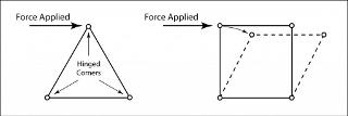

| quote | Originally posted by fieroguru: When all sizes are kept the same, the triangle jack stands will have 3 significantly less stable directions. Murphy's Law would imply those would be the only direction you would need to use them in.
FieroGuru, I noticed Europeans often go with triangle stands, which have been available for a long time.
Here's what I found from my research.
A square is capable of becoming a parallelogram. A triangle is only capable of being a triangle.
The struts of a square (or rectangle) are able to pivot around its vertices. Imagine a square held together with hinges. If you stood it upright and pushed against the top, it would lean to the side and eventually flatten like a pancake. The angles change but the length of the struts do not. The structure fails without any breakage having to take place.
Try the same with a triangle and nothing will happen. It is unable to pivot because the struts would have to lengthen to compensate for the change in angle. Its shape is rigid. Thus, a triangle will not fail unless the struts or connectors break.
Triangles have an interesting property.
Any triangle is completely determined by its side lengths (up to position, rotation and reflection).
This means if I tell you the side lengths of a triangle, you can find the angles (this is given by the cosine rule). Essentially this means the angle between any two sides is fixed, the triangle cannot deform without changing the side lengths.
Other shapes do not have this property. A square can be deformed into a rhombus with the same side lengths, without changing the side length.
This means a square will inherently have structural weaknesses at the corners, while triangles don’t.

You are focused on the strength of the triangle structure vs square (I am not disputing that the triangle shape is strong), I am concerned with stability when the triangle is positioned on its back and used as free standing base. You are assuming failure of the jack stand is due to leg deflection, I am saying jack stands can tip over (fail) w/o the legs ever being deflected.
This diagram below should clearly demonstrate my concern... this doesn't change based on which country, state, city, garage, or driveway it is used in.
The value of "X" in the triangle is 0.5774 of the "X" value for square or 42.26% less.
