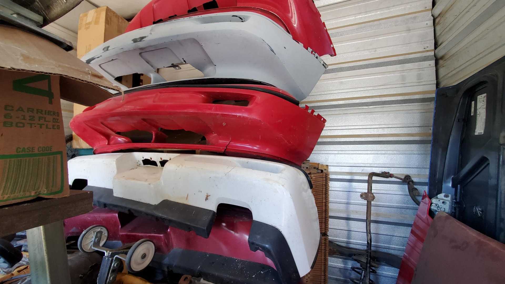

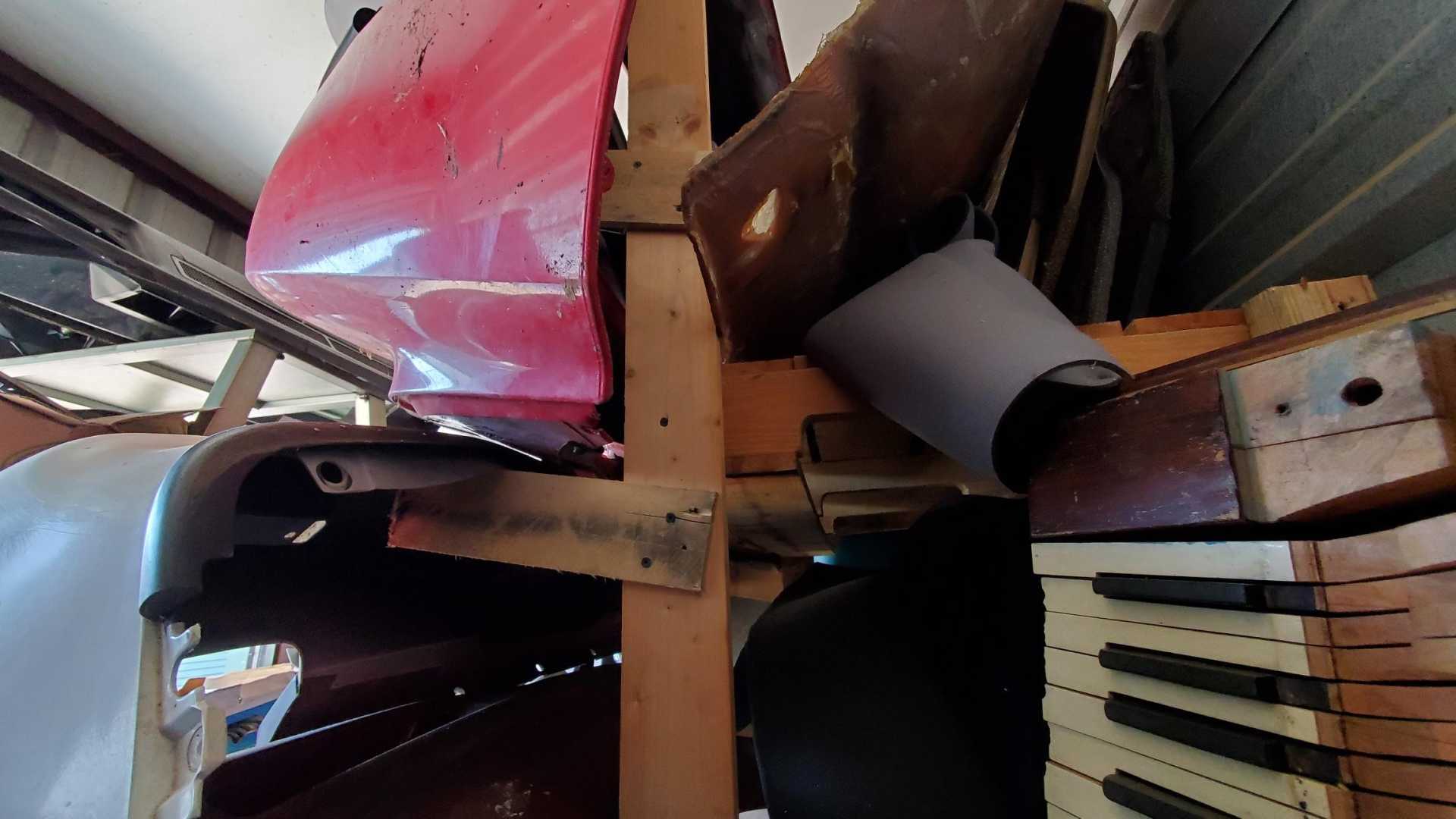

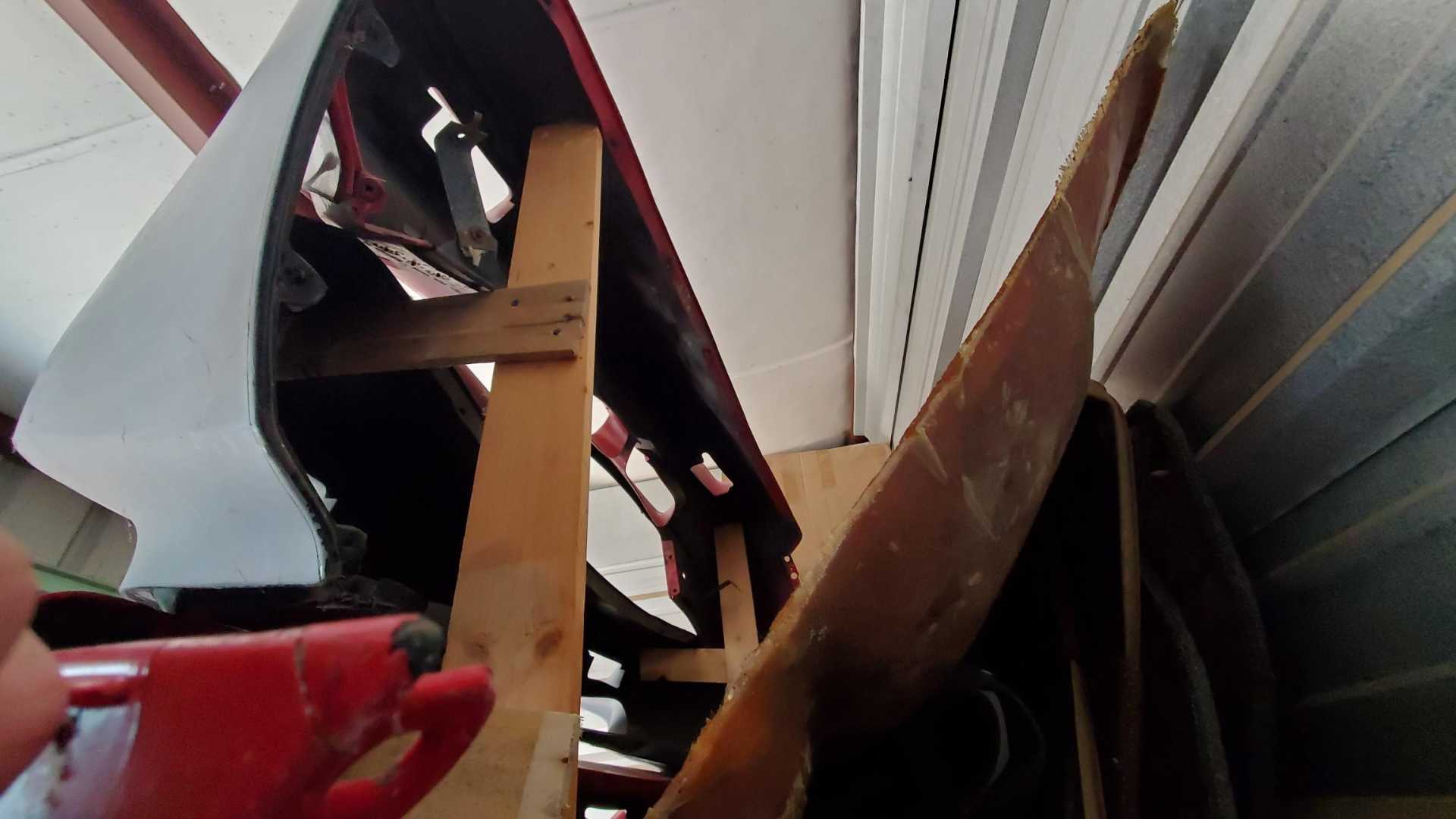

I put my extra fascias in my storage unit and wanted to get them off the floor. I made arms out of some 1 x 4s by cutting them about three feet long and screwing them to a set of wooden shelves at about a 45-degree angle. Two arms per fascia. They’re very crude but they work.
I’ll see if I can get over there and get some photos.

JUN 14, 09:34 AM

Knock off any corners etc on the wood or whatever. Avoid pressure where edges of plastic hits/folds and similar issues.
If the plastic get hot or not... corners hit small points for long term could cause problems. Plastic can warp where wood hits the plastic or areas are "heavy" w/o being attach to the car. Then can find very hard to remove any damage later.
