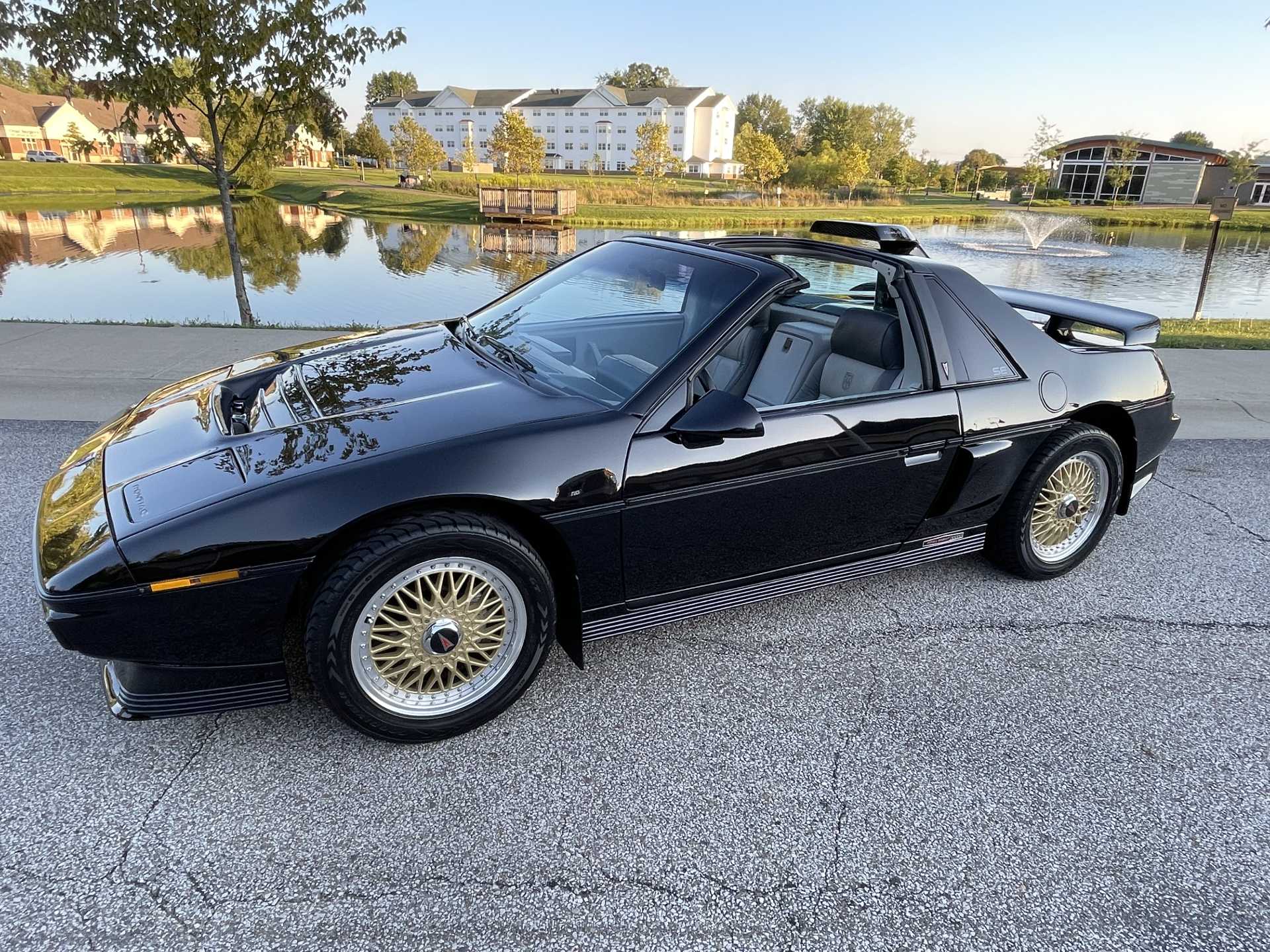

Here is what I have. The black panels are a good match the door and quarter panel are factoybthe hood and fender are painted. I know all paints look good in the web but this paint is actually better in person.

Wow that looks great!
