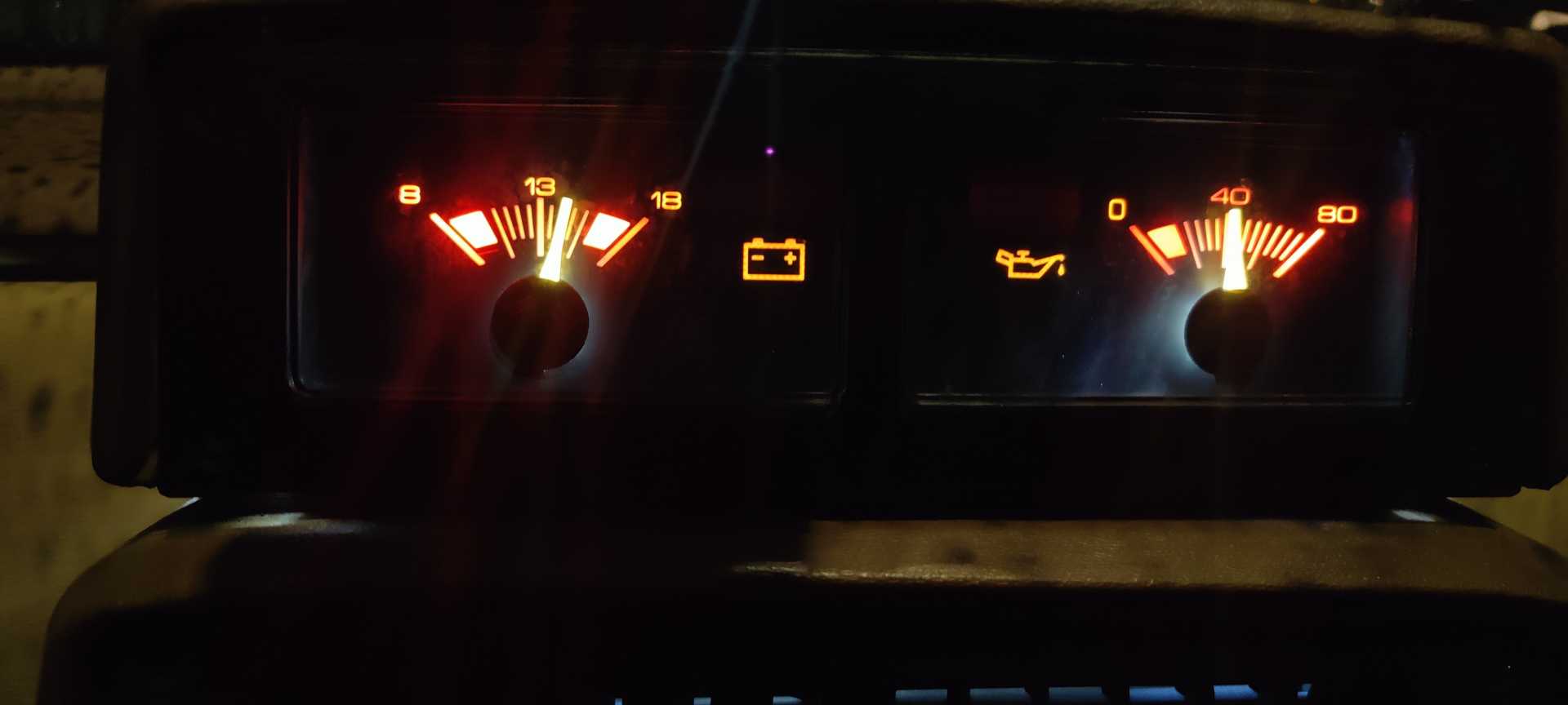

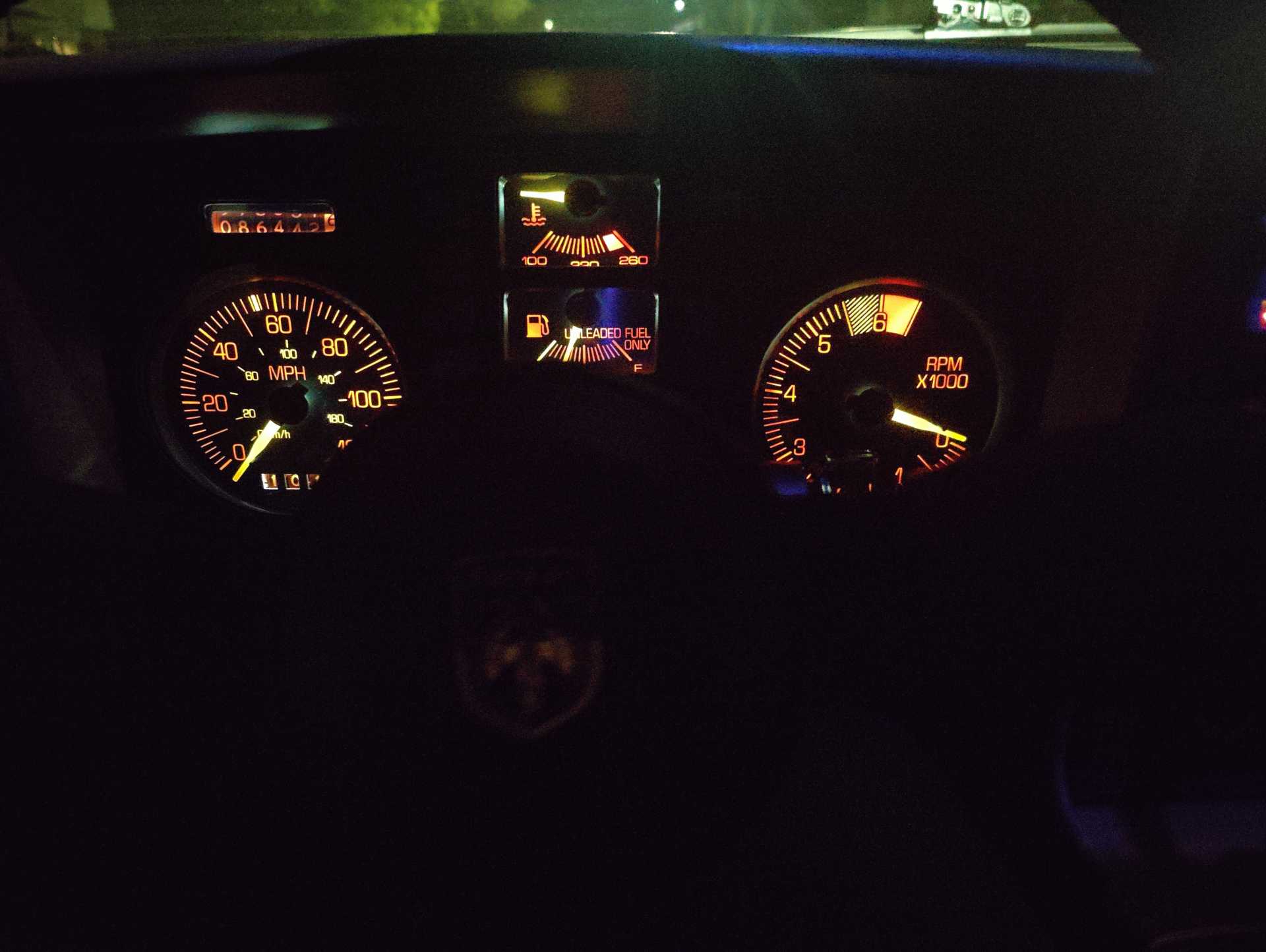

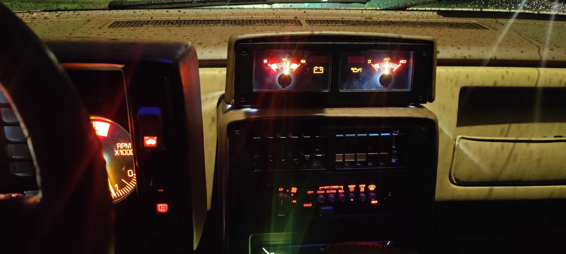

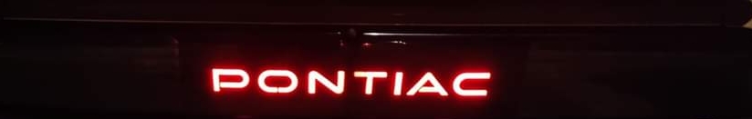

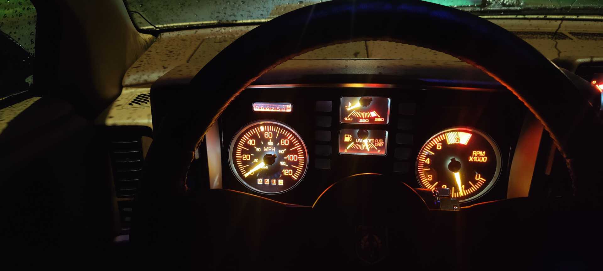

Replaced my rear logo, interior dash. Also replaced interior with LEDs I'll get photos and bulbs later if anyone wants to see what that looks like when the sun goes down. Photos don't due justice on how crisp they make it seem. Very pleased how it came out, kinda retro new if that's a word.
Tried a couple other colors such as blue, green, red, and orange. Green and blue straight up don't work you get blank patches that look horrible trying to go though the high and low voltage and high rpm where it's red.
Red is red and I mean really red way to harsh for me at night, if your into red you will love it.
Orange is just halogen just brighter that's it, makes the needle a little more orange then it's natural color of yellow.
White is the product you see in photos, most happy with.
Also yes the HVAC has a mini wedge led in it, did almost nothing compared to stock, such a small bulb not much can be done. Only the six dash bulbs are less the rest are still halogen since they are only on with blinkers or check engine.

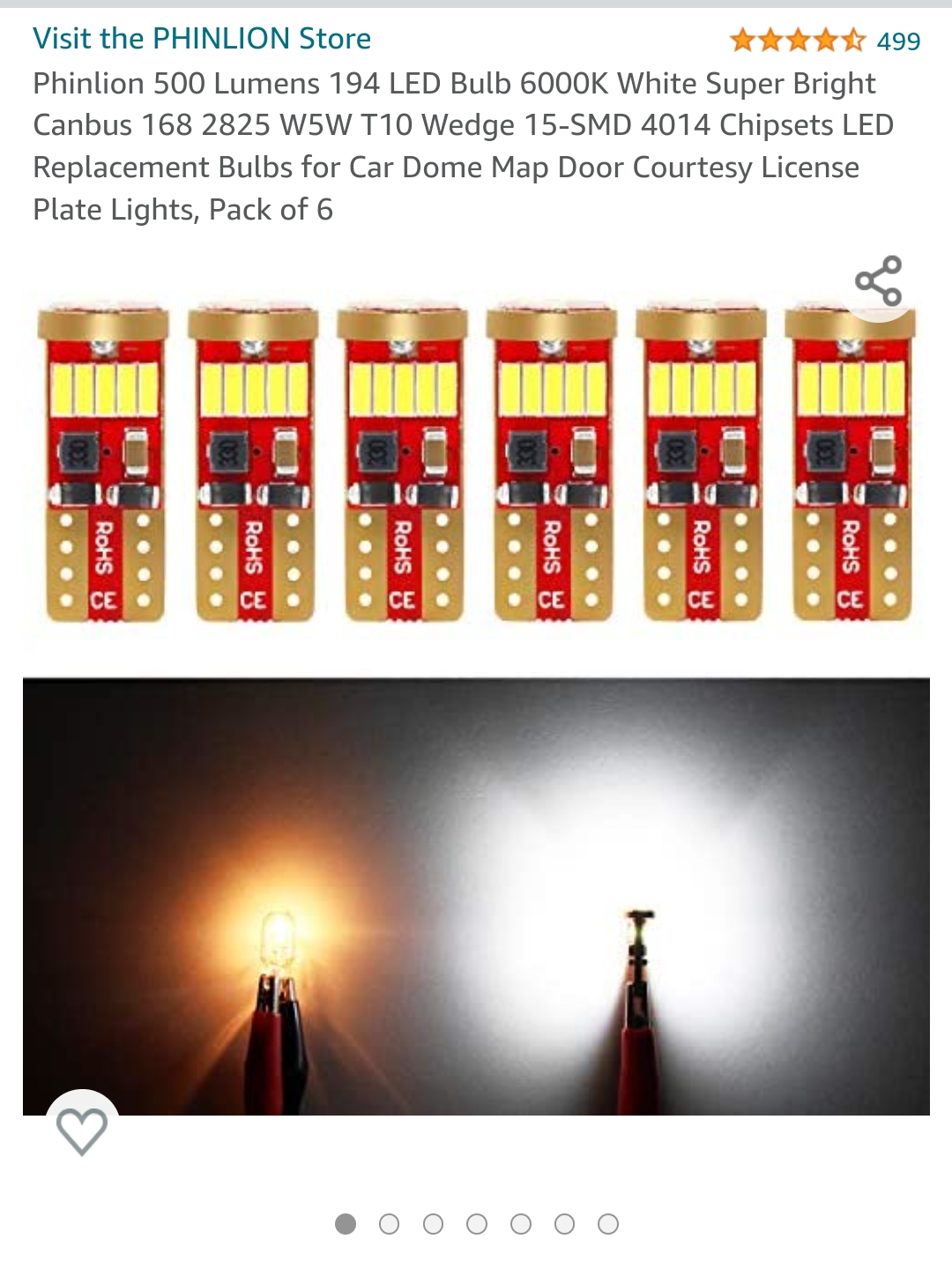

Here is the link of the bulbs I bought https://amzn.to/3EvQVbg
If link ever stops working here is a screenshot from Amazon.

Dang, that looks good. Way brighter than the leds I put in my cluster a few years ago. ------------------ --- 86 GT, my pride and joy (currently undergoing turbo 3.8 swap)

Plus this "Bulb" is "CANBUS Error Free" that often uses Load Resistors that Heats and eats power same or worse then the 194 bulb they replace. "CE Certified" means little even when not counterfeited but many falsely believe = to UL.
| quote | Specifications: LED Chip: 4014 SMD Voltage: 10~30V Color: 6000K xenon white Lumens: 500lm CE Certified
Features: 500 Lumens super bright Non-polarity design, easy to install plug and play Built-in constant current IC, wide working voltage Built-in canbus system, error free for most vehicles Gold plating design for better heat dissipation, longer lifespan |

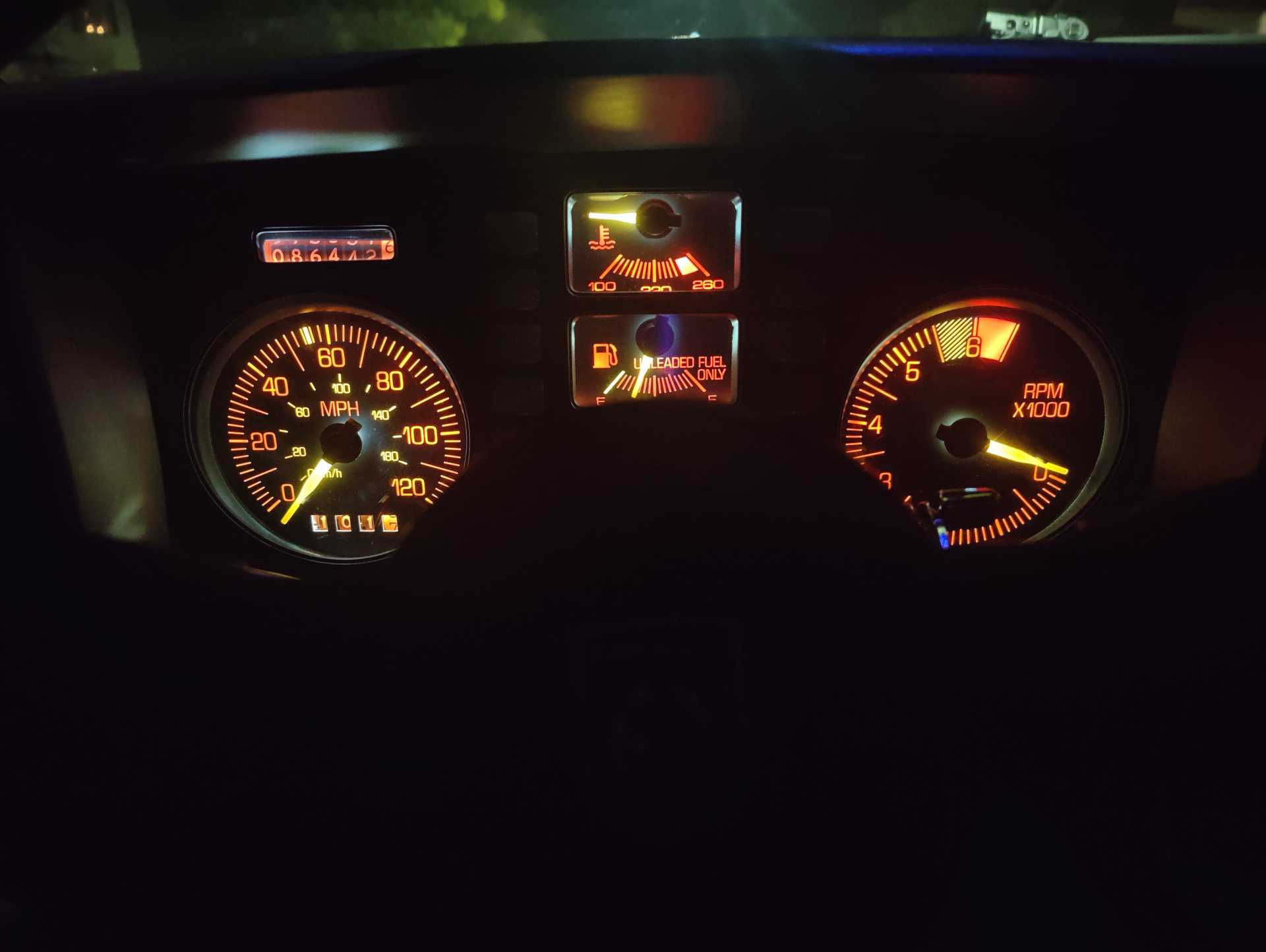

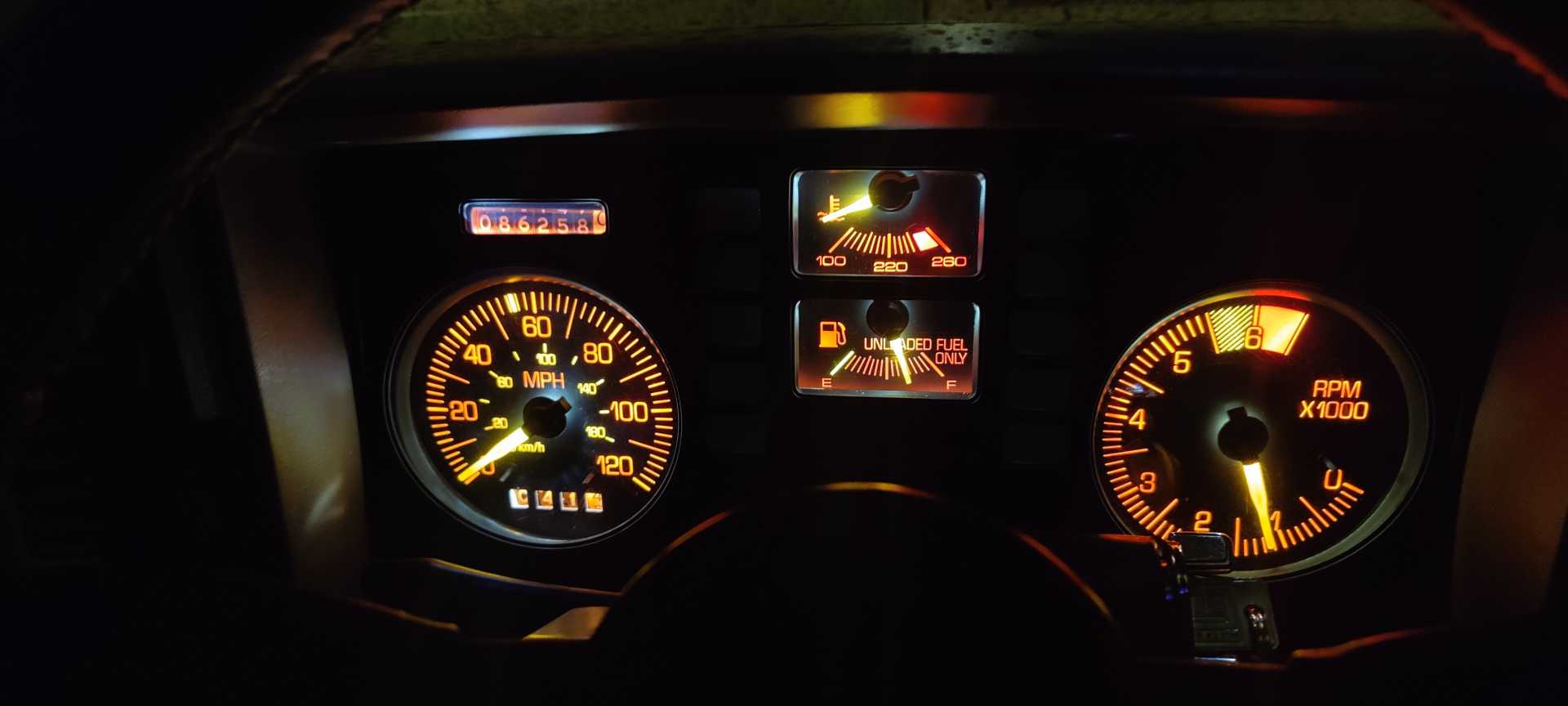

I understand you want to be safe with how bright the dash is. The leds in the dash are not overpowering to the point where its blinding. My trucks factory dash is still brighter then this.

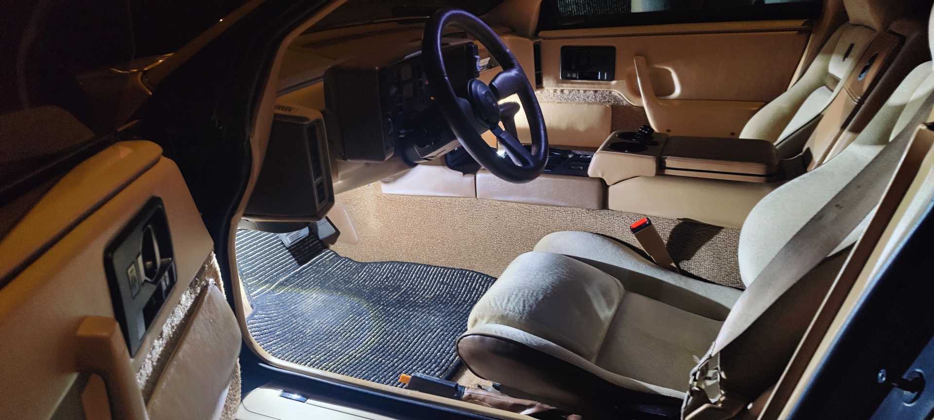

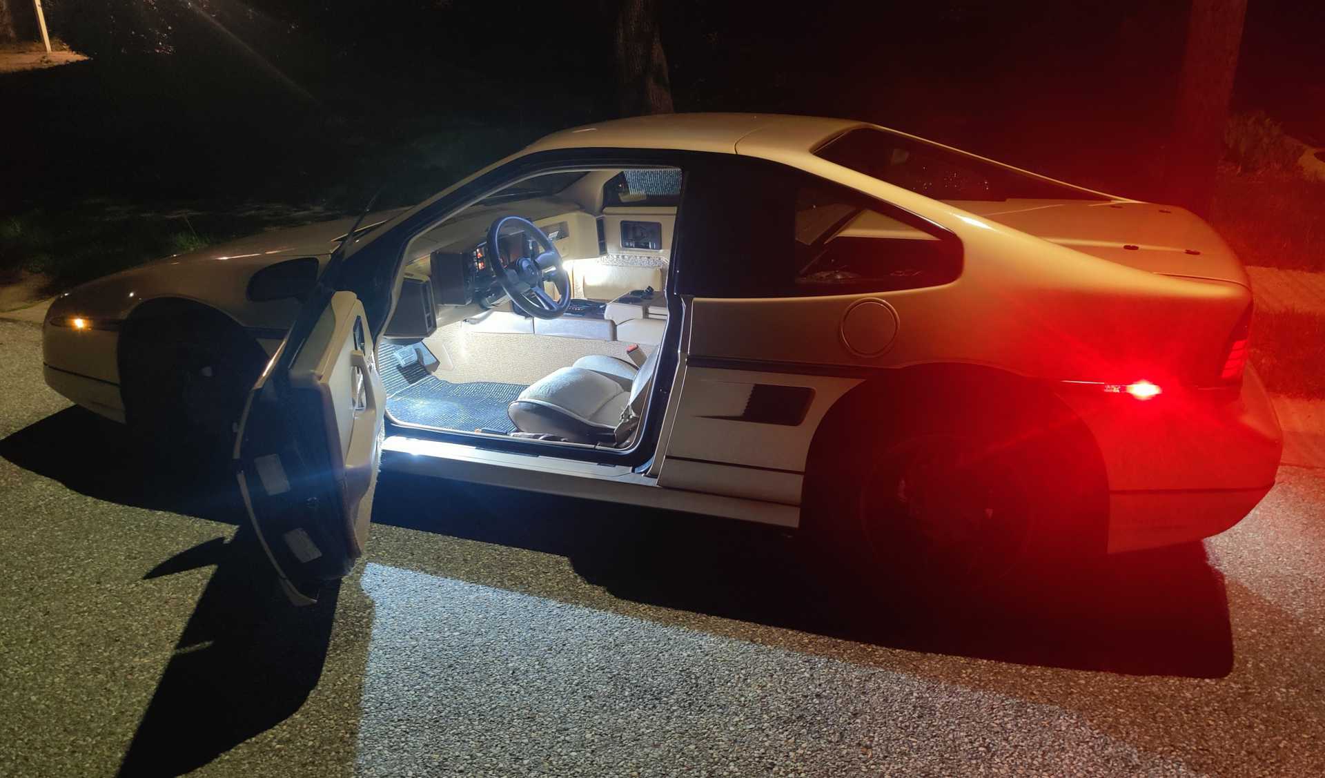

The interior flood bulbs however when I opened the door, yeah they are a little bright and oversized but they only turn on when I open the door.
The dimming is alright kinda goes in 25% ranges not a smooth transition if it was a higher end led such as GTR or Retrofitsource brand. The photos are a lot dimmer then my phone camera are making it out to be with the two photos I took of dimming.
Inside photo and the rear red markers are led, from what I rear you can't put leds in the front markers since they also work as blinkers it will cause problems. Haven't tried not sure if that true.

First photo is about 50% Second is 25%
