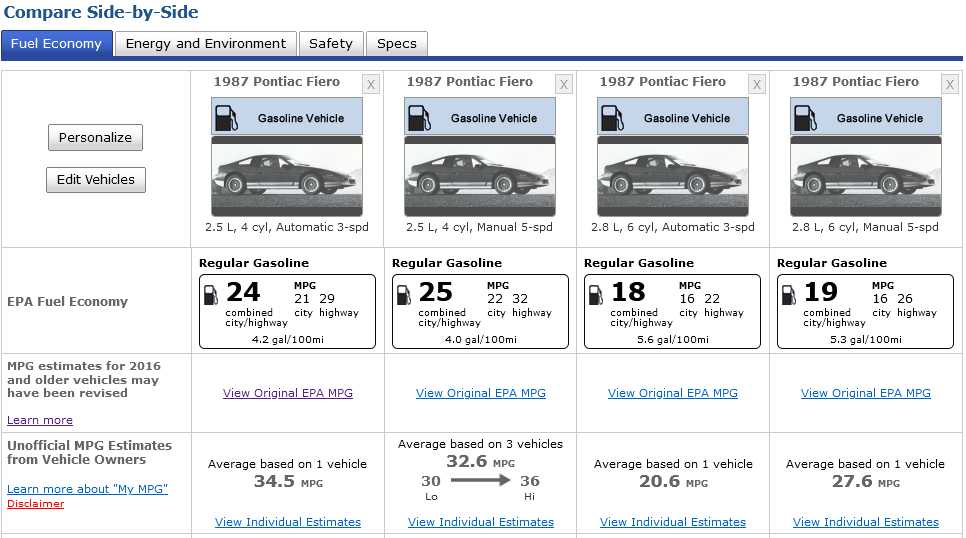

JUN 08, 11:47 PM
The only time I get close or exceed EPA numbers w/ Auto Duke is total highway for a long trip. Got 30+ a few times on Flat Roads. Otherwise the ECM won't keep TCC locked long enough so only get ~ 25 MPG at best.
Stick cars have similar problems... Not just in the city but often have to shift a lot in "hill county" etc. too. Is no fun dealing w/ heavy traffic or worse stop/go traffic. That later eats many clutch sets, more so w/ diaphragm spring pressure plates like many small cars have not just Fiero.

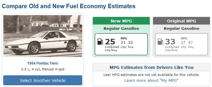

Can go to www.fueleconomy.gov to look up actual EPA numbers for 1984 and later. Cropped Image for 4 87 Fiero...
 But EPA change the "Rules" how the Estimated MPG numbers are made for 2008 and again in 2017. Not just Hybrid or E-cars. So Old numbers for Fiero in 80's won't match if "retested" or "adjusted" under current rules or match cars under them too.
So Click the "button" says "View Original EPA MPG" Examples: 87 Duke Auto New MPG is 24 combined 21 city 29 hwy but was 27 combined 24 city 32 hwy and what many doc's and posts still say. One 84 Duke Stick New MPG is 25 combined 21 city 33 hwy but was 33 combined 27 city 47 hwy
