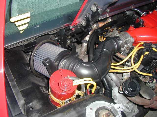

Patrick JAN 12, 07:13 PM
Here's a couple examples of poor cone filter placement. The first image is with a 2.8, the second is with a SBC.
Not only is hot engine bay air being directly sucked into the filter, but any water coming through the grill will fall directly on the filter element as well.

jelly2m8 JAN 12, 11:36 PM
The Op said nothing about putting a Cone Filter in the engine compartment. He specifically states where the factory air box would reside. He is correct, even with the wheel well liner in it does leave a huge open area. It's ideal for cooler air, but certainly not ideal for clean air.
The majority of us aren't stupid enough to put an Air Filter in the Engine Compartment if we are changing the style.
As you see, No air filter or box in the engine compartment
This images is larger than 153600 bytes. Click to view.
