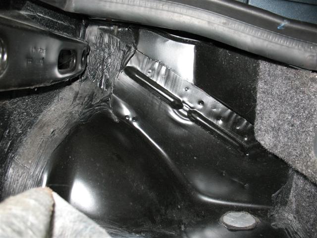

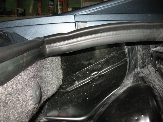

⚠️ Don't bother anything else until you find out rust is "Fatal" or whatever. "" Because of time/money to deal w/ damage or actual Fatal problems that can cause a wreck or Fail in a wreck because of rotted Crash/Crush Zone areas.
Don't know how NL Inspections etc are done... In some places, taking to a shop & they find bad rust problems can "void" the inspection cert right then & can't drive maybe not even drive to home. Side Note: Crack windshield may Pass Inspection in some places depending Where the damage is & just what the damage is.
Example: Pull the rear inner fenders & use camera(s) if needed to look @ upper frame sections. That part can rust big time w/o being obvious looking @ engine side. Many "fixed" that but most does so poorly & Fail in several ways including can Fold Up in a minor rear end hurting people in the car.
Other places, say rotted cradle or control arm(s), can be fix or replace but both will cost time & money.
If junked, first store it in rental space until you get another to swap parts if needed like GT taillights etc.
⚠️ You need to check if another has same or worse rust problem before buying it. Because Many got ripped off because plastic panels on many models not just Fiero hinds major rust & crash damage. A shop can put it on a lift & just look to start or use camera(s) like bore scope to look @ upper rear frame w/o taking apart inner fender.
