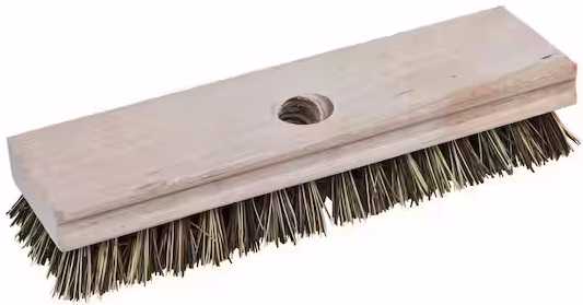

Cliff, I've found that brake cleaner is pretty effective at lifting oil from concrete. Despite its toxicity, it is an extremely effective, quick drying solvent. Depending on the manufacturer, it's also 1) pretty expensive to do a larger area, 2) not too good for the environment, and 3) highly inflammable. Use with care and a respirator. AVOID OPEN FLAMES OR OTHER SOURCES OF IGNITION.
I buy mine in 20-litre containers and transfer it to a pressure sprayer that I can pump up. It's also goof for knocking the grease and oil off of brake components and cool engines. After using it on my drive, I follow up with a good scrubbing with a stiff natural fibre bristled brush and undiluted Simple Green.

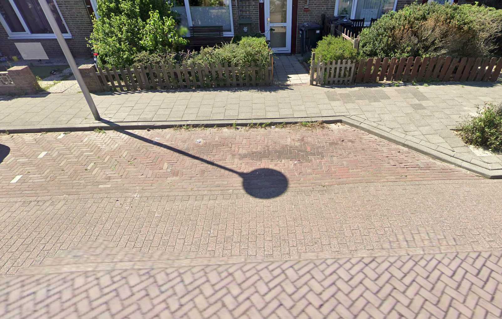

This is the space in front of my house:
This was actually a few years ago and it has gotten much, much worse since then. And not only this spot, but the spot on the left too (since those are the two spots I usually park in).

Again, May not be legal to clean that because is city property. Related reasons most cities will stop you trying to save a street parking space w/ anything. Unlike the Sidewalks in many places is "Your Problem" having dirt, snow, weeds, etc on/thru that or damage pavement or any other tripping hazard. (As many owners find out in many places now trying to charge an EV or Plugged Hybrid w/ cables across a sidewalk.)
If you do it anyway... Clay cat litter works but need way more time to suck up the old oil & people will hate this.
Using laundry soap & minimum water because others will see you cleaning. Or city workers or cops just driving by... Clean when pavement is warm so oil can quickly mix w/ soap. Use wet vac or old towels/rags to suck up most of the dirty water.
Very likely you won't get hours for the soap to work the best. A deck brush w/ long handle use sim to push broom puts more pressure on the brush may help work faster.
Any strong chemicals like carb or brake cleaner can be very bad news during or later if cops etc want answers. Even then if water for this goes down a storm drain near by not show in pic above can get you a ticket etc.
I'm surprise that someone hasn't called the city to complain about leaking old car spotting up several spaces now. Maybe have but didn't get time to check yet. Ignoring NYC, philly, etc that often never bother except maybe election years many other places in the US & more Will Tow a leaking car & often in minutes after complaint is calls in for safety & pollution problems. Other places slap a sticker to warn then tow 24hrs later. Or may just be where or how bad the problem vehicle is that the city etc could use either method.

Cliff, if you can just relocate that shadow a bit, the oil spots wouldn't be as noticeable.
