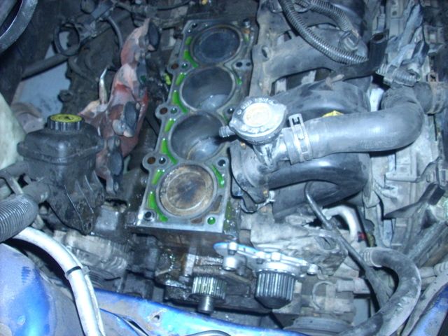

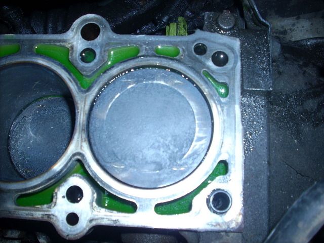

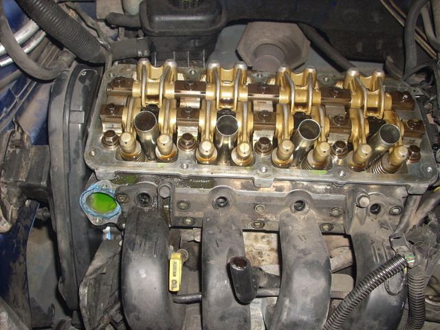

          | Is there a reason why I have to use these multi layer steel head gaskets instead of a composite head gasket? I see both types available on E-bay, but either I'm doing something wrong or these multi layer steel gaskets are harder to get to seal. I'm sure they are great once they've sealed, but for some reason I just can't seem to get one to seal. I can't imagine a rebuilt head being warped and when I put a straight edge to it it didn't appear to be warped and feeler gauges didn't indicate any warping. I know they originally came with the composite gasket which apparantly had a longevity of about 80k miles and the MLS gasket is suppossed to be around 100k. If that is the only difference then I'll get the composite that I'm used to using. [This message has been edited by Khw (edited 08-25-2012).] |  |

          | Make sure your straight edge is machined straight and no burs. I'm assuming its fine. So when you checked did you do it criss cross like an X from corner to corner and straght across in 3 spots? Both sides and the middle?
 If yes, then even though the metal llayered gasket is "better" go ahead and try the comp...
 Did you get new head bolts? They're supposed to be replaced. If they've been over torqed they might not tighten enough to pull the seal either.
 Forgot to say, check the deck of the block also. Especially for any nicks or scratches that affect sealing.

          | Yes I did a x corner to corner and across in each side and center. I checked the block also and didn't notice any nicks. I ordered a comp gasket, so I will check it again to make sure when I pull it back apart. I used a new set of headbolts, but I'll order another, since they are only around $25.00. Maybe it's a problem when I torque them down? In the past I've always had the torque to 20, then 35, then 55, then to so on until I reach the final torque number. This one it's the center 6 to one toruque number and the ouer 4 to another torque number in steps to 50 on centers and 35 on outer. Once there it's an additional 90o turn on each bolt. Is there a specific type of wrench that measures that 90o additional turn 1/4 turn on the bolts? I used my breaker bar but thought that just didn't seem right because all I could do was eye it and guess that was right near a 1/4 turn. If there is a wrench designed for measuring how much of a turn you put on a bolt I'll see if one of the local parts stores has one I can rent.
 Another question, is there a heat in time like on the comp gasket? If I remember correctly on the last comp gasket I did, I had to idle the engine for like 1/2 hour after putting it back together, then turn it off and let it cool to seal the gasket in. I did that with the MLS gasket, but it just didn't seal right.
