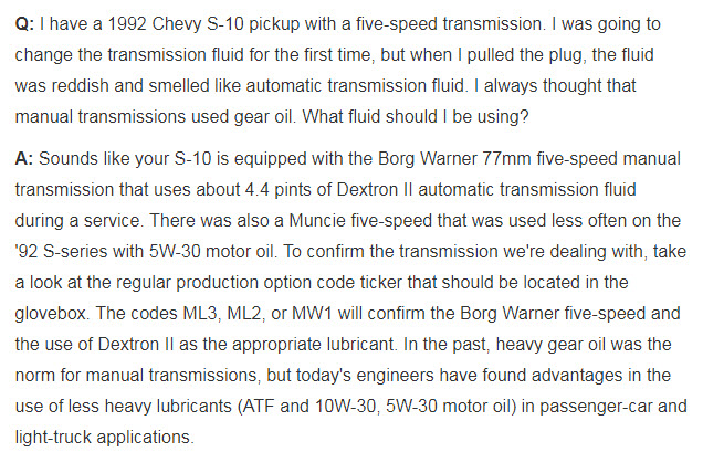

The Haynes manual says to use Dexron 2 ATF in the 5 speed MANUAL transmission in my 1992 S10 2.8 V6. Is this a typo or is this correct?

Hope this helps. It is from Motor Trend Magazine:
