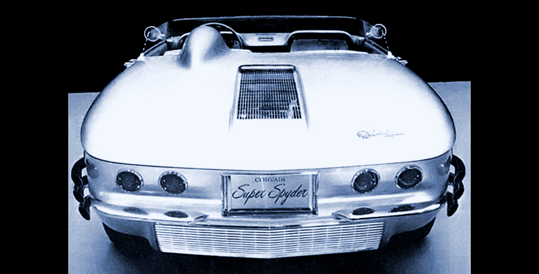

[ MidVair-014-YellowStinger_jpg ]
There's a place I've been, some nice Corvairs.
The not stock Factory Corvair, like, from, like wayback in the '60s !
Tough Corvair, RedStinger_021, stronger, faster, quicker, lighter !

The1964 Corvair Super Spyder Sport, the Astro-Hemi-Headed-Twin-Turbo-Trans-Am Factory entry !
Working on a Corvair transaxle design in aluminum, for mid-engine placement, ( factory internals, modified for limited slip, 4-spider, flopped ring and pinion. )
Ambitious Cloud -9 drawings, doing what we, like, dreamed of doing in, like, '67, like.
