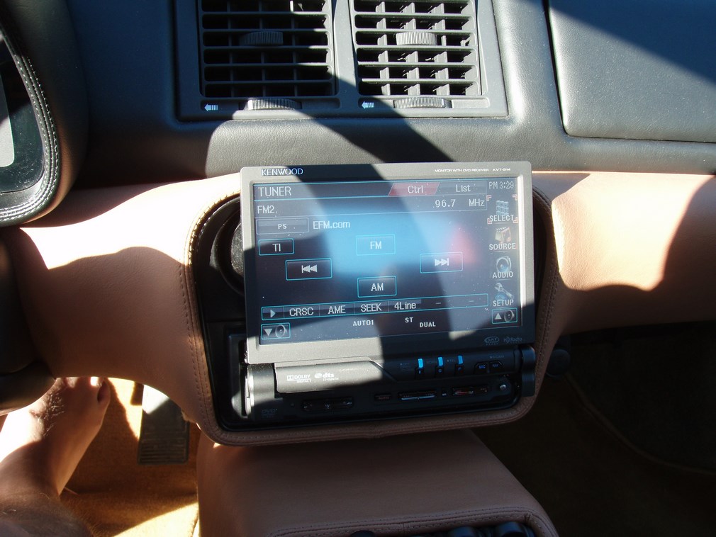

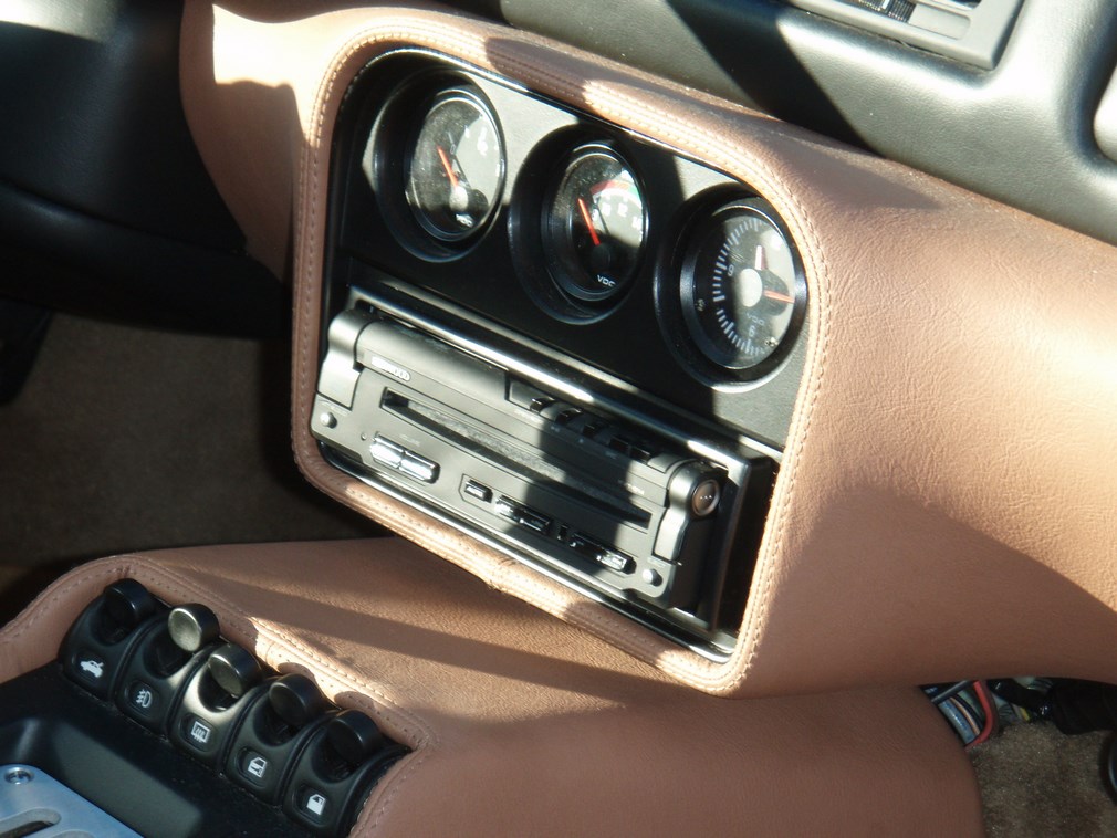

I used a single DIN unit with a pop out 7" screen and an adapter to fit it in the 1.5 DIN Fiero opening. It has an integrated NAV system and I have no issues using it even with my five speed manual transmission.
.JPG)
.JPG)
Nelson[This message has been edited by hnthomps (edited 10-25-2017).]
